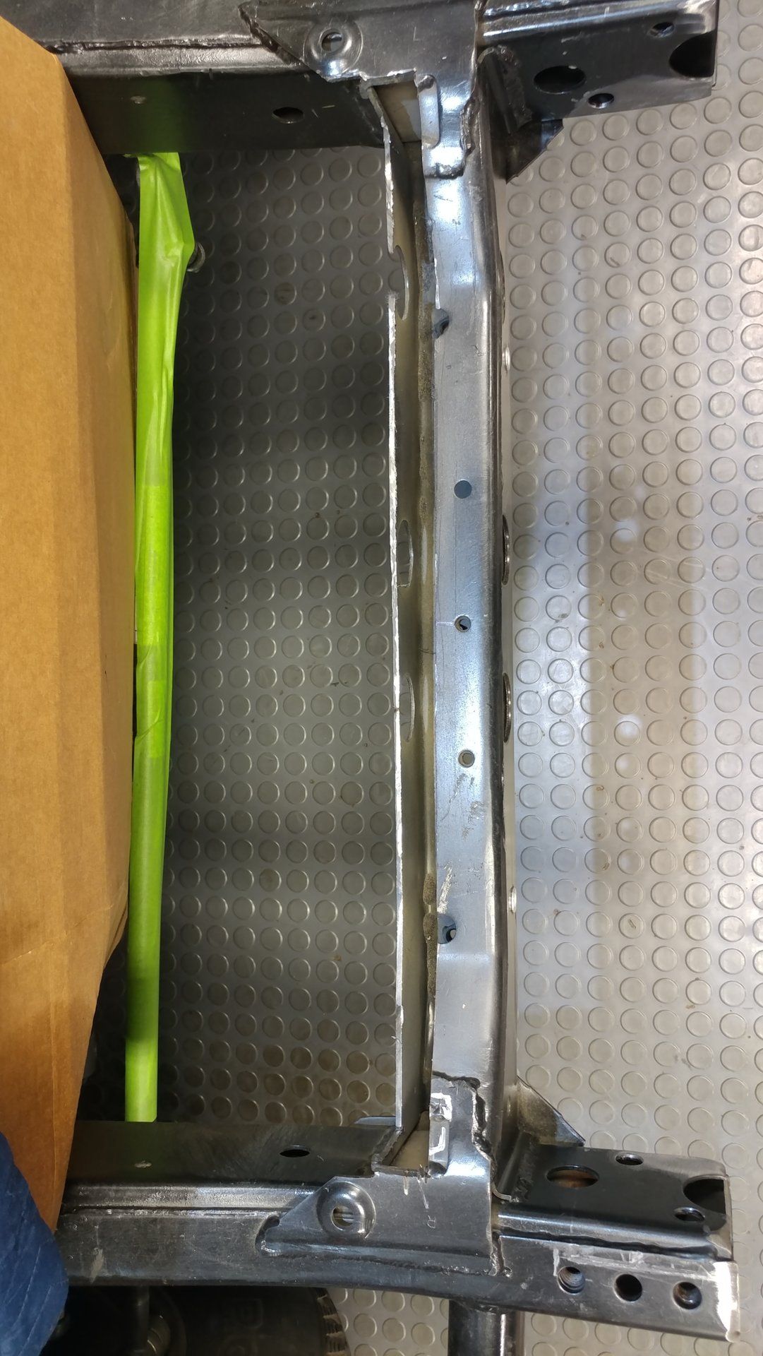

Aaaaaaaannnnnnnnd the crossmember needed to be modified...........again. Had to notch it out to clear the OEM condenser I decided I wanted to run on this truck vs the aftermarket on #1. Should have never put the 80 crossmember in....should have gone with the tube like a 70. #3 will have a tube...

Finished our mod to the crossmember for the condenser yesterday.....she fits right in. Radiator should clear just fine('should' being the key word). I think we determined that we wanted to space the radiator back just a tad but that's easy with shims. Had to order some additional rubber mounts which came in so I can get going on checking that.

I can't quite figure this one out either....none of these brackets for the condenser are available....I've looked them up for all kinds of models and they just say, "discontinued". Fortunately I know some very good people north of the border that source stuff like this. Condenser came with the 2 upper inner ones but that was it. Really perplexed over it. I'm guessing it's something that I'm not looking up correctly but I'd like to think I'm pretty good at looking up and buying parts....my bank account agrees.
seems like a monster condenser?
For sure it's big. I think the pics make it look a lot taller though.
The one on the #1 truck is an aftermarket unit....what we use on our 40 builds. I sized it to fit above the crossmember. AC works fine in that truck. Would have been fine for this truck too. I was trying to be smart and just buy the new part vs. modifying all the other stuff like we normally do. Didn't work out that way. Ha. Bought the expensive part AND had to mod stuff.

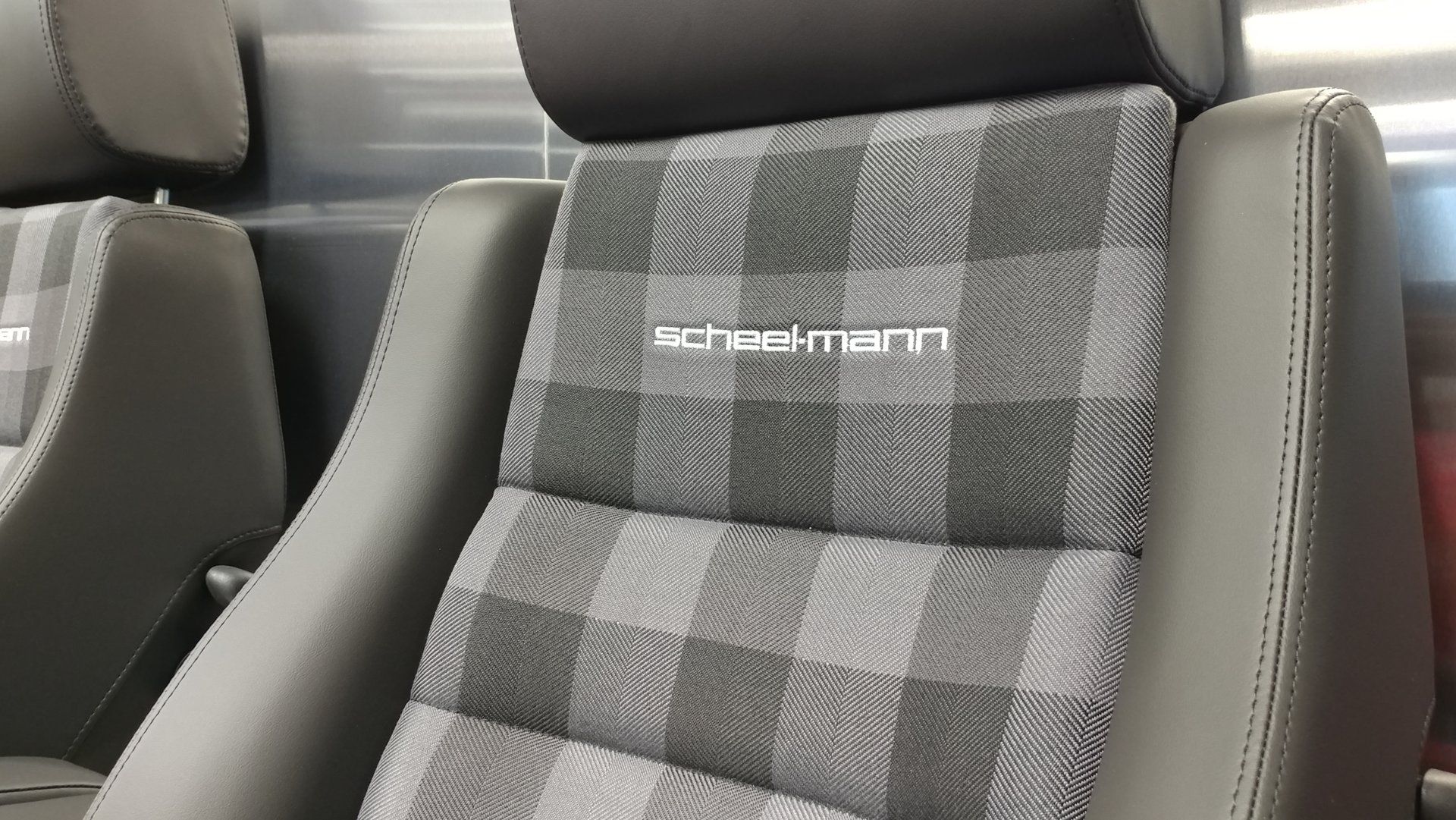

These aren't for my truck but damn they're nice. Put them in my right hand's F250 today.....what a cool setup. These are MB Rodeo inserts with black leatherette bolsters. Vario F seat with single armrests.
Maybe brown plaid with brown leatherette will be in the future for the next build....
Those look awesome Chris! Making me second guess my decision... 😁
I know, I know....trust me....I've been second guessing my choice too. Lol. They're gorgeous. They look killer in the F250...kind of a dark grey interior.
Sure would look good in my Troopy......too bad the budget is blown on that truck.
Looks familiar. I remember we had an issue with brackets as well, but honestly can't recall what it was.
Ah....cool pic. Very strange with the brackets....especially if you guys had the same issue. Would be a pisser if the front got damaged and someone needed brackets.
