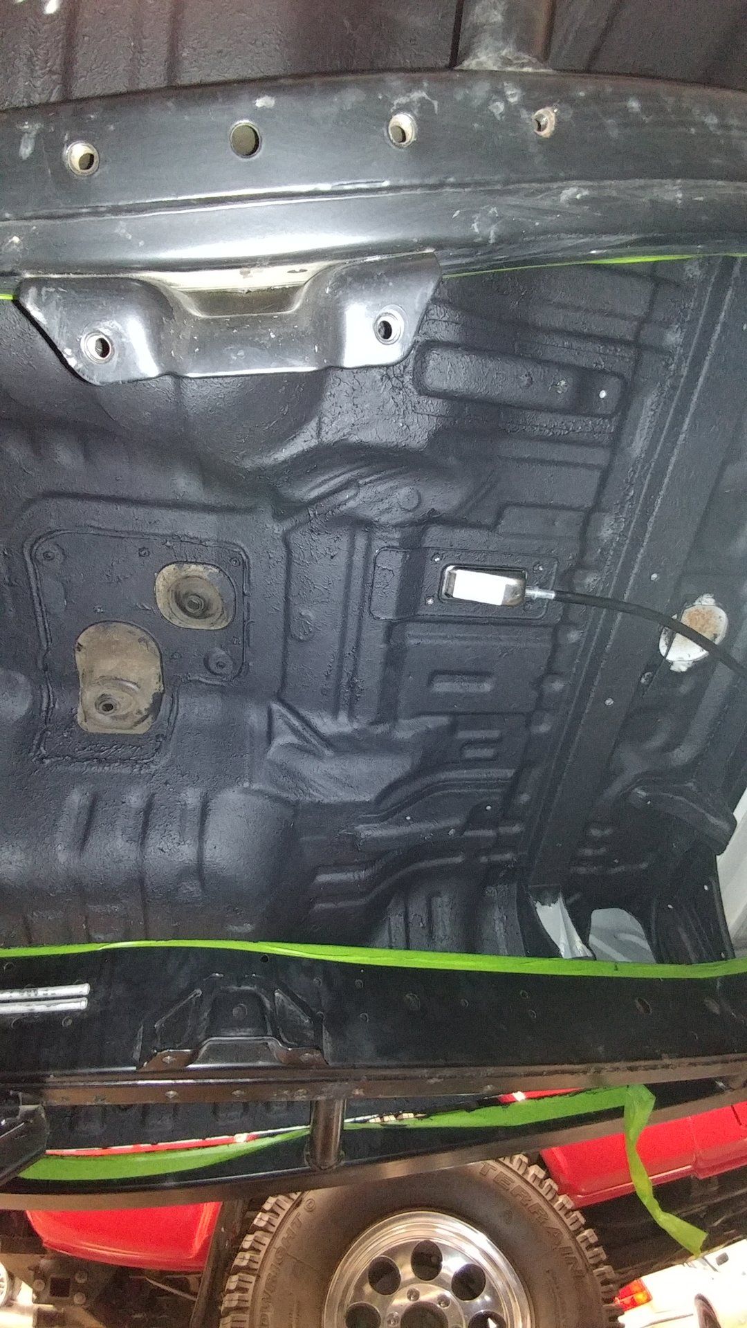

Used our Second Skin Audio Spectrum Sludge on the underside of the cab. Gave it a wipe down and put the stuff on. Sludge is a thickened version(you add in the thickener)....it stays put, even on a overhead surface. We did 2 coats.....used a brush. I was going to spray it but I wanted to try it this way. Easier and less mess. With this on the bottom, the other stuff on the top.....the floor feels like it is made out of 3/8" steel. Really happy with it.

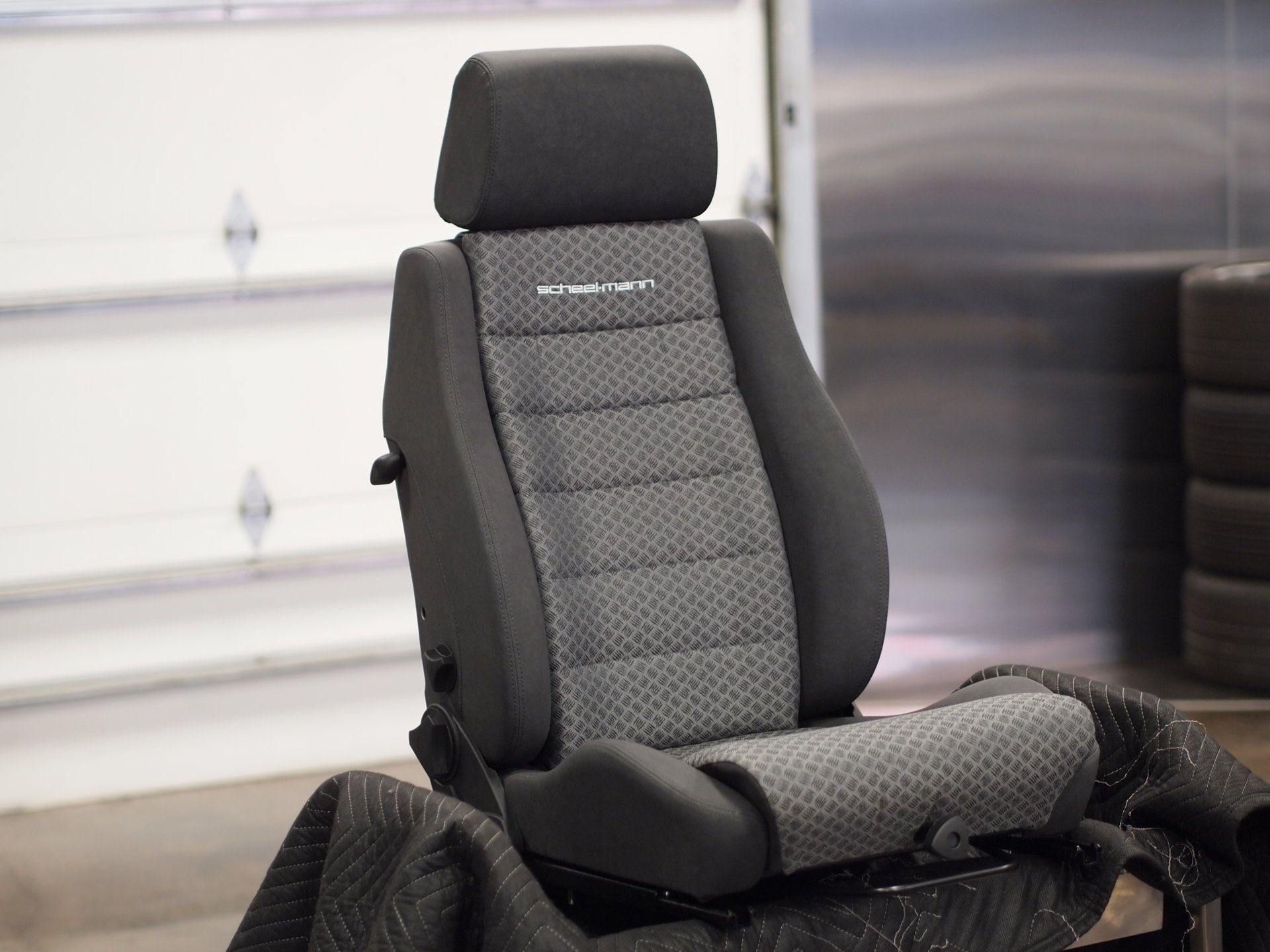

We've installed 100s of seats over the years in all kinds of cars from all kinds of manufacturers. This Scheel-Mann seat is one of, if not the nicest, seat we have done. Just a top notch seat all the way around. Very excited about this.
I went with the grey 5 bar insert and the grey anthracite leatherette for the bolsters...I felt it matched the grey of the interior the best. This is the Vario F model. Lower seat bolster height for easier in and out. 10 way adjustable. Optional heater elements.

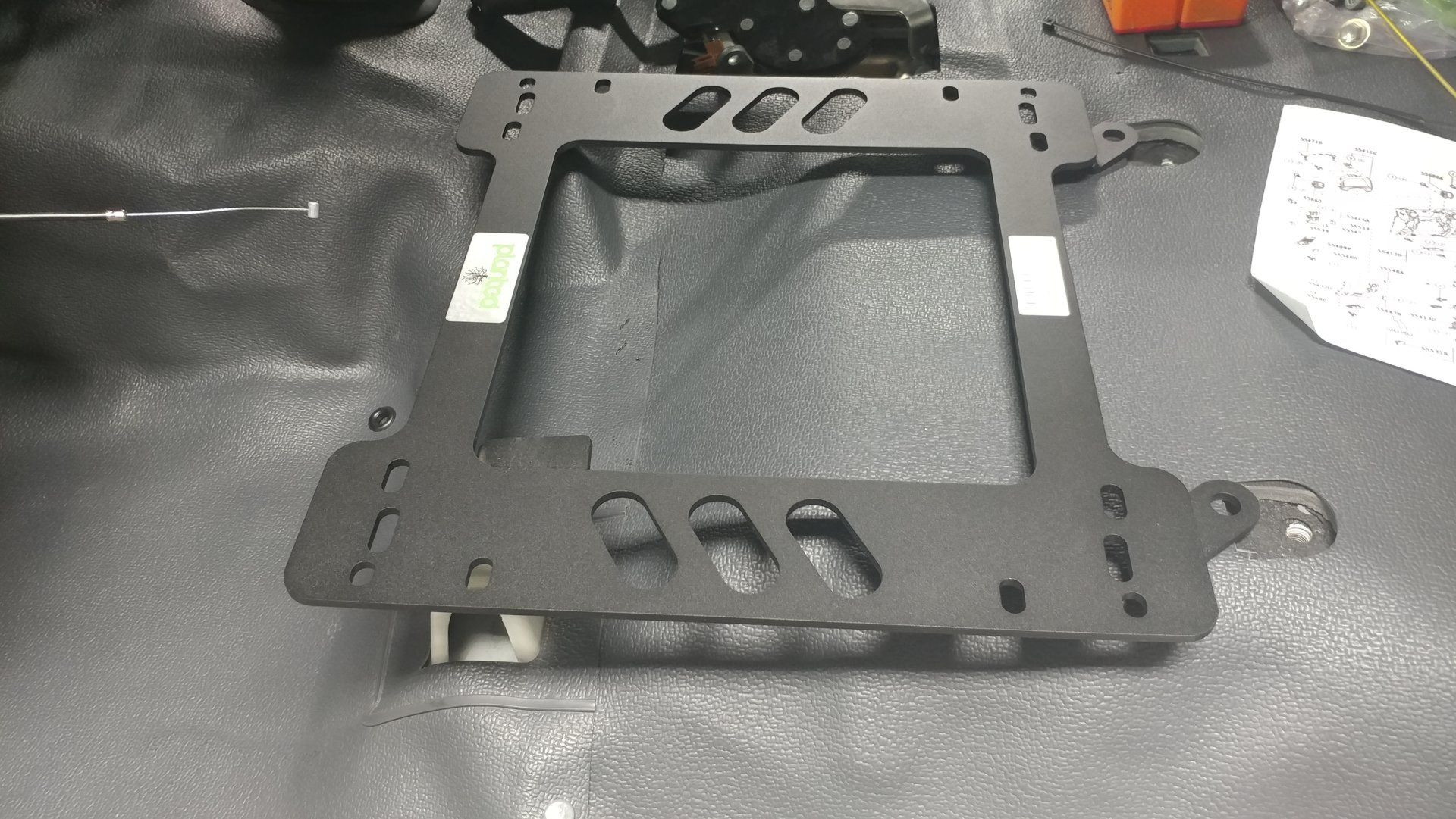

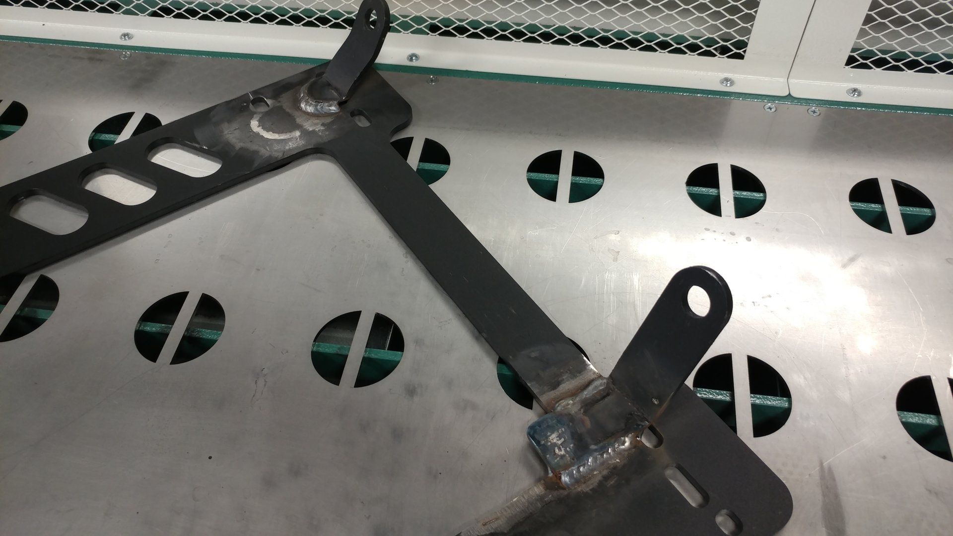

I knew the Planted brackets that I bought most likely weren't going to work on the 79 floor.....and they didn't but they were easily modified and now they work perfect. We cut off the forward mounts, moved them forward and burned them in. Easy.
And here she is.....perfect fit, just like the OEM seat with regards to height, width, etc.
Very very happy with these and the material I went with looks perfect.....kind of OEM actually which was super important to me. I'm very particular with aftermarket seats not looking aftermarket in our projects....we end up recovering a lot of them in OEM materials. Not necessary with these.

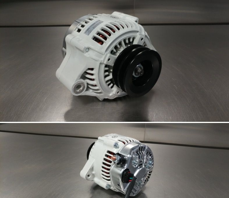

And a big thanks to Rob at Odd Iron Off Road for getting me this Terrain Tamer 1HZ alternator. I've seen a lot of alternators and this thing is one of the nicest. Too nice. 😂
