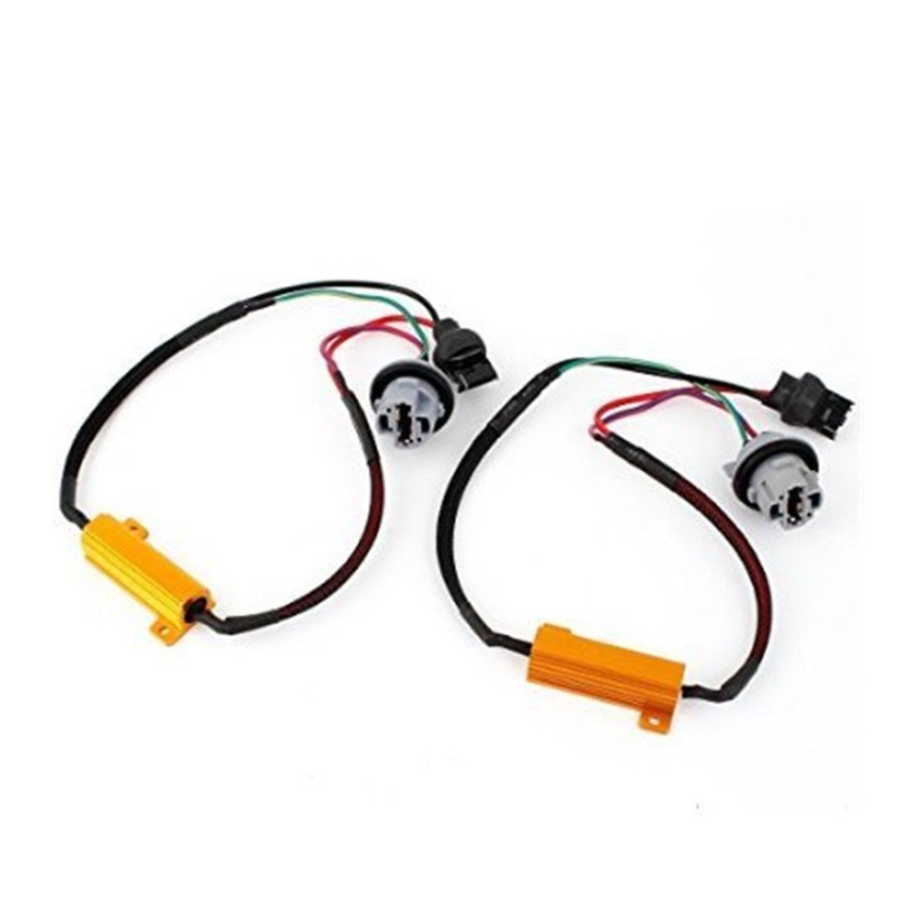

am have been changed the OEM signal bulb to the LED like image below
now am have a problem its work but very fast, when i make search about this problem i found solution should install " LED Load Resistors for LED Turn Signal Lights " .
How do I know if it fit with my Toyota Land Cruiser 2007 !? or any suggestion .
:hmm:
Some people use load resistors and some people use a new flasher relay that's designed for LED lights. I will see if I can find a link to the new flasher relay that works in our vehicles for you.
If that load resistor that you posted the picture of has the correct bulb ends on it, then it should work fine. But keep in mind those resistors get very HOT so don't mount them touching any plastic or any wiring.
