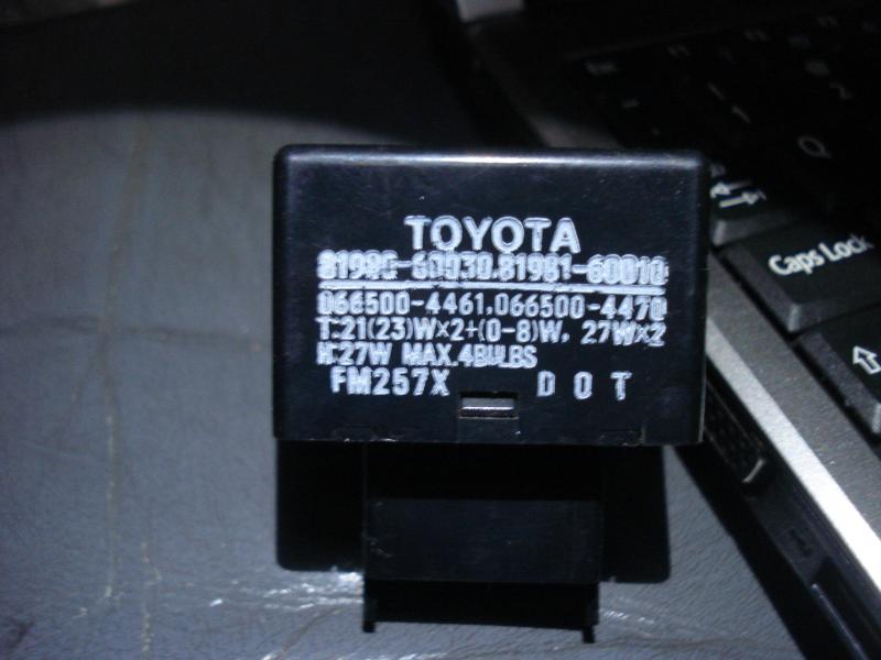

I found it! ...AND took it off.

The flasher relay is not quite behind the gauge cluster, but just below it. I had to take off the panel below the steering wheel to gain enough access to remove the flasher from it's plug. The flasher has a metal bracket that it's attached to. That bracket is screwed into a metal support (gold screw in pic). You can see the flasher plug to the left of the metal support.
Took me about an hour altogether.
Next step, buy new flasher for LEDs as well as LEDs themselves.
Banged and scraped knuckles guaranteed.
K, swapped it. Really easy if you don't have a sliced open thumb(learned my skis are ready for CO the other day, waxing and sharpening before storage is smart). Anyways, one extra long philips #2 driver is all you need. Unbolt/screw it and pull down. Don't have to worry about reinstalling it either, the oem bracket doesn't fit in the chinese one anyways. Just ziptie the harness up out of the way. Tested it by pulling a bulb, still flashes at steady rate. Now it's time to get creative!
Oh I guess I should mention, I inserted the long driver between the steering column and the kick panel...just enough room :D No need to remove anything (except the flasher).
