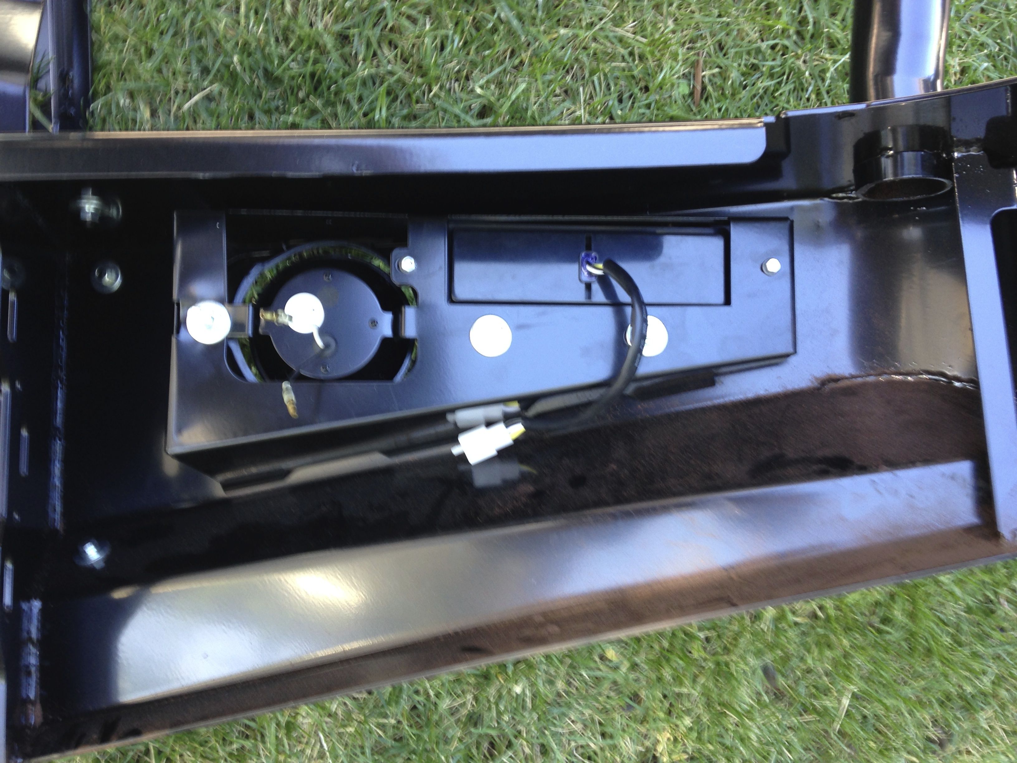

I know there's been numerous threads on LED conversions, but I can't find what flasher is being used (part #) and where it was purchased? Anyone help me out? My new Ironman bumper has LED driving lights and turn signals and the turn signals blink very quickly.
No. I put the Ironman front bumper on, including the provided LED "driving light" and turn signal in the bumper. Both are LED. I wired those using the included wires, by tapping into the turn signal and side marker light harnesses. Now, both the OEM signals and side marker lights as well as the Ironman driving and signal work as expected.

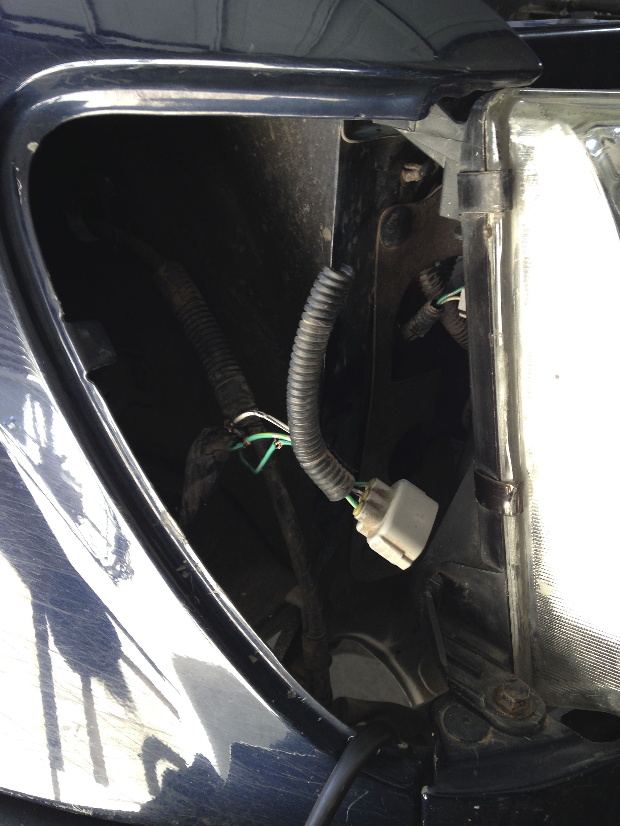

I think the issue is that you're using the wiring to the lights on your OEM bumper rather than the wiring for the side marker lights.
You want to tap into the wiring that powers this light...that I'm calling signal/side marker...
The wires you're after should look something like this (should be the same on the LX, not 100% sure)...

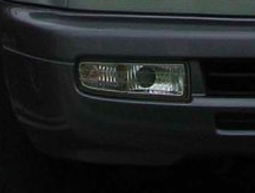

As opposed to the wiring that goes to these:
Connect the three wires behind your signal/side marker to the Ironman lights on the right in the picture below. Should be yellow, white, black, IIRC. Not the fog light.
In this way, you're not removing any of the OEM bulbs, so there should be enough resistance in the circuit so that the flasher doesn't think the bulb is out...which would cause the quick flashing.
