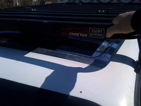

OK, starting point, I've done the "search" and not found exactly what I think might be causing my issue, hoping someone has experienced something similar...I HATE a leaking car.
I have attached a few images of where my leaks are coming in...I have my headliner out (not hard but not super quick...but makes a lot of things convenient). I have tried to silicone the bottoms of these screws where water is entering (see images) but no luck. Mind you, it's not raining here...just a VERY little bit of snow that was on my roof melted (trace amounts) and when I got in the truck the water was seeping in and dripping in on me.
I've seen the plastic pieces (show on the exterior image...I borrowed that image from someone on here as it was dark outside and that image was readily available...hope you don't mind!) and I don't believe mine are warped enough to create and issue...I think even new ones don't exactly sit flat.
The one with the screw circled on the right in the picture is the one that holds down the sorta L-shaped plastic ramp and is in the front corner of the opening. This piece of plastic should indeed not "exactly sit flat." If it does, then maybe it's broke or overtightened from what I remember of that thread, because it's supposed to have a ramp effect to help seal things up correctly at that location.

Two causes of this:
1. The sunroof seal is letting too much water in and the drains(even clean) cant keep up with the water and it fills up the area around the roof and flows over into the sunroof track(my case).
2. The drains are not clear and its causing the sunroof tray to fill with water and allowing it to into the sunroof track.

Just beat my leak fully today. I had to replace the entire sunroof assembly as it was beyond repair and the glass that came with the used one I bought had a bad gasket on the glass. I used my original glass as the gasket was slightly better and did the 26" bicycle tire tube fix. Ran a #$%^ load of h20 on top of it and it is sealed up tight as can be. I cut the bicycle tube to about 1/2" wide, ran it between the glass and the original gasket and then used an exacto knife to trim the excess. One tip, do not double up bicycle tube. the glass will not fit back in. I originally folded over the excess width of tube into the space and it made it WAY to big. One layer of tube in there is just right. Or you can buy new glass with a nice pretty new gasket that will take care of your leak also. The felt on the edges of the glass just get worn away over the years. Nothing you can really do about it but replace the glass every 7 or so years.
If I'm repeating somebody, my apologies. Mine leaked like crazy but now Im dry as a bone.
1. Clean drain tubes (compressed air, pipe cleaner, long zip tie etc..)
2. Calk the forward track cover that would overflow to cab (cover as show in first post)
3. Remove glass, very easy 4 bold under plastic trim (glass is shimmed, don't loose them)
4. The imbedded gasket (this gasket can't be replaced, must buy new glass and it's $$$$$) is "U" shaped, simply put a light gauge double wire in the "U" portion of the gasket. This will expand the gasket back to factory specs sealing the body to the glass allowing very little water to pass. With clean drains and seal track covers the drains can handle the little bit of water that will pass.
5. take your time putting the glass back in. the gasket in now expanded and you don't want to roll the "U" shaped rubber back and rip it.
6. Enjoy your dry cab

That is exactly what I'm saying, over time the gasket looses its spring and adding wire just gives it a bit more lift. Kinda like a boob job..... Adding the wire is not like a draw string. Its much more easy, you just feed the wire in the rubber gasket. The rubber is "U" shape with one side of the U bonded to the glass and the other side makes the seal to the metal. Over time the "U" shaped rubber looses spring and adding the wire picks it up forming a seal. This fix works great, just don't over do it with thick wire......
I heard a new sunroof glass was in the 500 dollar neighborhood.... $250 would be a good deal
The gasket wears away, literally, the felt seal just isn't there anymore on the rounded edges. I wouldn't use wire, the wire will eventually roll out from under the gasket. the bicycle tire is more work, but the rubber won't ever come out once set in. And FYI, ALL sunroofs have this issue. they have to seal and that requires a tight fit against the metal body. Eventually, all the rubbing on the body just wears it away. Any 10+ year old sunroof will start leaking. They are not lifetime parts.
I wouldn't say all sunroofs have this issue. Mine is a 96 from texas with original sunroof glass an all the rubber is still intact. Mine leaked very bad saturating the headliner, this fix work outstanding. This was not my idea, found this fix here on MUD. Guess if the rubber is gone then only a new piece of glass is the fix.
