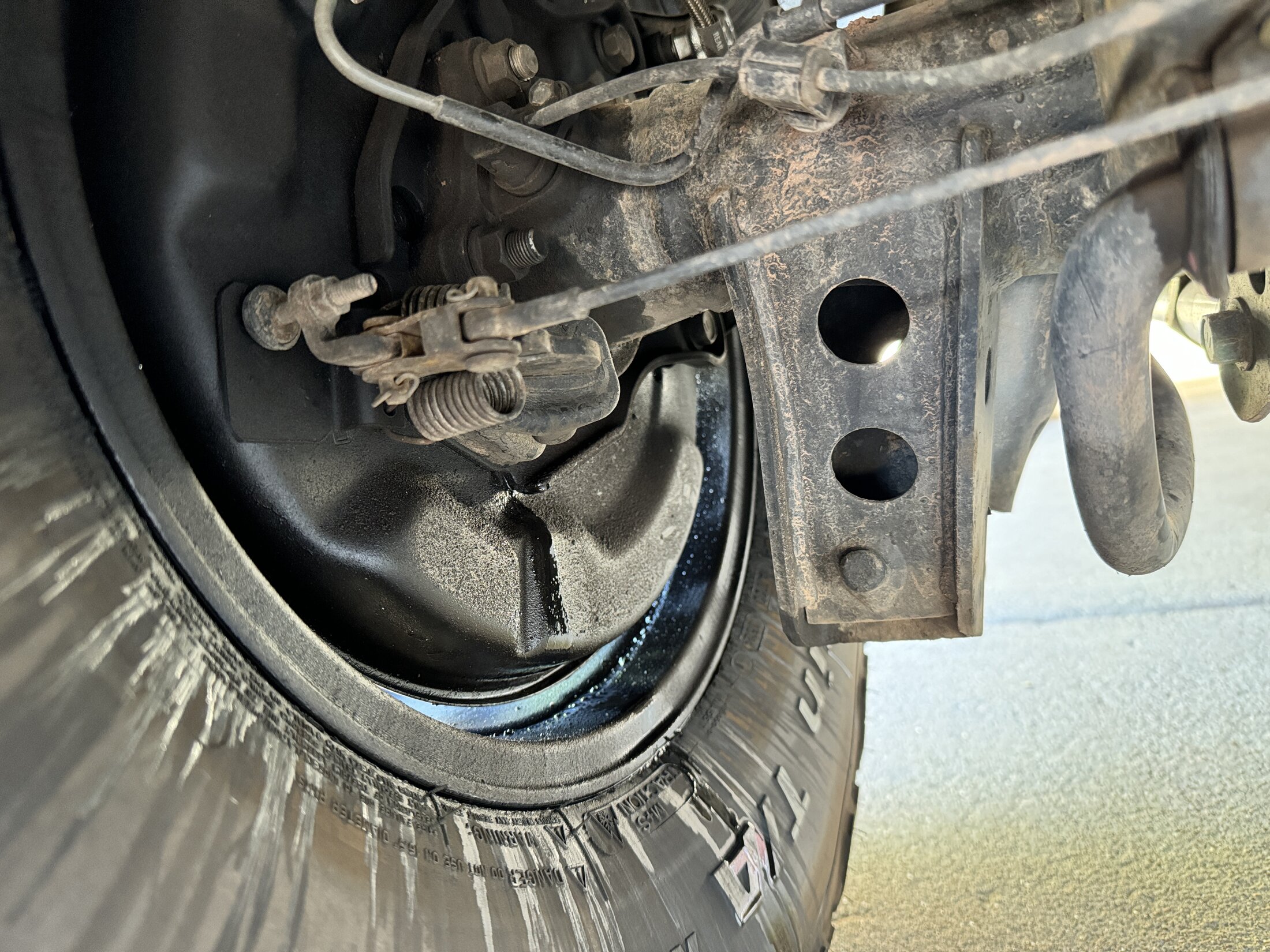

Finished a 450 mile leg today and saw smoke coming from the driver side rear wheel. Looks like gear fluid is leaking.
I’m assuming my bearing is toast and something caused diff fluid to make its way all the way out.

It’s unlikely your bearing is bad. There is a seal in the axle housing and an oring on the axle you’ll need to replace. The seal is a pita to get out and replace, but it’s doable. Buy a couple seals because the odds of bending the first one is greater than zero trying to get it seated straight.
Based on the pics, I’d guess you’ll need new parking brake shoes, as well.

Bearing is probably fine but if you're going through the pita job of replacing the seal and seal ring, might as well replace the bearing too. If it's your first time doing the job, might be a good idea buying double of everything. It's easy to screw this job up.
I just went through this and I suspect my case was unusual but long story short my lug nuts were loose and cause my seal to leak. The leak was noticed long before my wheel got some bad I broke my stud. I guess just a quick PSA to check your lugs to make sure nothing stupid like that is happening.
ended up replacing the seal but the bearing seems fine.
