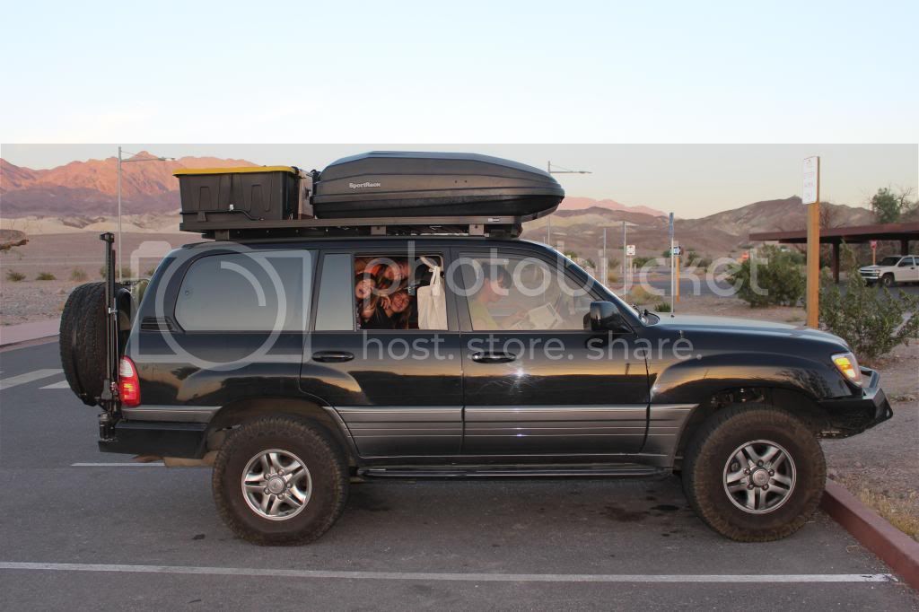

Just a quick update. I've been too busy with home improvements and the kid's soccer tournaments to do anything to the Cruiser, but did make it out to Death Valley for the first time. I didn't try anything remotely difficult, but really enjoyed the scenery. The 864's have been a huge improvement - MUCH better balance and steering feedback when loaded down.
Here's one with the family crammed in at the Furnace Creek Visitor's Center.

I just posted a thread the other day about my suspension setup. Last week was the first time we had the truck fully loaded down with a weeks worth of gear for the whole crew (me, wife, 2 kids, 90# dog) and the back was saggin' low! So I am now trying to decide if I should swap rear springs.
