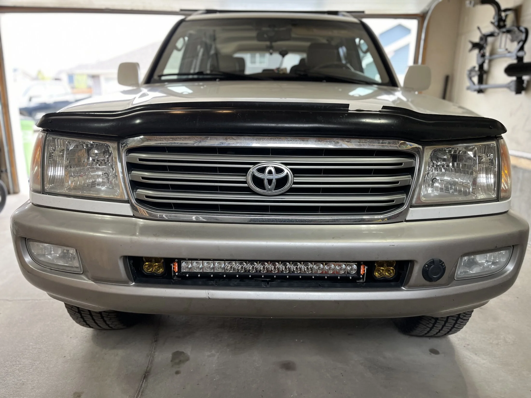

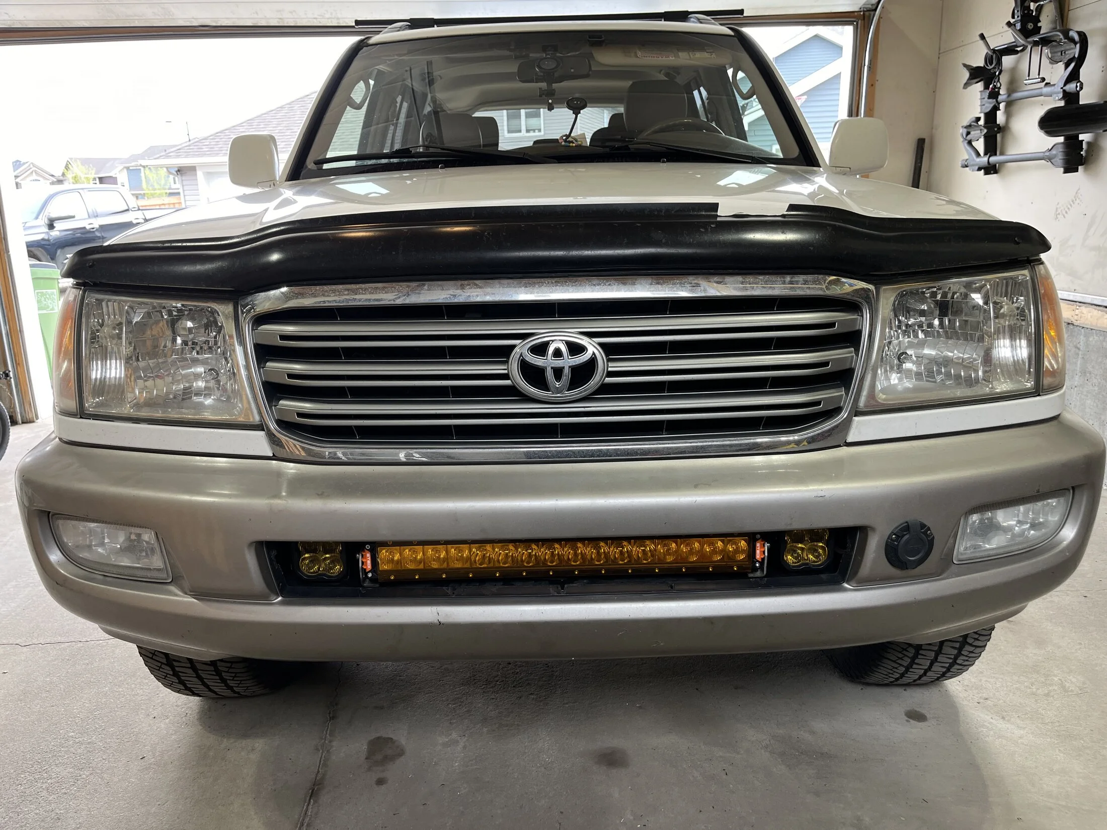

To those who wanted extra lightings with stock bumpers this is what I did on mine since my state doesn’t require front license plates. Easy installation with a bit of research here and YouTube videos. Cut the lower grill opening using multi tool. Take off the lower bumper. Measure and drill the crash bumper and install rivnut same size as your bolts. If installing a 30-32 inch light bar you wouldn’t need drilling for rivnut because there’s 2 hole on the crash bumper to insert the bolts and nuts. I needed an extra fog light so I ended up with 22” light bar to give space for pod lights on each side. This is a big improvement over stock lights.
