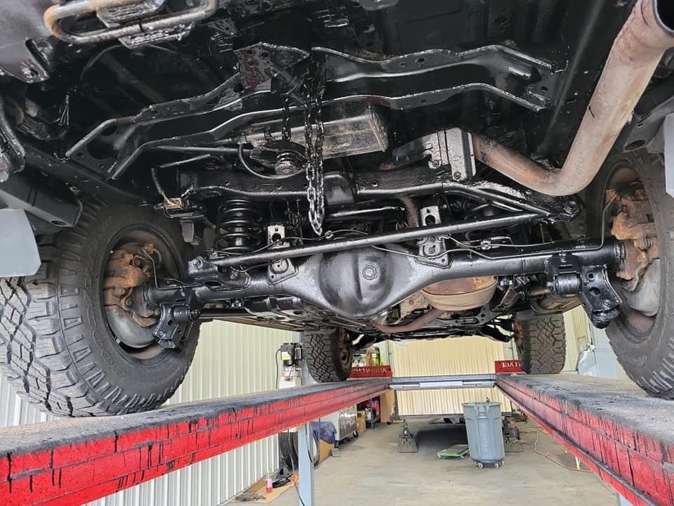

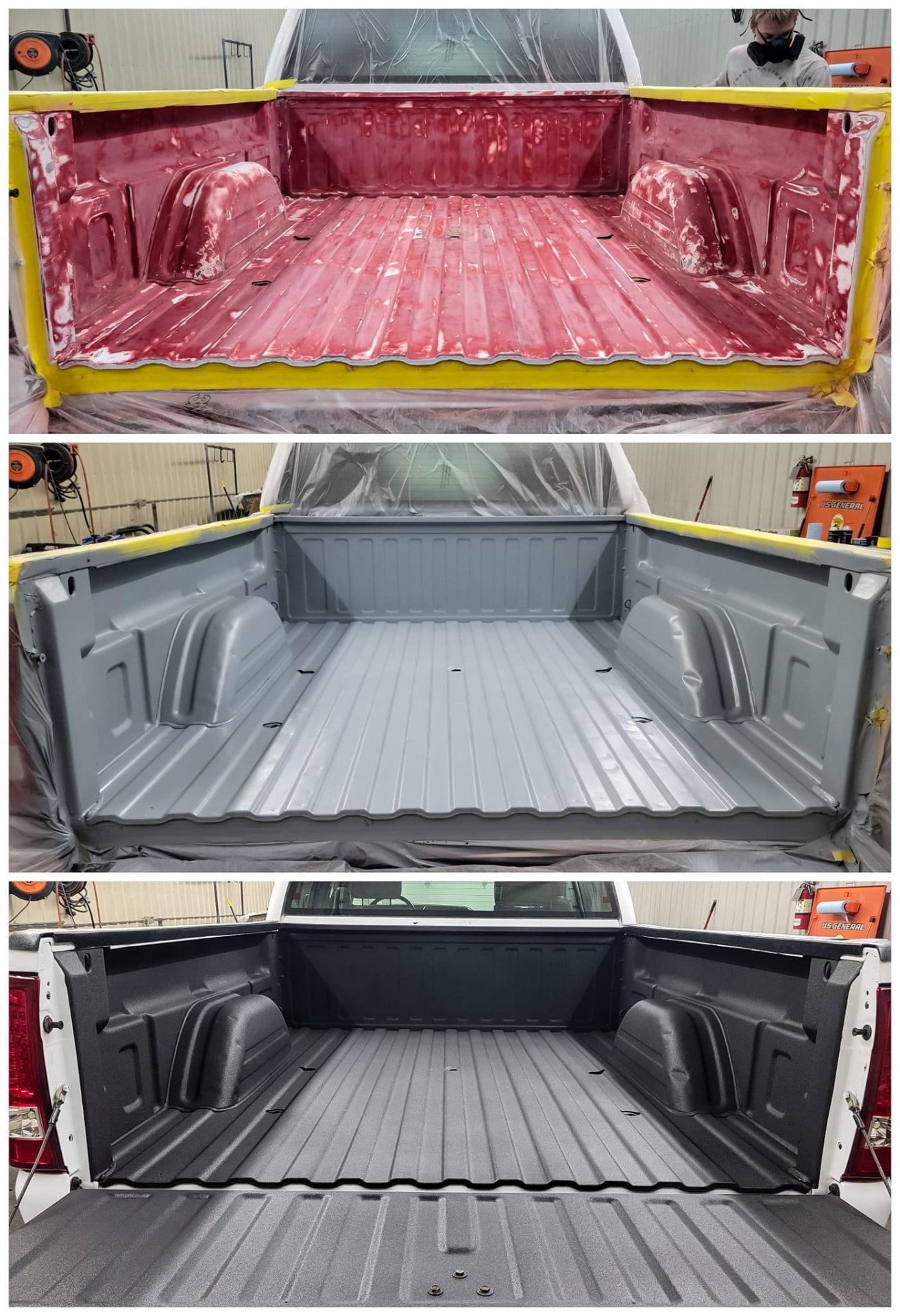

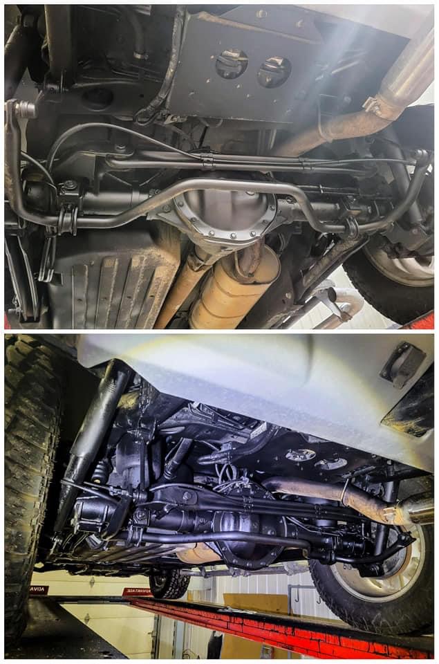

So a local shop here in Minnesota just started doing this last year. They spray the bottom of your vehicle with the same substance they do with truck beds. That Rhino lining black material.
It’s around $850 bucks for the lifetime or $600 for the 5 year spray.
Do you guys think it’s worth it and would you do it? We use a ton of salt here in Minnesota during the winters. Here are some photos of their work.
Has anyone ever done anything similar to their own vehicle?
The company is called Carson Undercoating.
DO NOT DO IT
Products that encapsulate your metal in a hard barrier are detrimental in the long run. They break down, trap water, and create overly aggressive corrosion cells that can go unmonitored.
You want to create a oxygen barrier to prevent rust from forming. WoolWax, Fluid Film etc are used for this. They’re not nearly as pretty but that are far more effective.

This is what they say they use:
Many people always ask what we use for products. We're very transparent with our customers and happily answer that question!
For products that dry, we use cosmoline rust veto 344 and cosmoline RP-342. For a product that's considered to be a "wet" undercoat, we use woolwax lanolin. None of the products we use are rubberized and never will be.
To the OP: that stuff is not usually done for truck beds as it is not meant for the wear caused by the loads. That coating will also get on the loads and stain them.
Yes, you can use it on truck beds that have no liner but it is waste of money as there are far better, specific products for truck beds.

@UnFadeable21 it looks like that vendor sprays a cosmoline variant that is tinted black (possibly with graphite?). Not a bad thing at all. Cosmoline has been used by the US military for decades and, IIRC, was developed either by or for the military. Cosmoline will arrest any rust that is present (ensure you remove any heavy flakes with a wire brush) and prevent further corrosion. I’ve used it on my 200 and around the shop on various implements - it’s good stuff. Goes on wet and dries to a waxy film that is VERY durable. The big benefit with cosmoline is that is dries and is less messy when compared to lanolin products like Woolwax - which will always be oily (wet) to the touch. The downside is cosmoline has very little, if any, creeping ability and it does not “self-heal” - it is thus not a good candidate for interior/cavity applications (inside frame rails, doors, fenders, etc.) or areas with exposure to rock chips / road debris (control arms, etc.).
Also, recommend checking out this thread for additional info on lanolin-based undercoatings (Fluid Film, Woolwax, Surface Shield, etc.). Fluid Film was also developed by the military - I think the US Navy. These products have their place and are excellent at creeping into cracks/crevices.
I recommend Repair Geek’s YouTube channel. He goes down the undercoating rabbit hole in some of his videos. BLUF - each product has its use case (lanolin, cosmoline, etc.). And whatever you do, stay away from the rubberized stuff (Ziebart); it will destroy your frame and trap moisture - as others have noted.
EDIT to add: IMO $500 is a bit steep. Around here, there are a few shops that apply Woolwax. You’re looking at $200 for a full-size SUV. Personally, I did my own application of cosmoline (CRC Rust Inhibitor), Woolwax, and Surface Shield. I spent around $300 for materials, but this was my initial “baseline” coating and I went liberal with the products.
