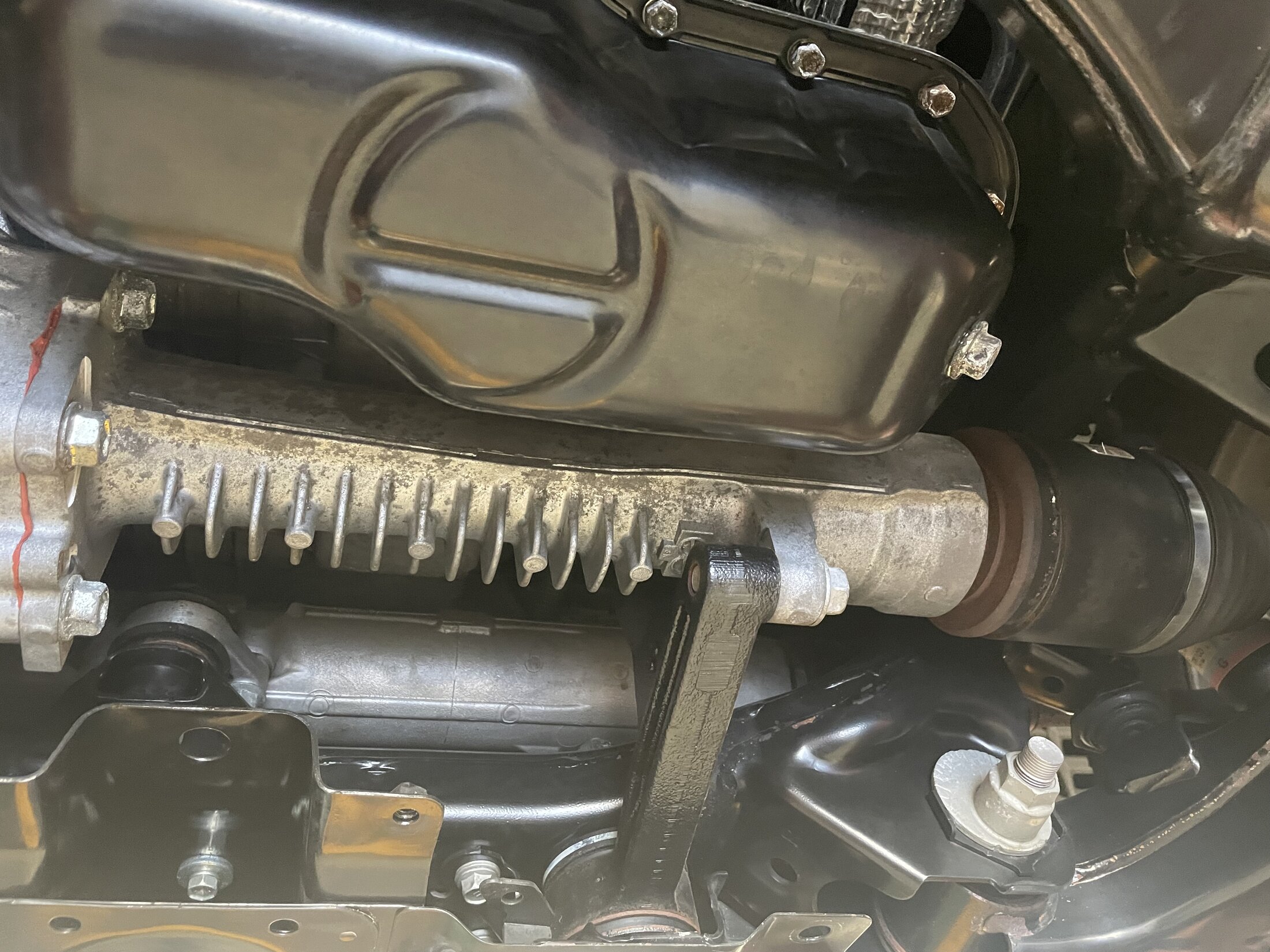

Few pics of it after dry ice. Not too bad.
Looks awesome. My exhaust has some crust that I can’t really have scraped and painted and it bugs the s*** out of me. I should have done the dry ice as well but I didn’t really know it was an option at the time and now the undercarriage is dripping in fluid film lol.
I am pretty obsessive about rust on cars but it’s gonna happen man. It’s a losing war but we still fight it.
Anything you do is going to be miles ahead of the 90% of the drivers that do exactly nothing. Pick something and rest easy.
