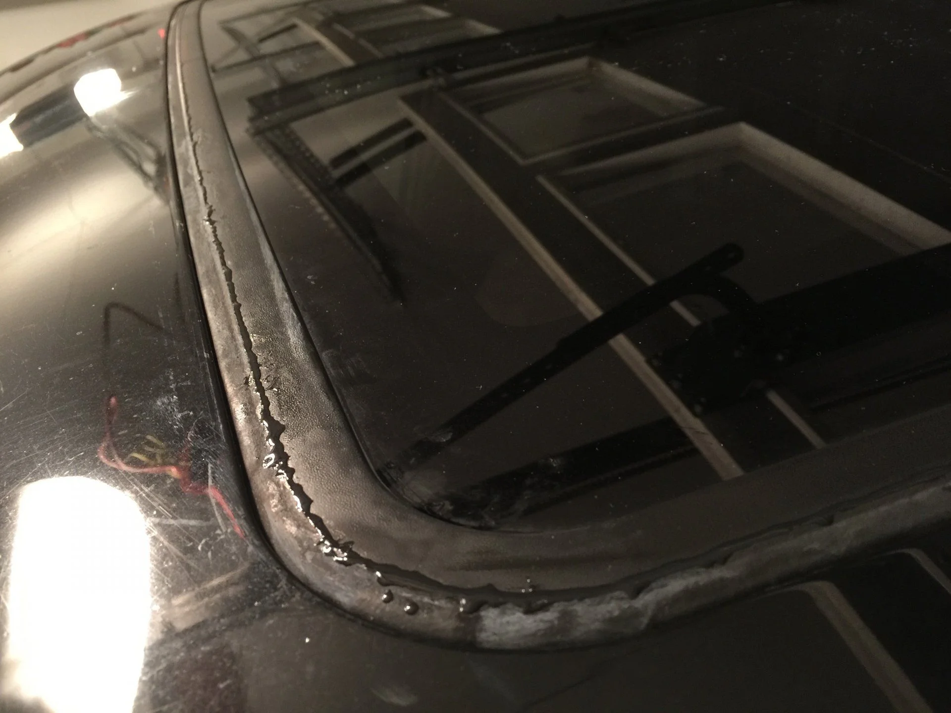

I found out that it had a leak coming from underneath the plastic and was leaking in to the driver's side cabin/headliner.

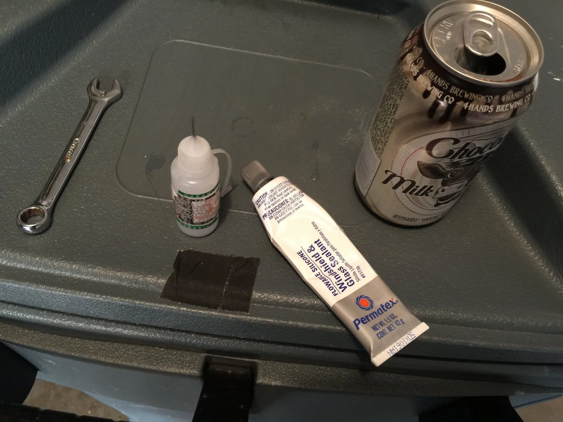

Tools needed:

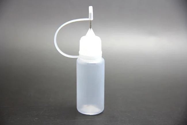

1 electronic cigarette juice container with needle
10mm wrench
1 tube flowable windshield sealer
1 pr. vice grips (optional) for squeezing bottle
Time:
2 beers
The leak:
The tools:

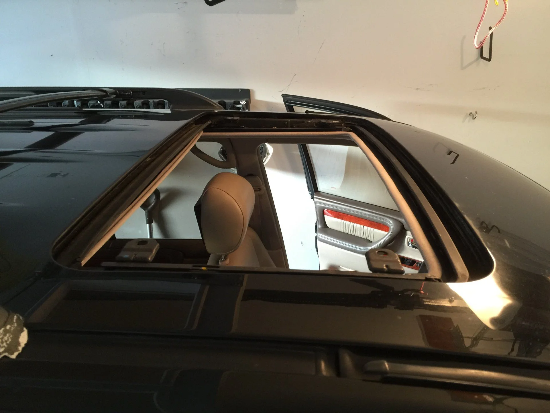

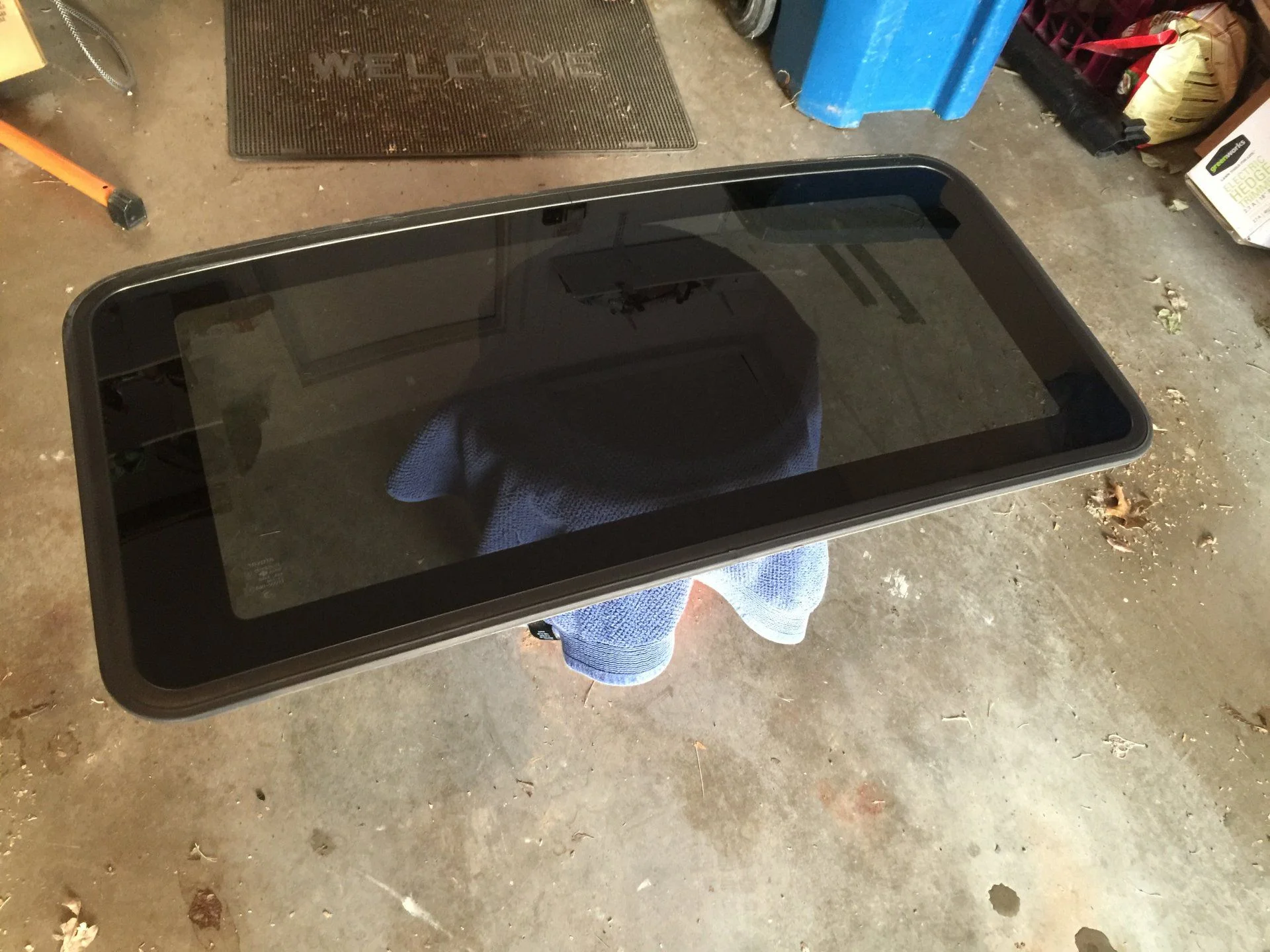

Remove sunroof plastic guards by gently pulling them. The sides have a clip that is best to roll inwards when removing.

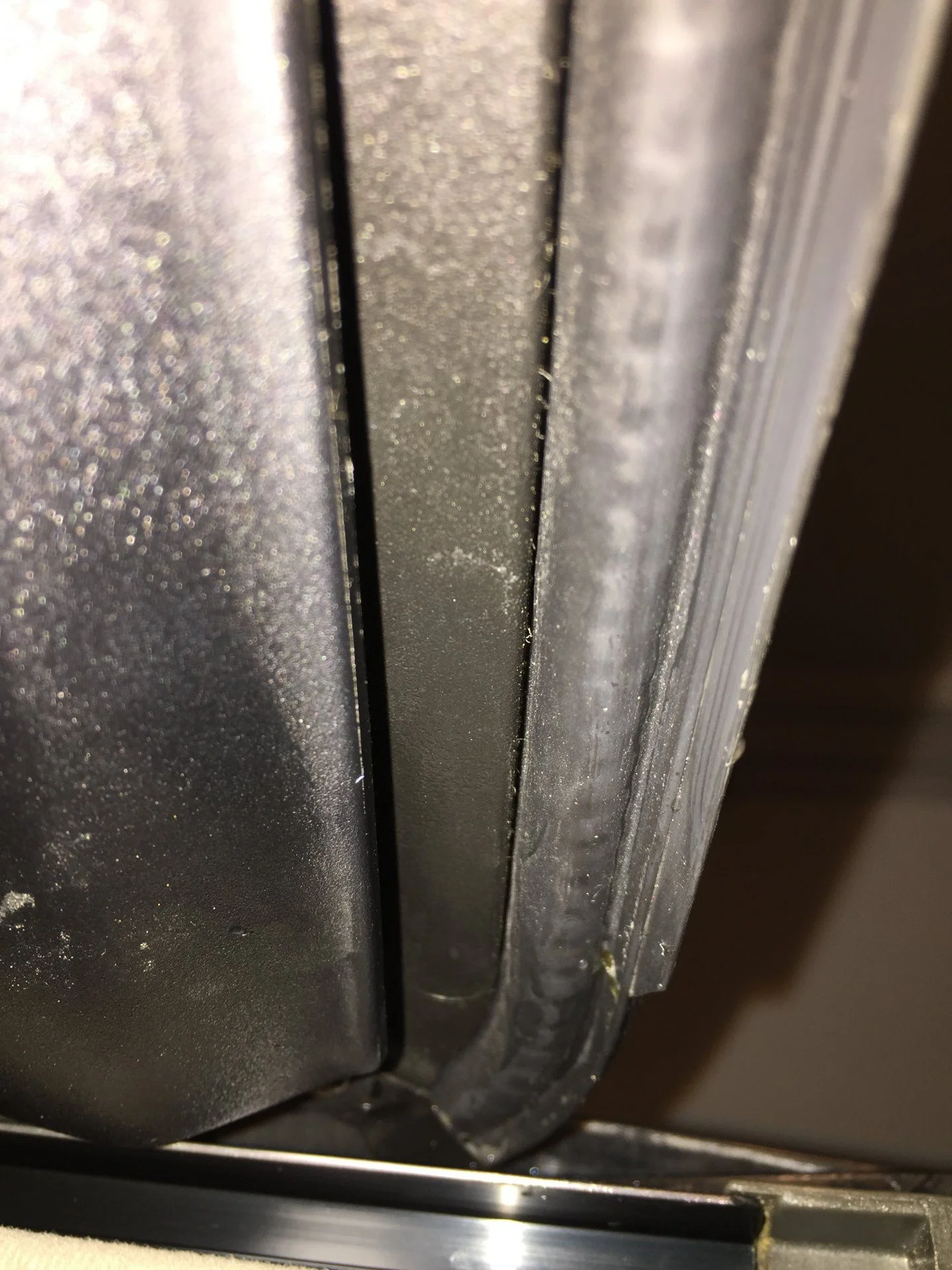

Inject silicone gently in the gap between the seal and the glass.
(Optional) Use silicone to make a small "bead" around the outside of the seal.
Remount sunroof.
