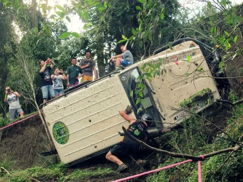

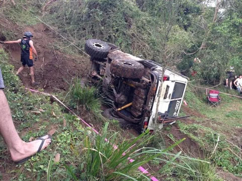

Yours looks like it could have been much worse, good thing it did not keep rolling down the hill!
Did you get oil induced hydro lock as well?

Yours looks like it could have been much worse, good thing it did not keep rolling down the hill! Did you get oil induced hydro lock as well?
Yea it was lucky when we put it Back on its wheels it didn't keep rolling down the hill
No hydro locked. I pulled the plugs out and rust proofed the bottom side of the bonnet but ;)
