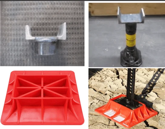

Wondering if there's variations in the stock jacks provided? Some have found the jack sufficient, lifting at just over 19" height, for even lifted/bigger tired rigs . And some find it coming up short? Can you measure how far your current jack lifts?
Other than just a larger jack (I would imagine that would be hard to find one that fits in the existing space), some key accessories may make the existing jack reach farther, add more flexibility, and safety.

Btw good idea on the Jack adapter and plate...already had the plate and I just ordered the adapter. I think I’ll stick with the stock Jack for now.

I do like Phil's jack adapter as it's compact enough to toss into the same space the bottle jack resides in.

I also realized a screw type (like ours) goes up super fast when paired with an electronic ratchet or impact wrench and o2 sensor socket....and to teckis300’s point, I do already have a plastic hilift base that gives me a bit extra height.
ipso facto, considering I already carry an electronic ratchet and impact wrench...and a hilift base..:the stock Jack is likely the ideal one to keep, especially when paired with the axle adapter listed above.

I use that same base for added height/ stability...keep forgetting to order the jack adapter. Added to the spend list...thanks for the reminder 👍

Do you happen to know if the base of the OEM jack fits within the "well" of the hi-lift jack base? If it's too large, it might be tricky to get the jack vertical and stable without slipping.
I didn’t try, but I’m 99.99% sure it’ll fit. The stock screw Jack that we have has a very small base. Much smaller than that of a hi lift that the hilift base is designed for.
another option is to use a max trax as a base if you have it.
