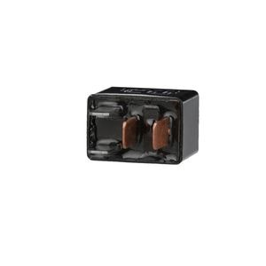

can i just pick one up at a local autozone? if so, does anyone know the part number? Best Relay - EFI Parts for Cars, Trucks & SUVs
http://www.autozone.com/engine-management/relay-efi/duralast-relay-efi/788842_0_0
IT FITS. This product is a fit for your: 2000 Toyota Truck Land Cruiser 4.7L FI DOHC 8cyl
Not sure how they figured out it fits your 2000 Toyota Truck Land Cruiser. If the relay is the same as the one they show in picture then it is not going to work because the foot print is different. See OEM foot print in post #7.
Is this toyota specific and not carried at autoparts stores?
