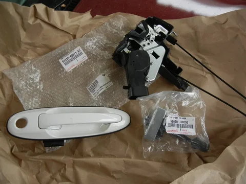

Reason: A very sloppy outer door handle. Also the door check made some noise
Parts
Driver Door Outer Handle: 69220-60071-(Color code)
Driver Door Check Assembly 68620-60050
Driver Door Latch Mechanism AISIN DLT-081

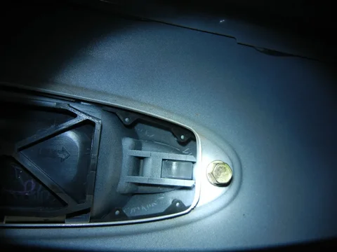

Open the bolt cover and remove bolt (2 pic)

Dislodge the tab and use a plastic screwdriver to pull the push road from door handle (Pic-2): Hint - Open the access/service hole to pass the screwdriver
