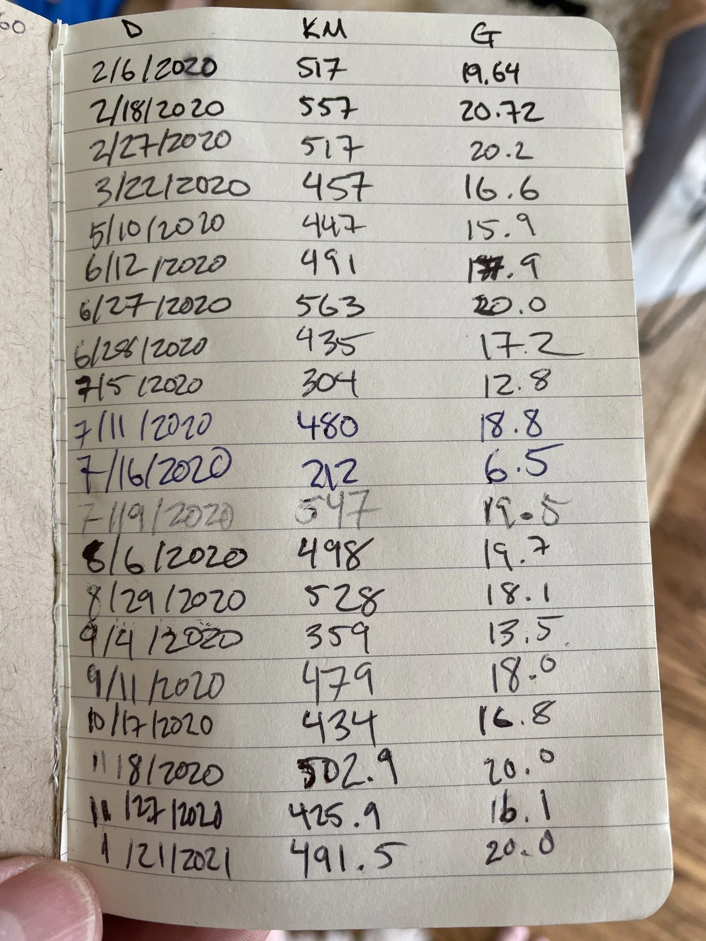

I've wondered the same, below is my tracking. On fills that were mostly in-city (or when my lead footed wife takes it out) I would land closer to 15L/100km, while all highway trips are closer to 12.
Other than driving habits, is there anything mechanically that would have a bigger impact? I haven't modified anything under the hood, but have a 2 inch lift and run 265/75r16 tires.
All my 1HZ averaged about 13.5 over a long period and ranged for 12.5 to 14.5/100, The FJ73 + 1HZ was probably the most economical , but not by much.
Tyre pressure, tyre size and lifts all contribute to fuel usage.
So your KZJ78 appears to be heavy on fuel, I have always thought they were introduced for economy reasons where the HD of the other 7* series was not needed.
