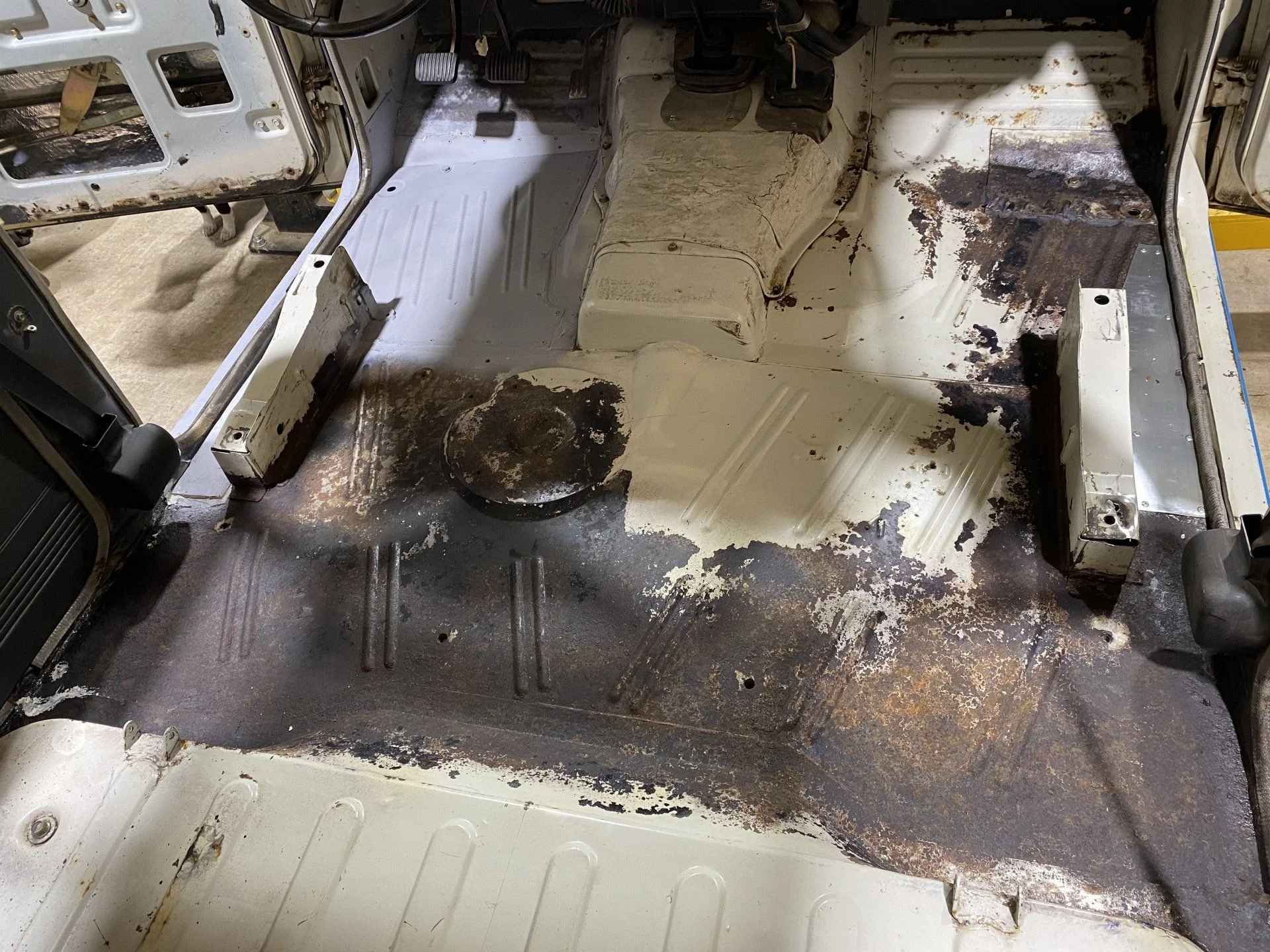

Alright. Back on the Limo this Christmas Eve.

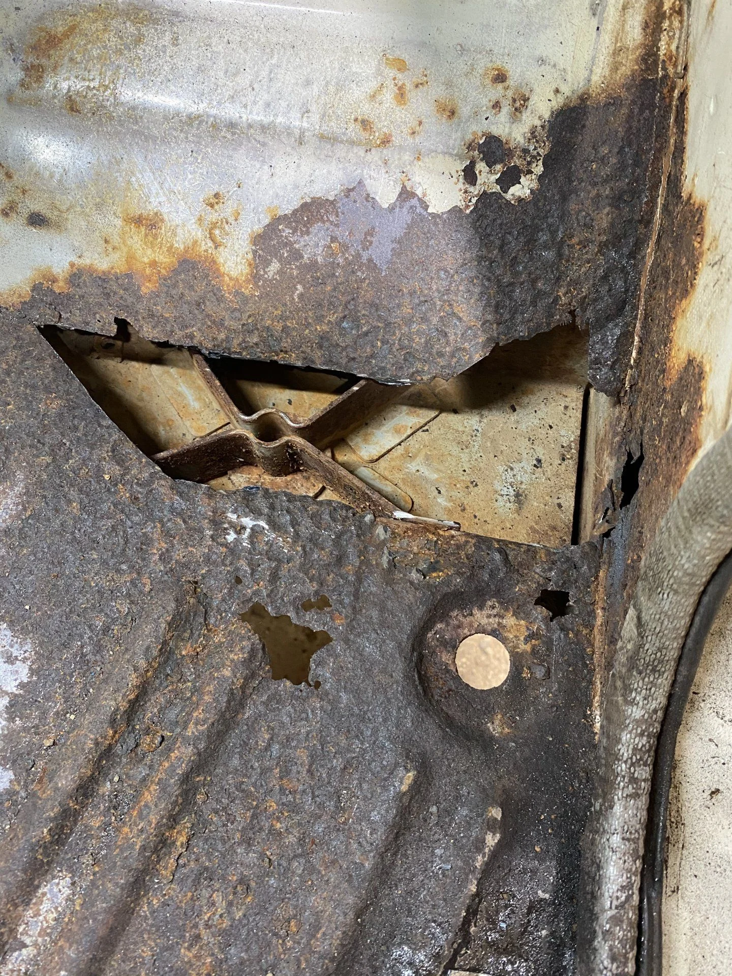

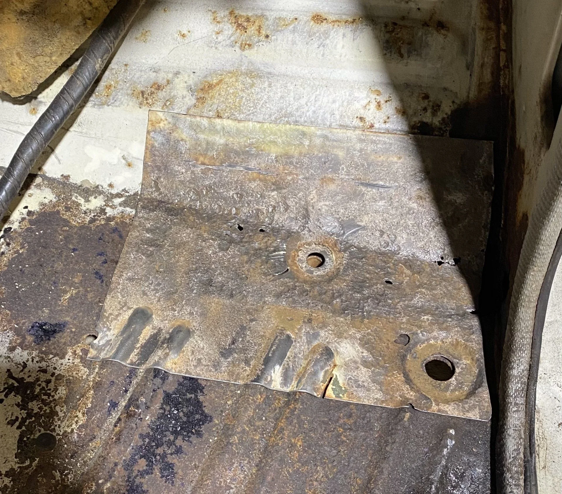

I dug into the passenger side. All the metal was heavily treated and the patch panels primed and the strip down the side of the seat got one nice patch.
Then I started digging into the passenger floor mount and found it a bit worse than I thought. Not bad enough for a full floor pan but worse than my Pig where I only needed a bit of plate steel.

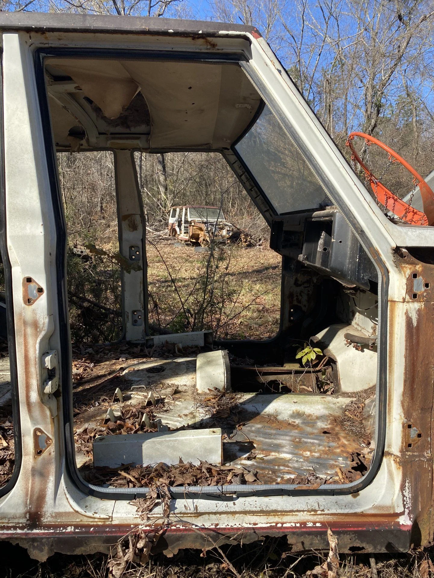

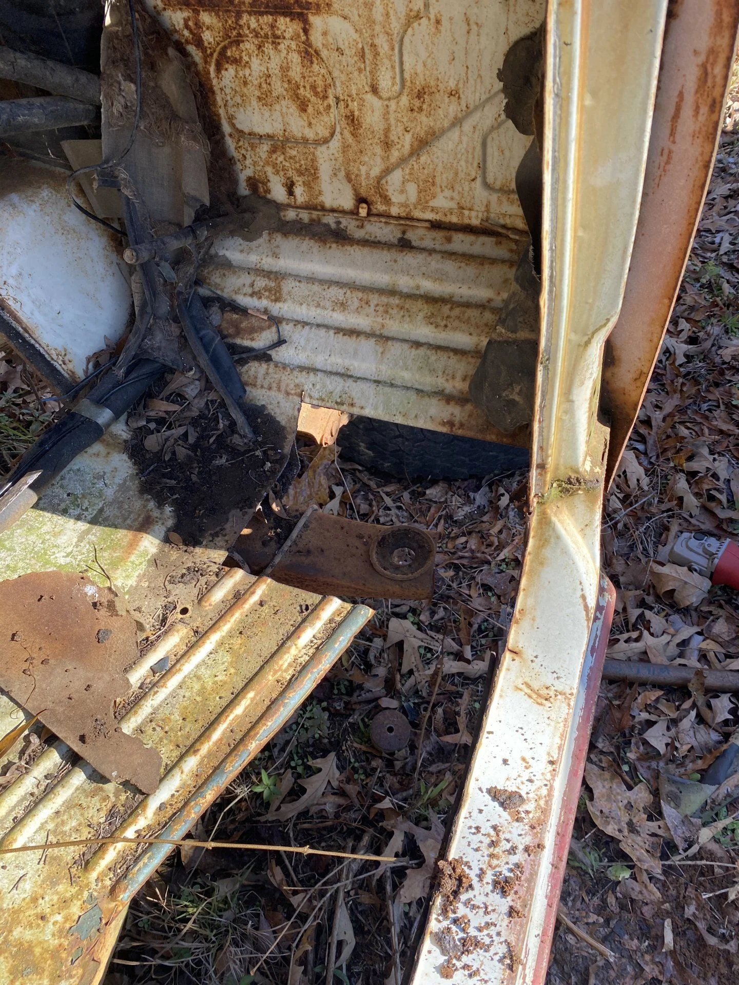

I headed back to the graveyard and holy hell. The exact piece I needed was staring right back at me. This parts pig has given so much to so many. Truly remarkable it was there and solid to boot.
I loaded up all my cordless saws and headed back. We have 30* weather with a 15-20 mph wind today and it was freaking cold but I got it

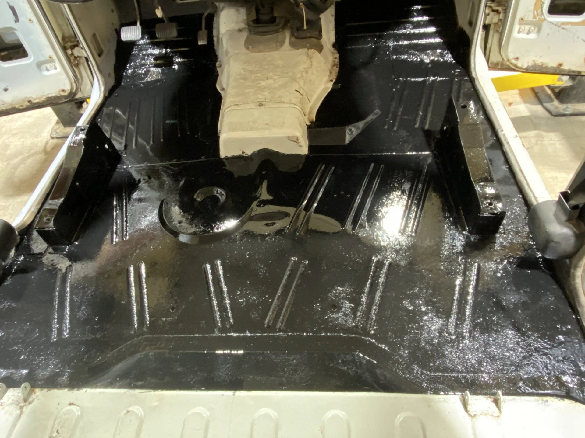

After I was happy with the fit I got it all attached. Holes plugged with JB weld and then I gave it a good cleaning before adding the first coat of POR15. I’ll have to wait till tomorrow for the second coat.
After this stuff cures I’ll add some layers of Lizard Skin and this round of “body work” will be done and I can start on striping and cleaning suspension and axles during the next phase. Pretty pumped how it’s working out.

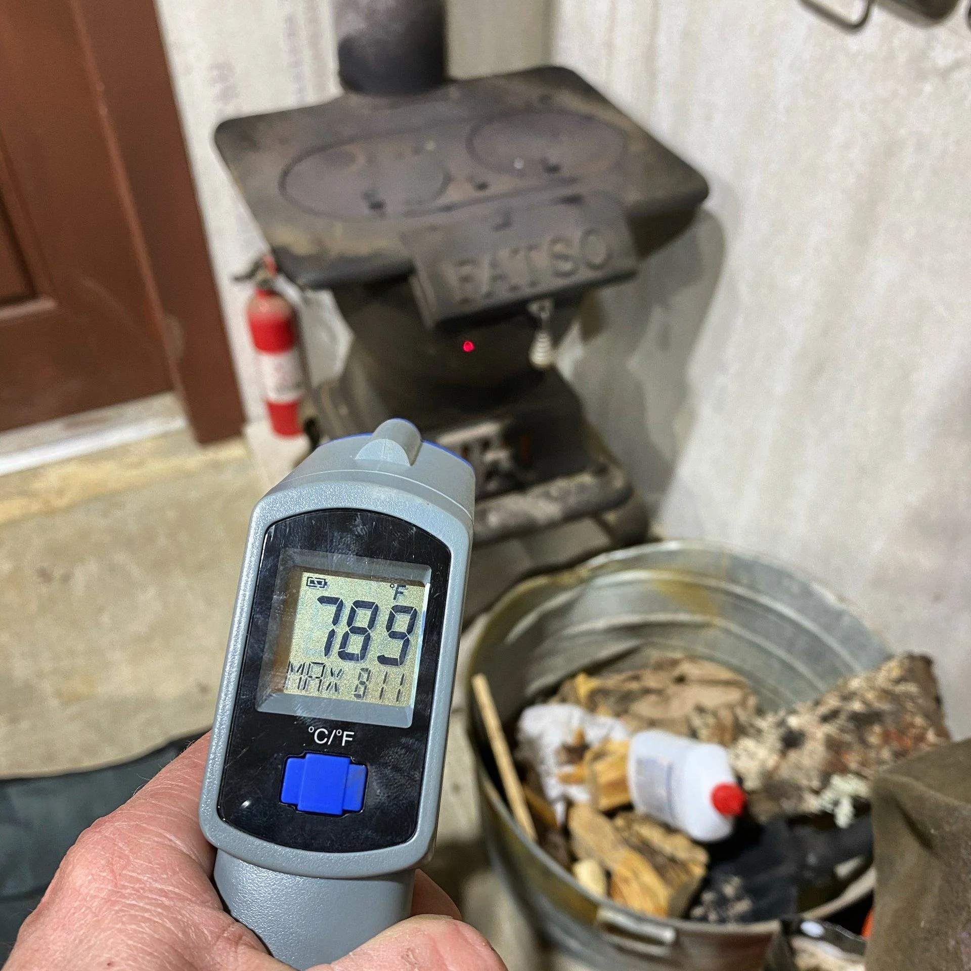

Poked around a bit on the Limo this afternoon. The Fatso kept the temperature in the mid 60s with the continued brutal winds outside

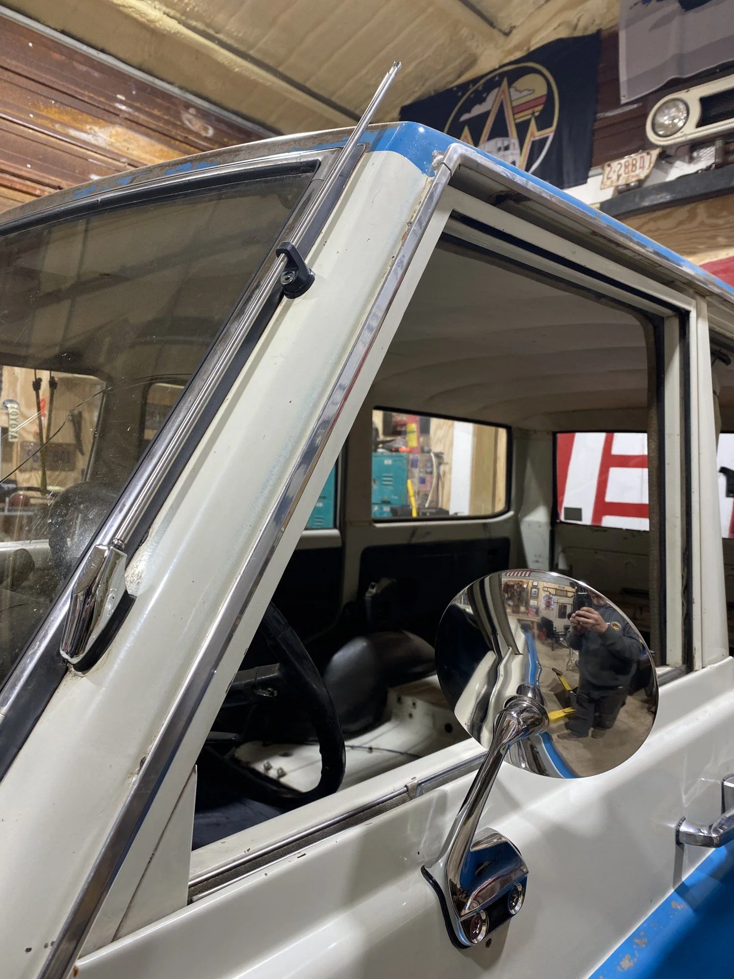

Added a fender badge where one was missing
Dug the old antenna out. It was more stubborn than it should be

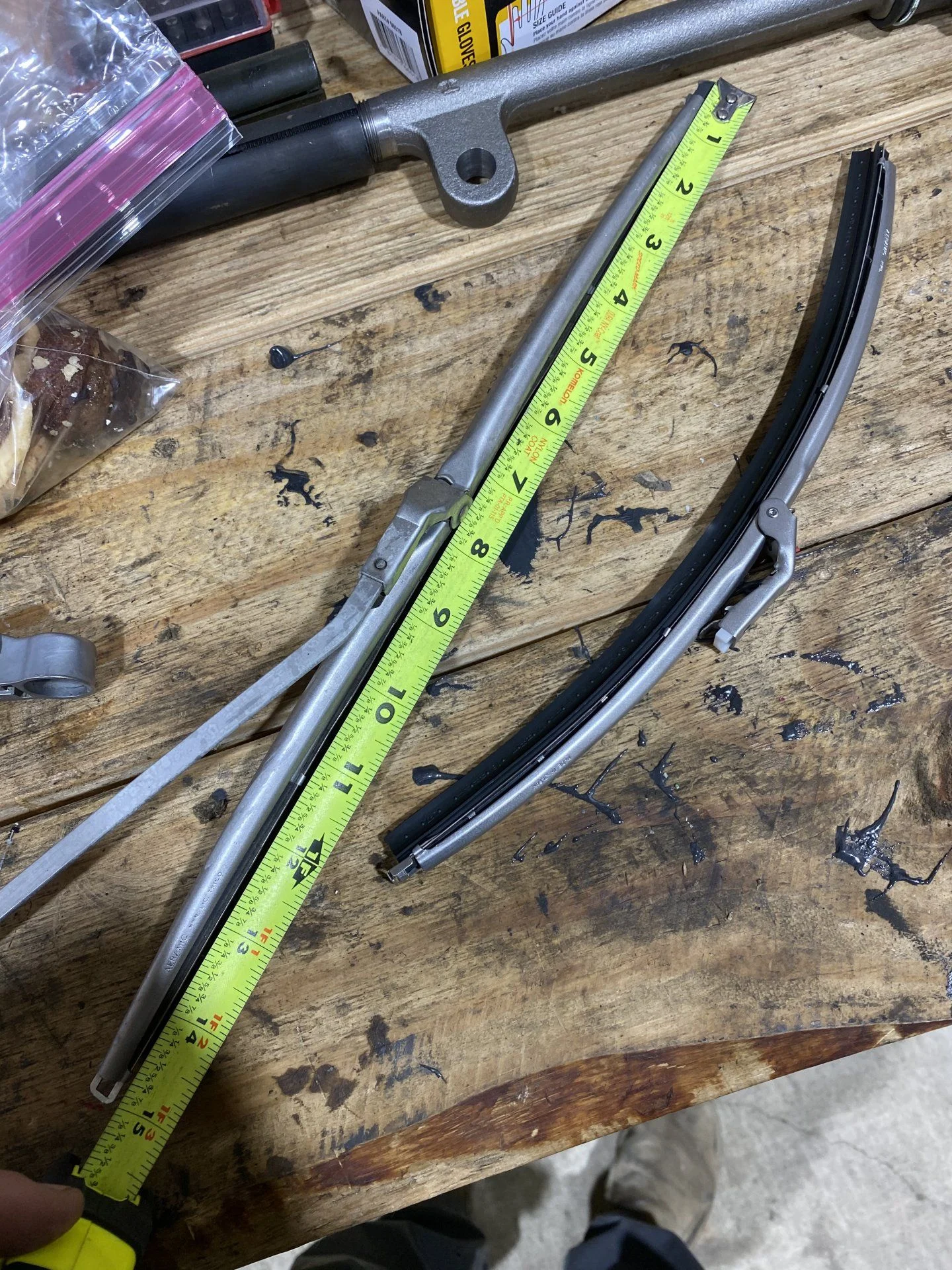

Lastly I went to install the $60 OEM wiper blades and they are tiny. Some 40 series model not 55

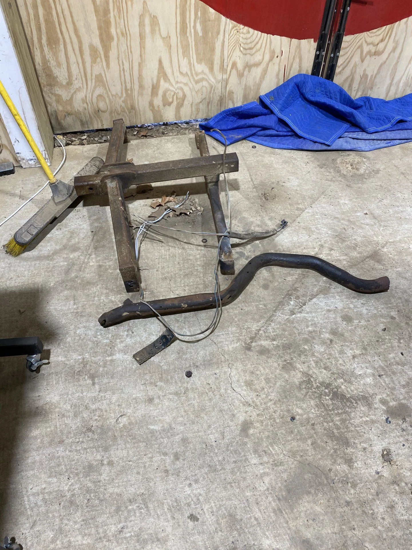

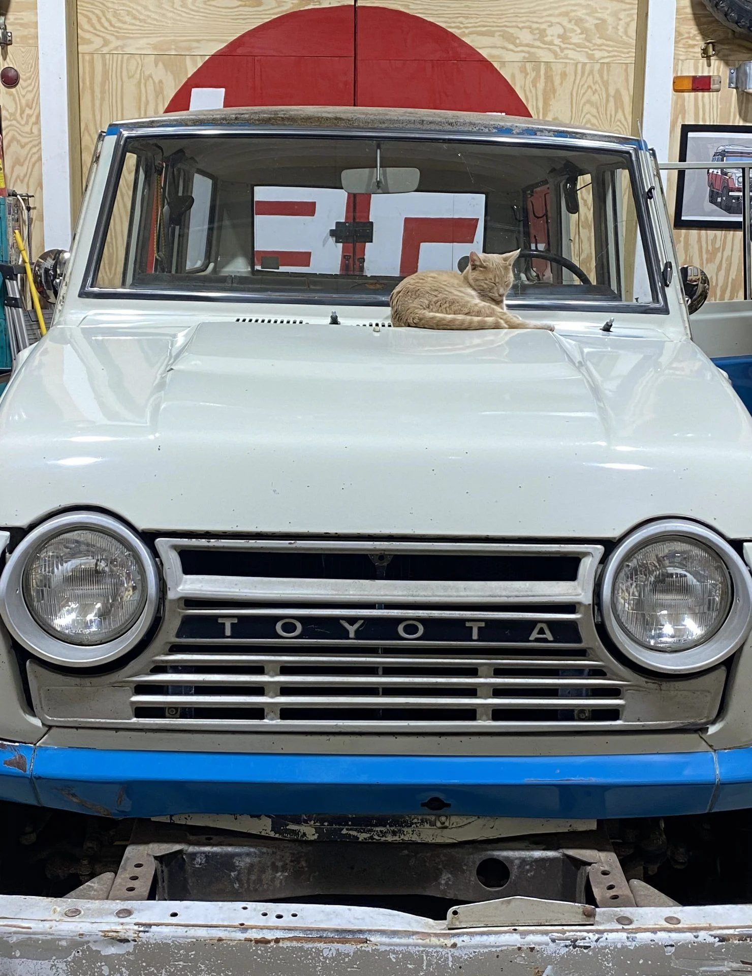

The shop cat is pissed I took the seat out
Ah, the salad days of cleaning and removal of 44 year old parts.

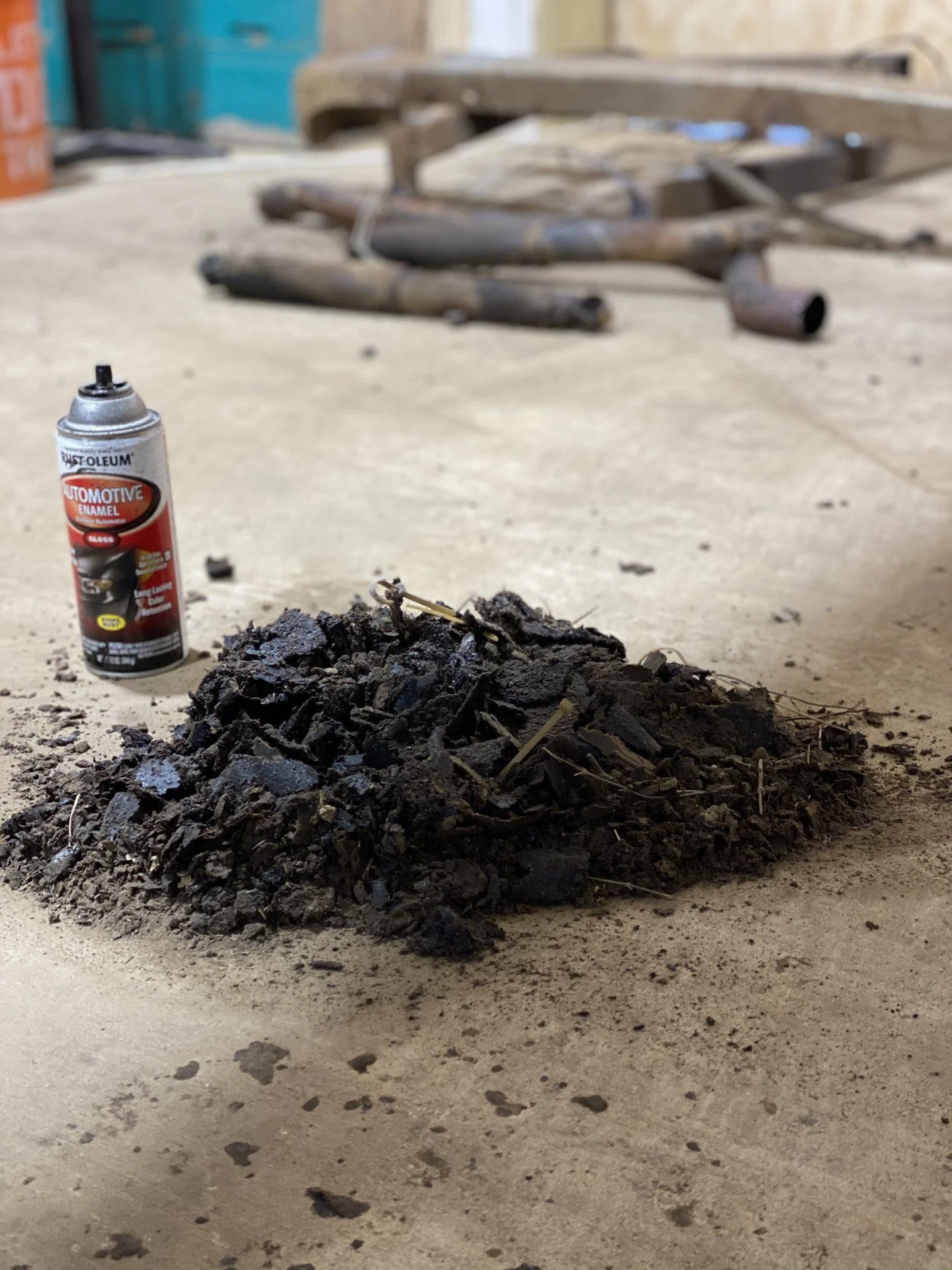

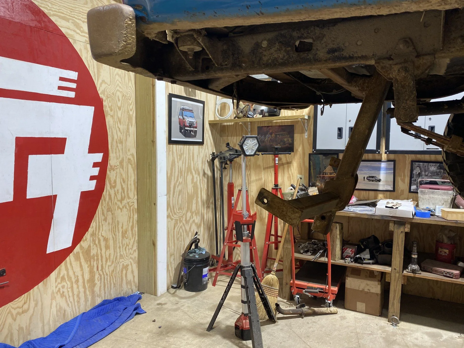

Not sure how long the rear diff has leaked but I removed 15# of caked on love from the body and axle.
Interesting, field-welded receiver
