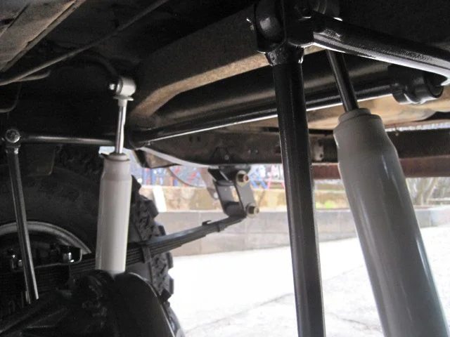

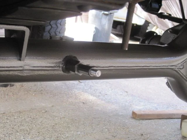

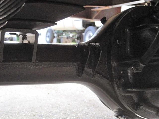

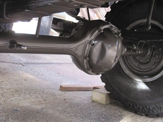

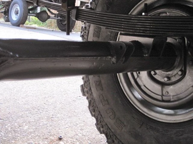

Finished welding up the rear axle spring perches, and fabricated the rear shock mounts. Threw a few beads on the stock sway bar mounts just to clean them up a bit... Painted and ready to go...

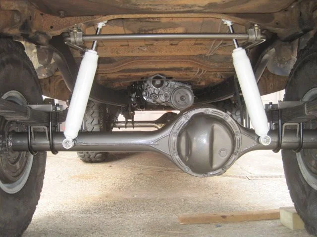

Just finished installing the rear shocks, fabricated and installed the rear sway bay, and installed the u-bolts / u-bolt plates... It looks sweet and will post pictures tomorrow...
As far as potential axle wrap issues are concerned I am thinking about fabricating up some track bars, but will have to drive it first to see if I need them.

SOA and I would definitely recommend a axle wrap device. Otherwise you are looking at a broken pinion. THis would not be a fun trail fix if you have your family with you!
You're absolutely right...
I want this cruiser to be bullet proof for a moderately tuff trail... I don't plan on wheeling the wagon hard because I want it to stay looking nice and don't want to add a bunch of heavy parts that will make it even less daily driver worthy...

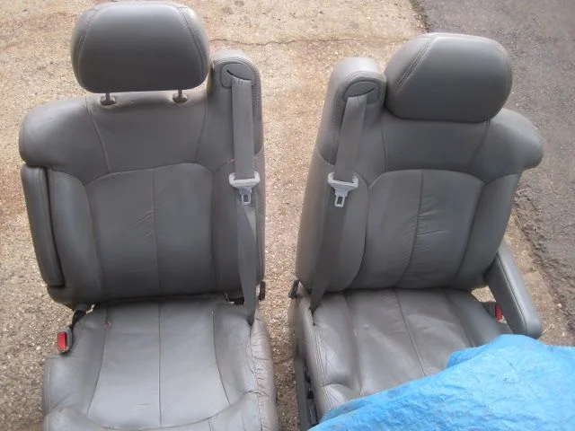

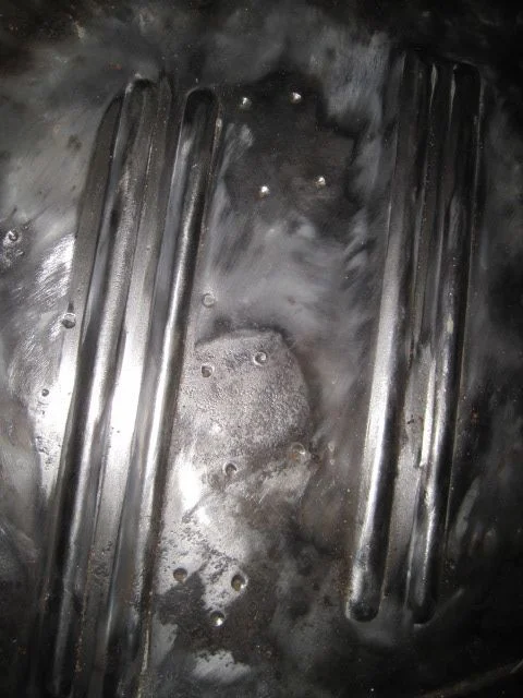

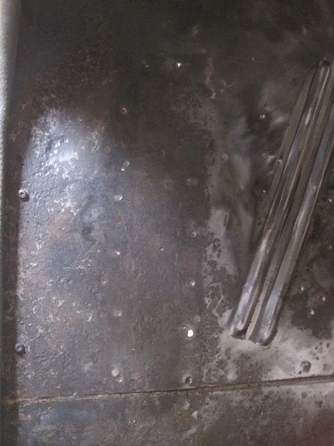

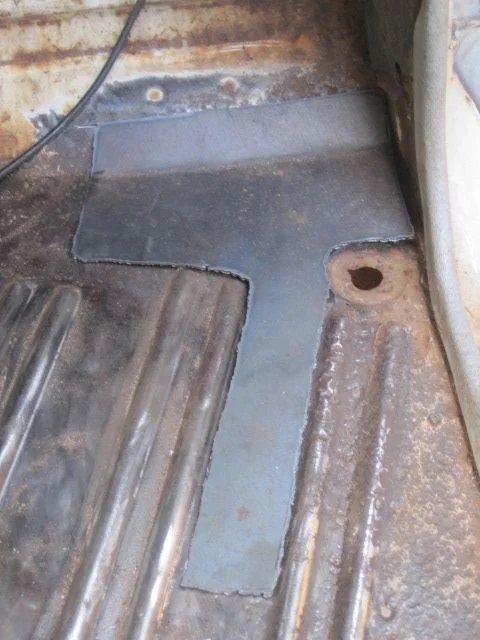

I'm using 2005 Chevy Tahoe fully adjustable power seats for the wagon. All the original seat mounting brackets have been removed so I can begin from scratch...
I have all new material to recover the door panels, rear seat, headliner, and front seats: Aligator style (But not quite as aggressive in texture) vinyl in dark graphite which will be used to wrap the seats, headliner and door panels, graphite suede for the inserts of the front / back seats, and partial accents on door panels, and finally a 57' Chevy turquoise vinyl for piping on the seats and door panels....

wow. awesome build, dude. I am wondering about your sway bar and if the 12" extensions might put the sway bar/link joint into the bottom of the body under full stuff. Are you going to drop your bumpstops?
I'd like to swap out the original bump stops for something larger, and if they still need to be dropped look into fabricating a drop bracket.
The sway bar seems to have plenty of clearance between the floor and sway bay ends. I set it up so that the sway bar was as parallel to the chassis as I could get it.
I guess the first test run will tell if they need to be shortened up a bit (No big deal)...
