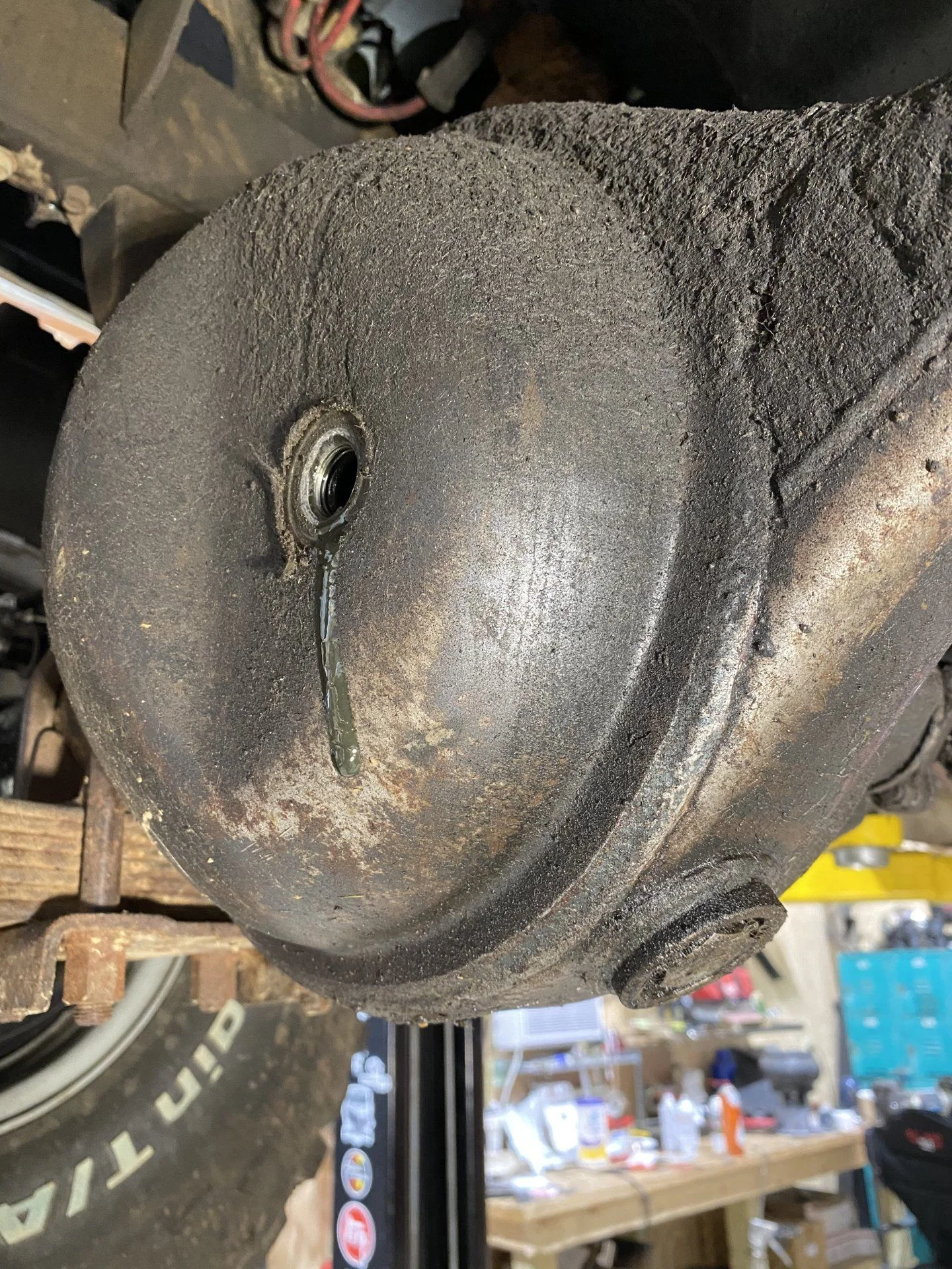

By the looks of the center section I'd still be cautious with that statement...
Ah. It’s just dirty AF. I checked the backlash and it’s good to go. All that “undercoating” came from above I think.
Freaking Mantis’ comment about the 3rd kept me up last night so before I built out the drivers side I make sure it was full of fluid and leak free before I went any further.
Full of juice with all the good from the top scraped off. As much as I hate it being not painted I know when I have the motor out I can get it much cleaner and better painted than now so I’ll keep from doing it twice.

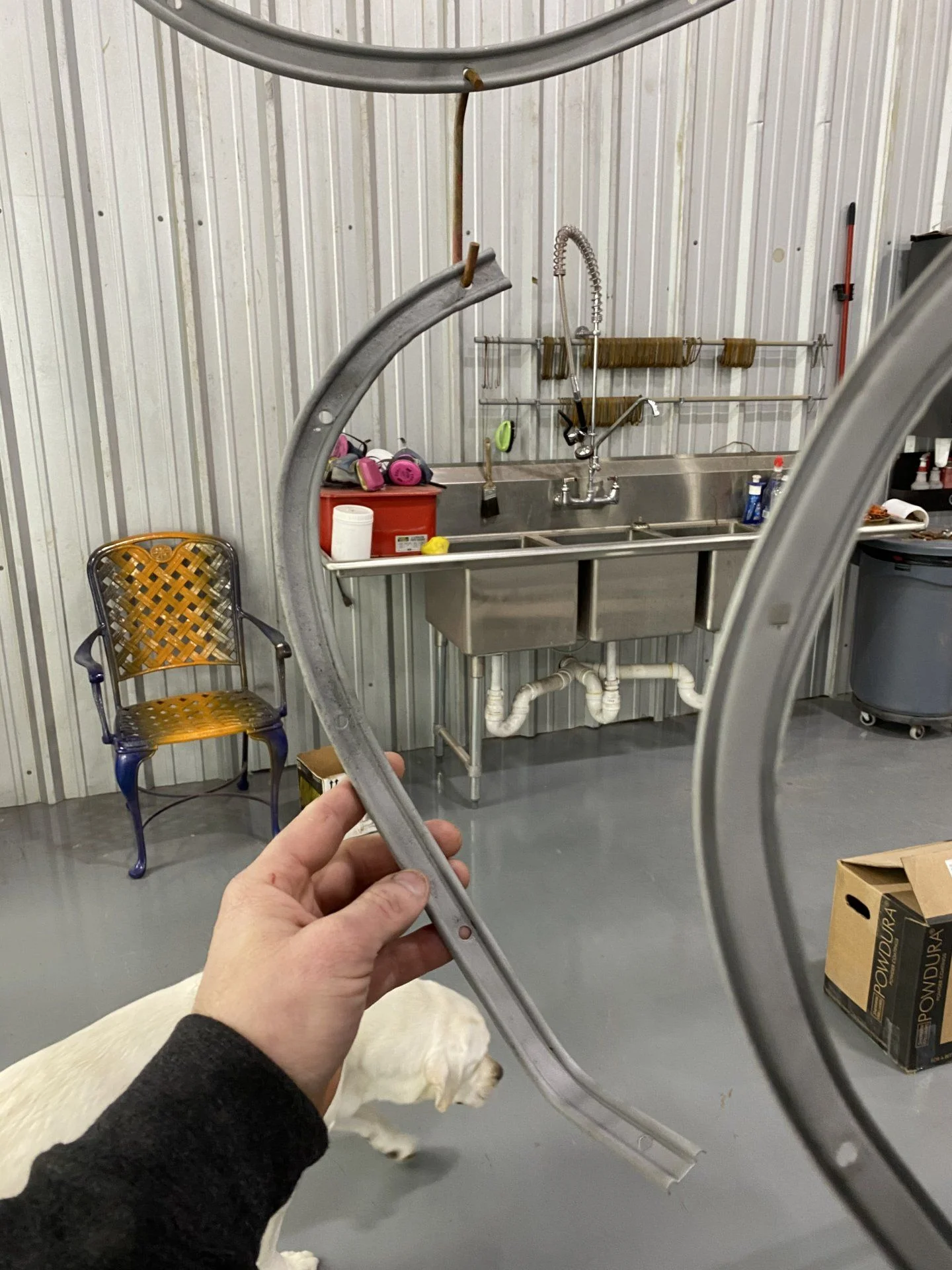

Also I dropped by Powder Keg and they are already
At least it was an easy check. Much better than putting it all back together and finding out it needed work. You should thank me, not curse me. ;)

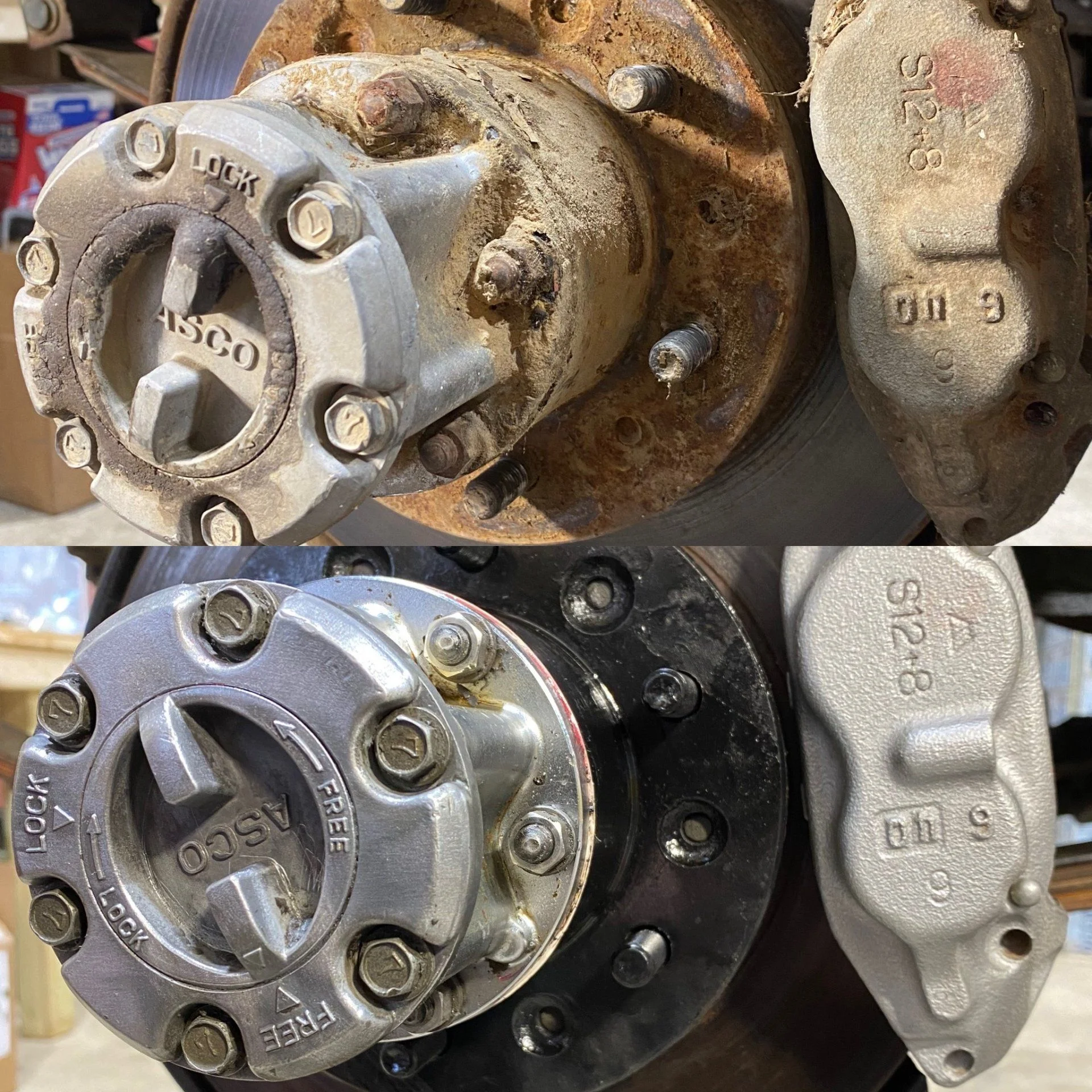

@wngrog you know when you had the knuckles apart you could have easily brought the housing to Powder Keg to get that coated too. :grinpimp:
Yes, now I'm just being an ass. :p
I did that with one. Was not cheap. They hate grease

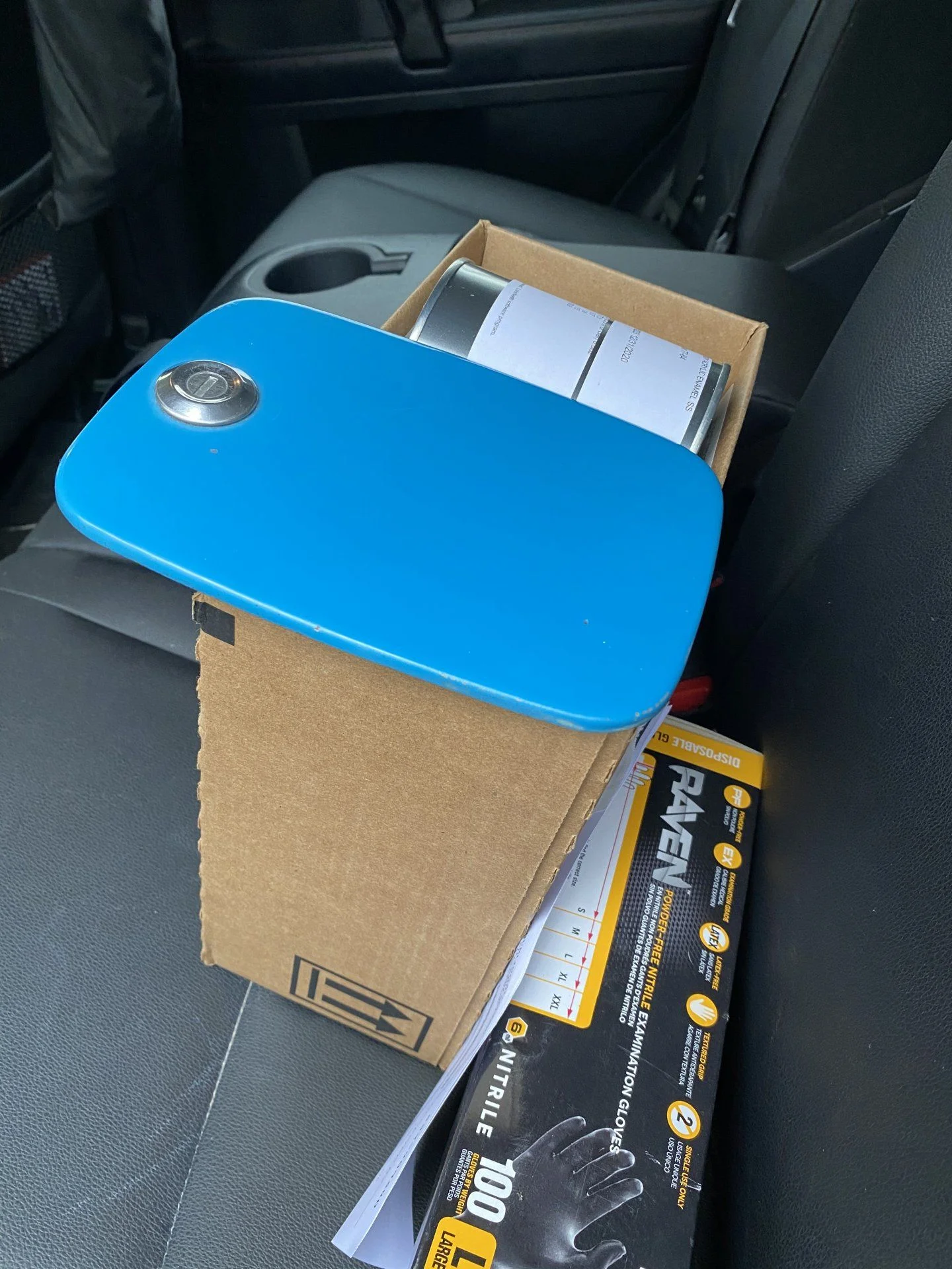

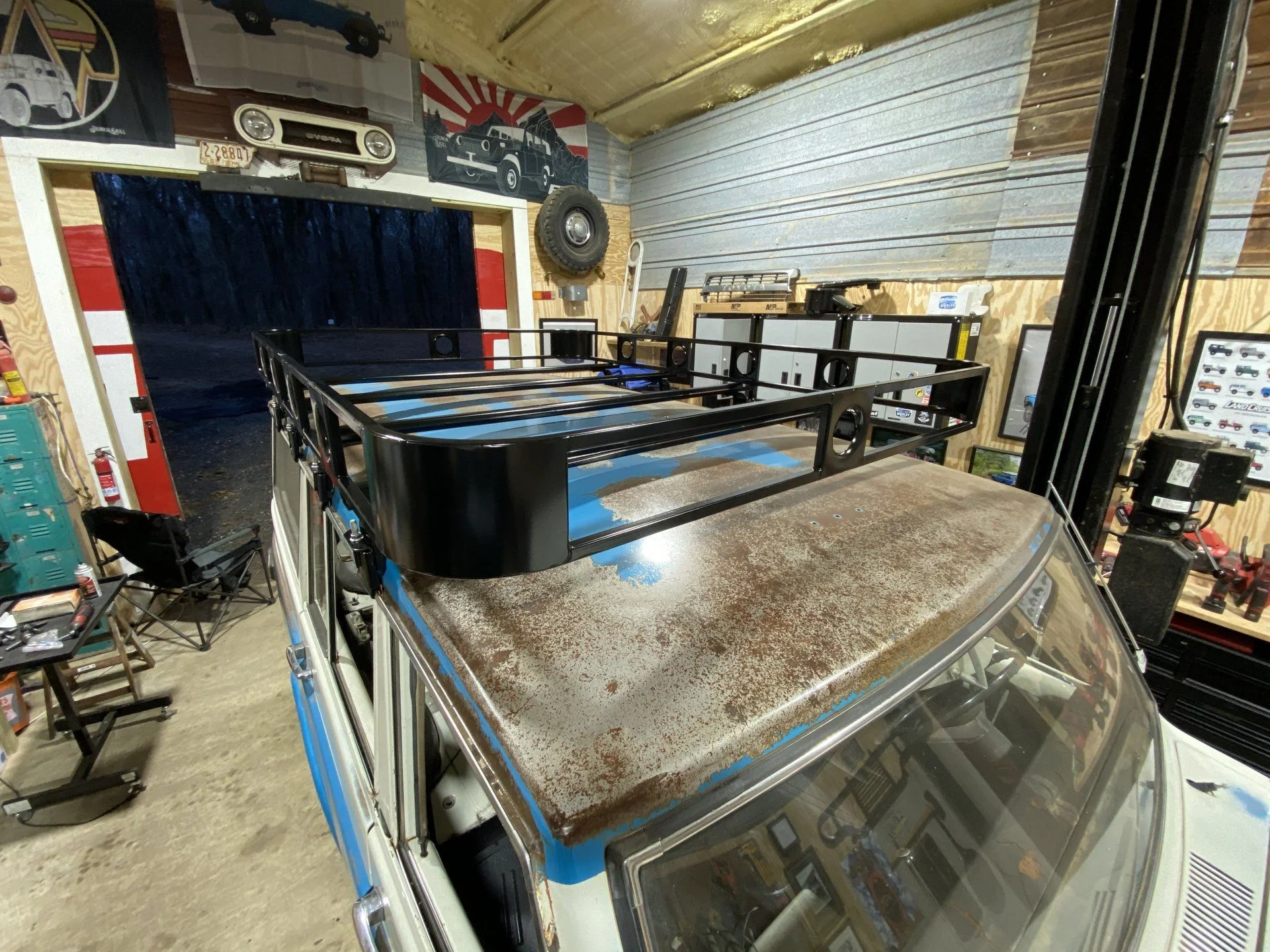

Got up this am and took the gas tank door to the paint shop for a little single stage to touch up places with primer and where I had to close up holes in the body with rivets or steel.

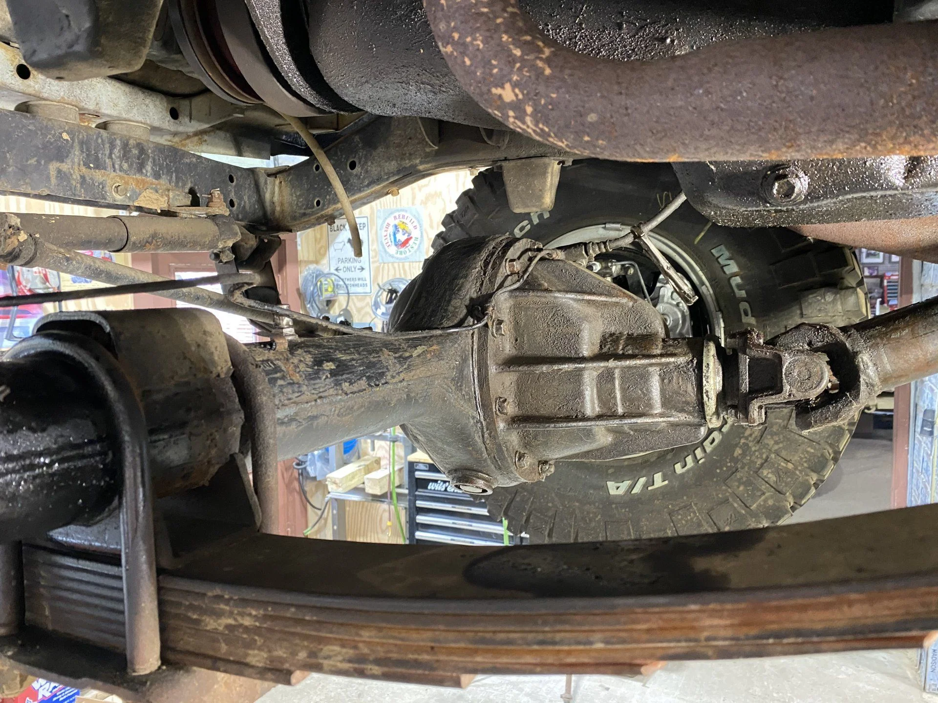

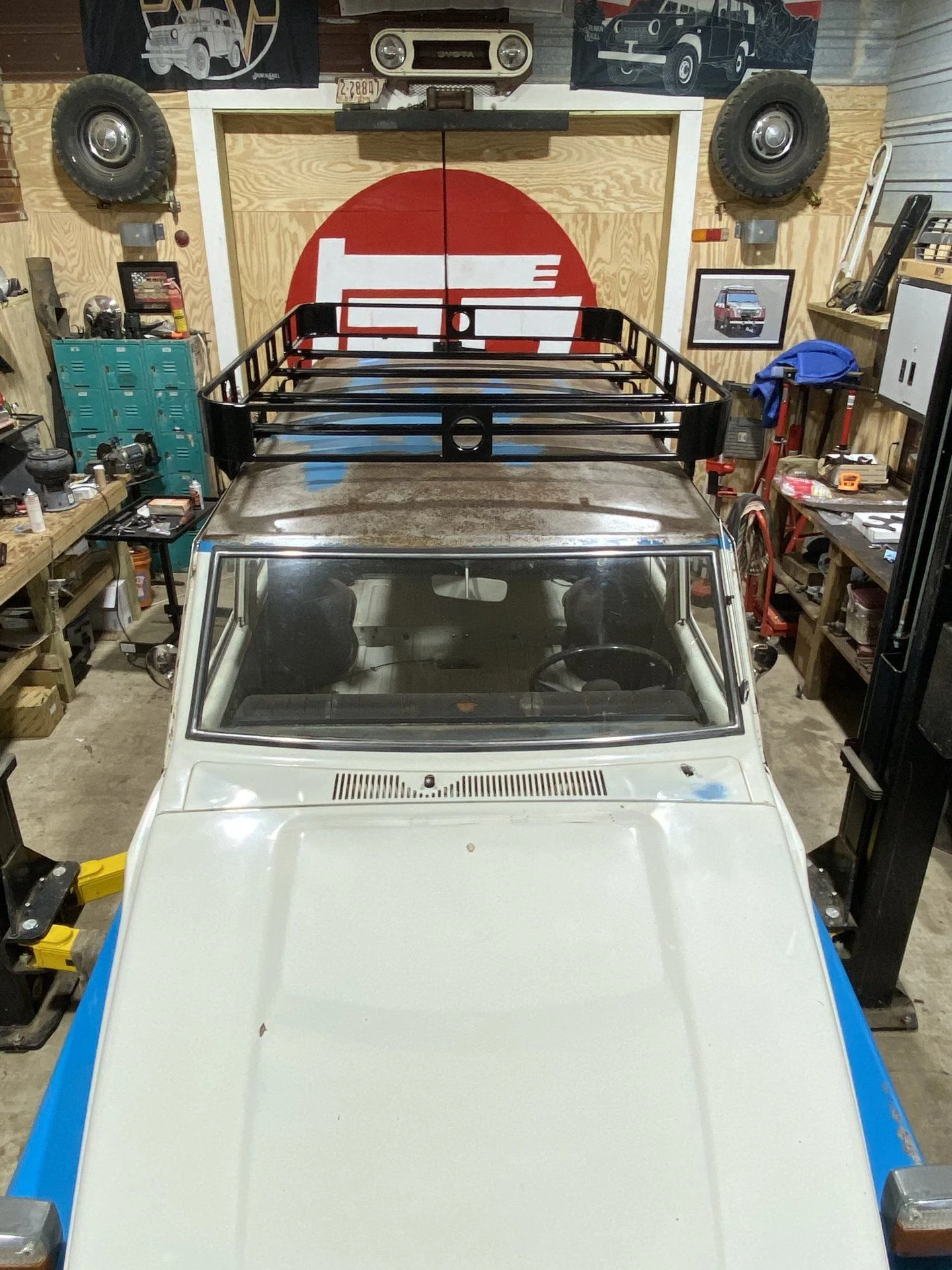

Last day of warm weather so I bit the bullet and got under this thing with the pressure washer and did a deep clean on the rest of the body. Awful job. Soaked. Cold.

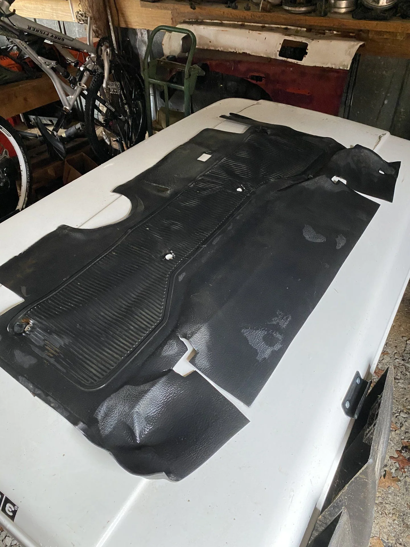

I got the middle and front mats pressure cleaned too. These things are in superb condition.

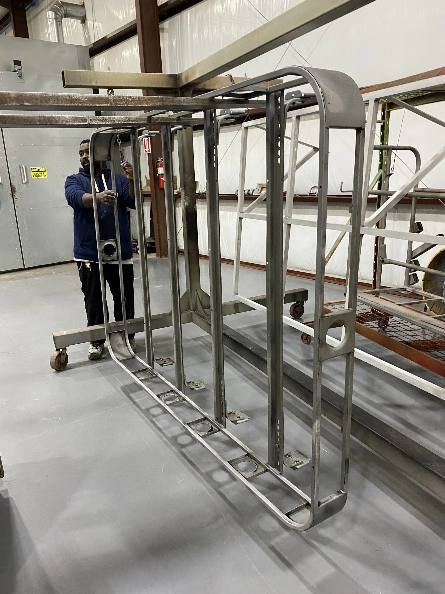

Off to get the other goodies at powder. Stay tuned
I pussed out on full pressure washing the under carriage. I did my best from the side. Now that I have so much bare metal im just going to use a wire attachment on the grinder and hit it with 185 psi air after. I never score high at the show n shine anyway.
