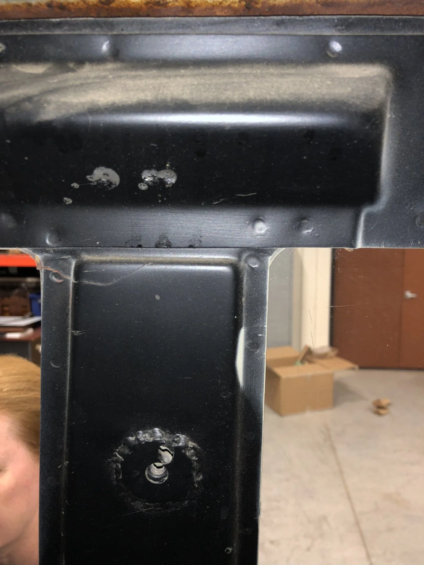

The thing that has me scratching my noggin’ the most is the B pillars. Words can’t do it justice, so here’s a pic of each.
Driver’s side:
1986273
Passenger side:
1986272
Can these be patched/scabbed or do I find a donor?

You could probably just try to weld those B-Pillar cracks and see how they do. That is weird though - had to be some kind of crazy body flex going on to cause that, but how hard would it have had to been flexed to cause that? Don’t recall Cruiser Innovations wheeling it much🤷‍♂️
Also, someone got in a hurry back in 2012. Can’t believe it’s lasted this long.
I think that’s fairly common on a pig that’s been driven off road, I’ve had five pigs here at one time or another and several have had cracked A and B pillars.
A guy could cut those spot welds and reinforce pillar with a chunk of 1X2 box tube then put everything back together if strength was a concern or just weld up the crack if not.
Either way I would take a close look at the body mounts.
