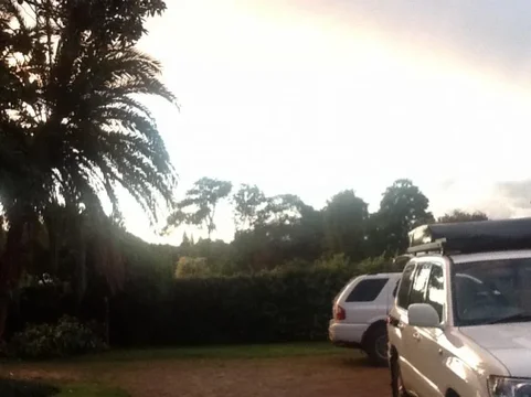

Should be easy to make, its is home made not a front runner product
That is really cool! Does the bottom part that braces against the tire have a locking mechanism? I would be afraid of unloading and adjusting your feet and having that thing hinge down off the tire and then you go crashing down and the ladder goes into your LC's body...Is it made of aluminum or steel? I really like it a lot!
Good and ingenious looking ladder idea Marius! Its just what I need! Solves many problems with RTT ladders: I like it!
Its a south African idea so maybe Christo can make some,I got a ATV ladder that I plan to use when I make mine
