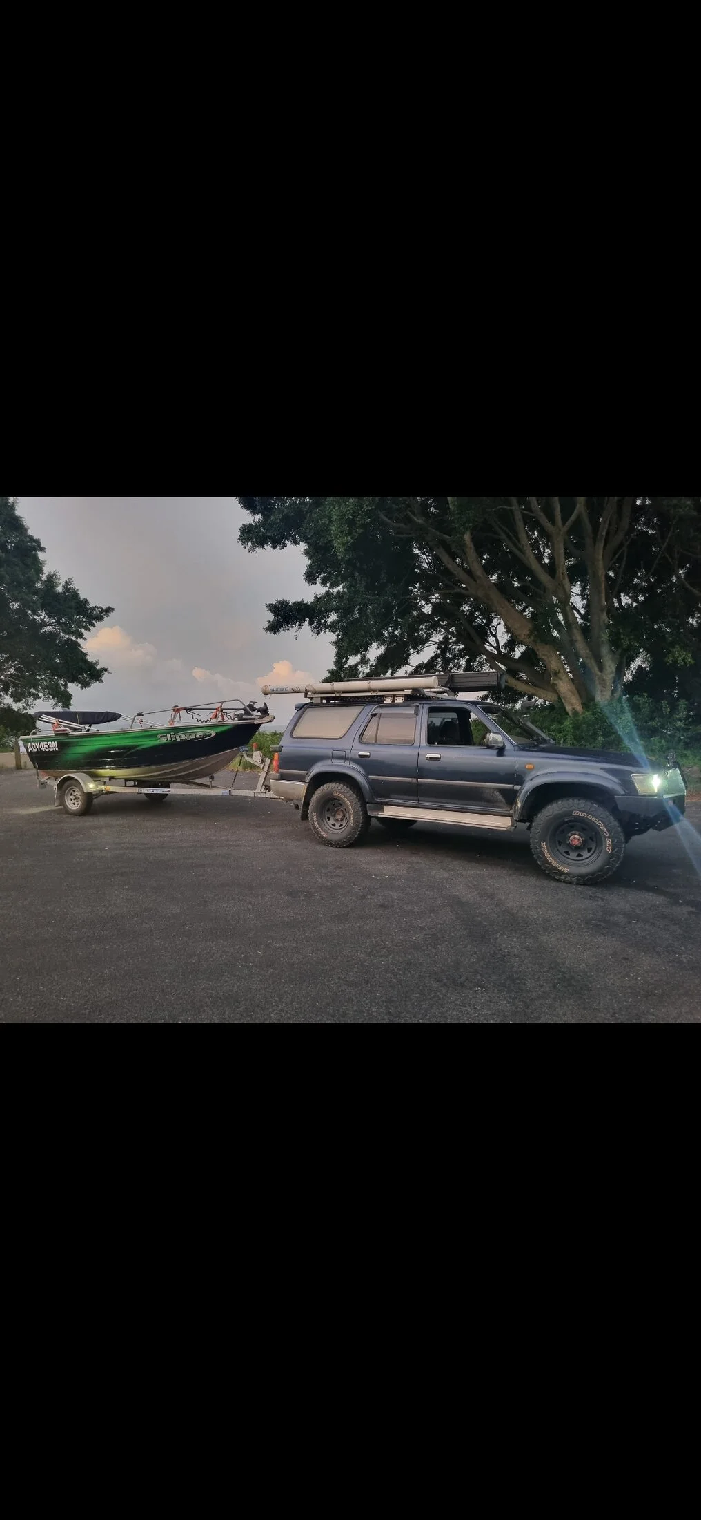

Hey all I'm starting to gather the parts and information I need to manual swap my '95 Surf and would like to chat with people who have previously done it. It currently has an A343f Auto and I'm planning to swap in an R151F 5 speed manual. The parts I know I will need are:
