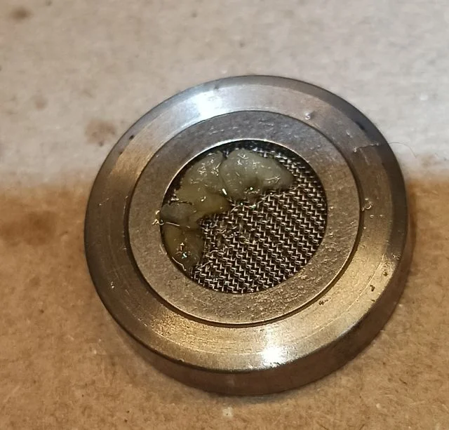

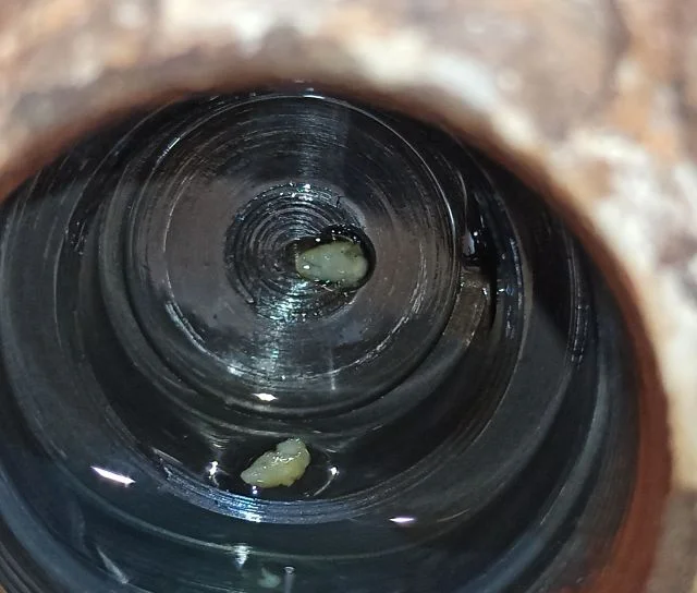

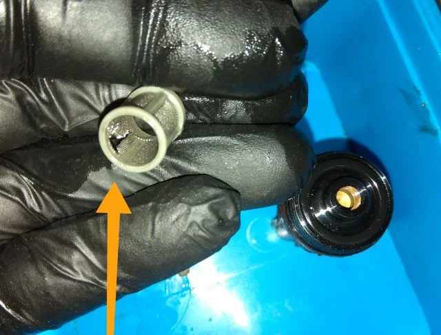

OK. I've got it. Speed sensor has plastic fixing that cracked and went inside blocking the intake just befo spill valve.
Propably due to overtighning the nut. Interesting thing. Also one of the 4 filters there was damaged.
Have a look: Pump1
I hope it'll help someone.
