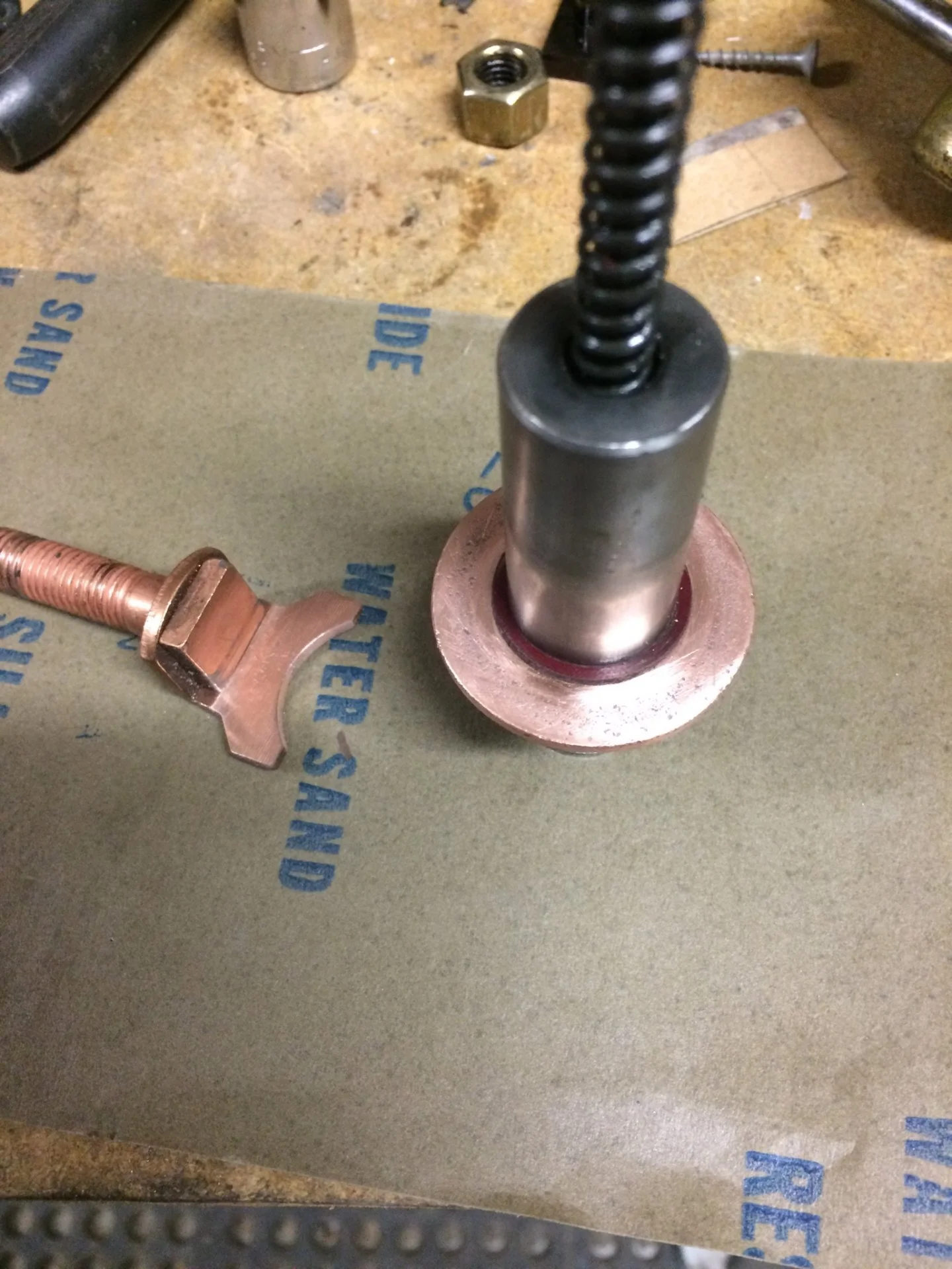

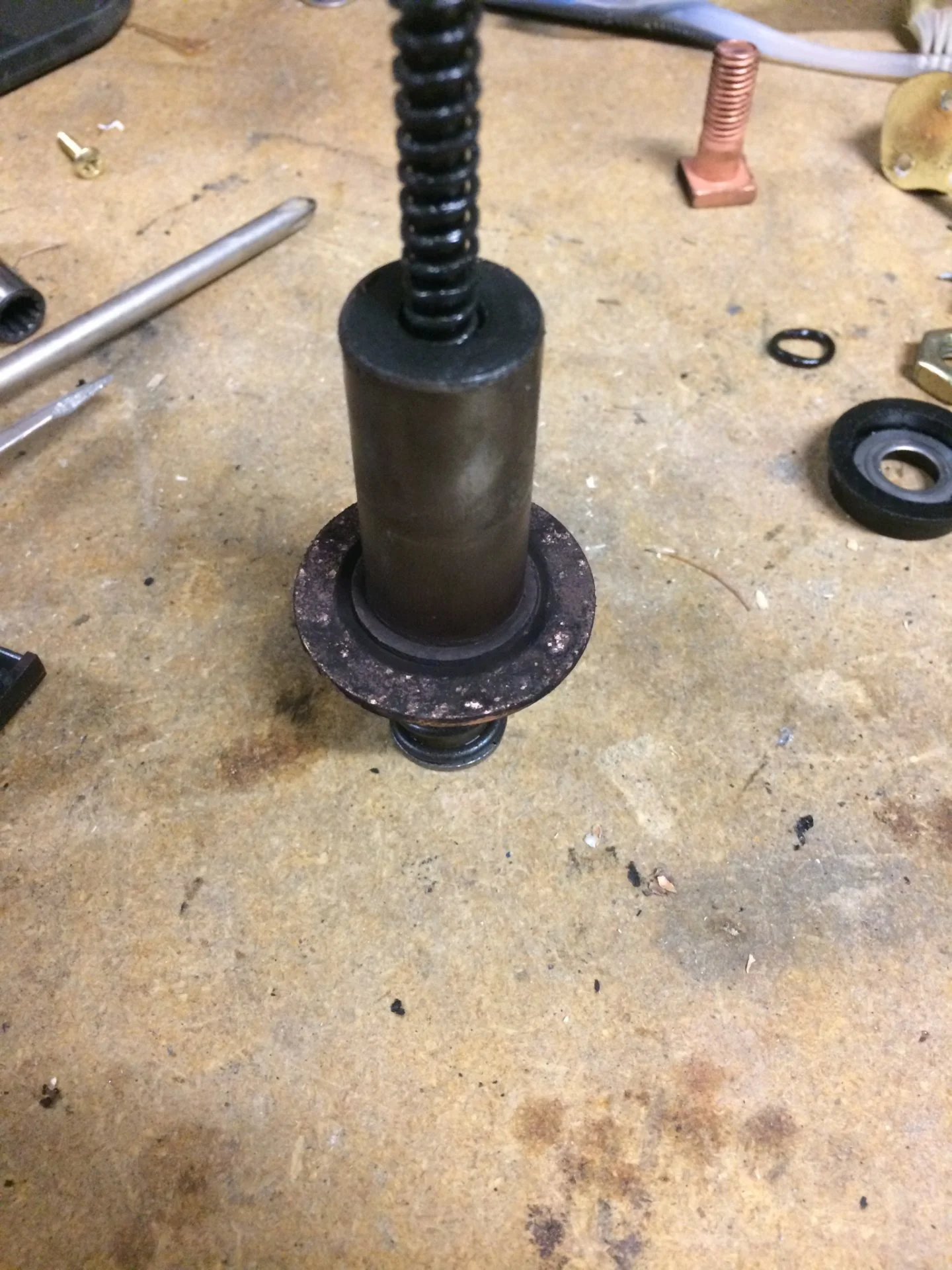

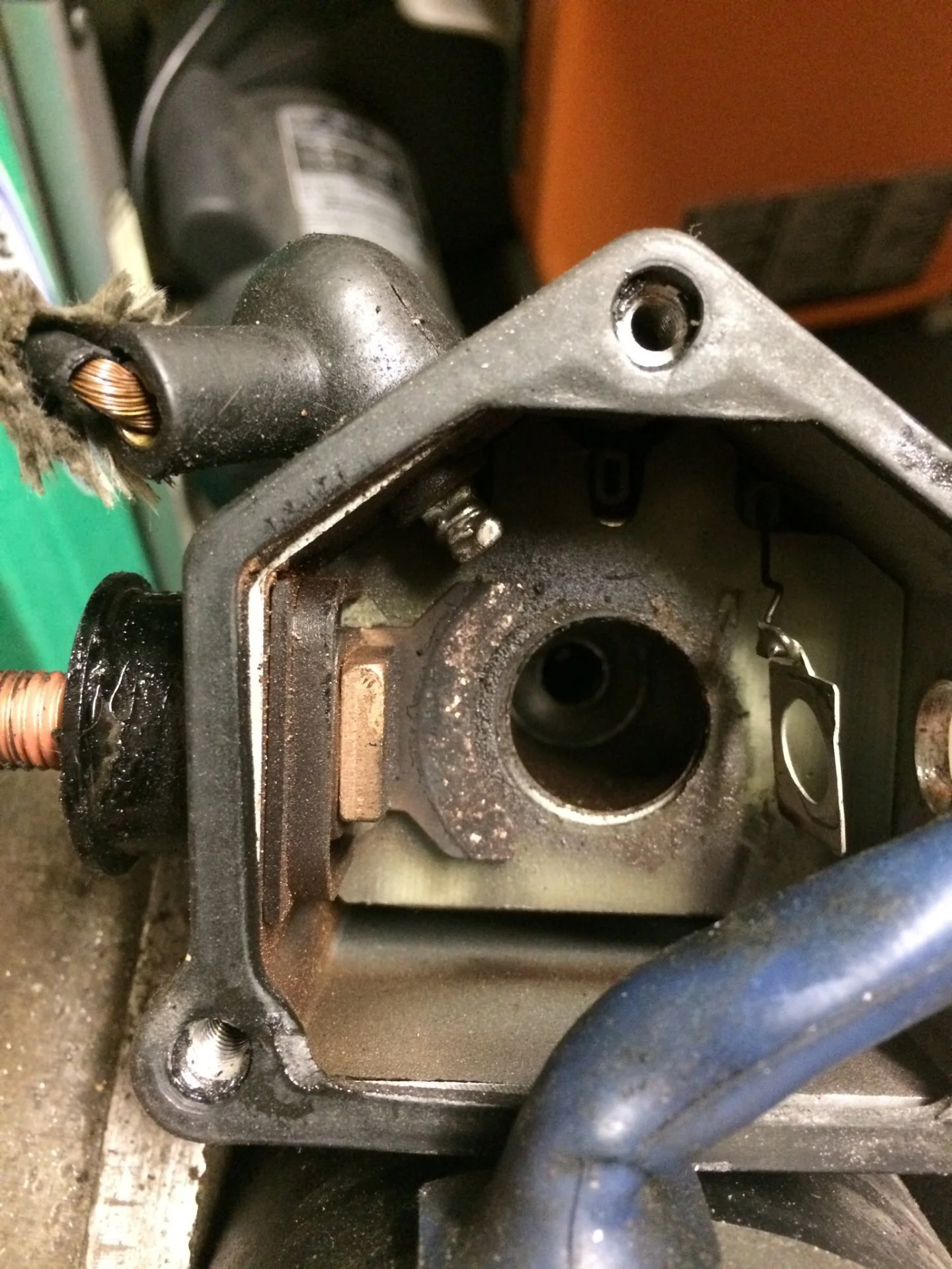

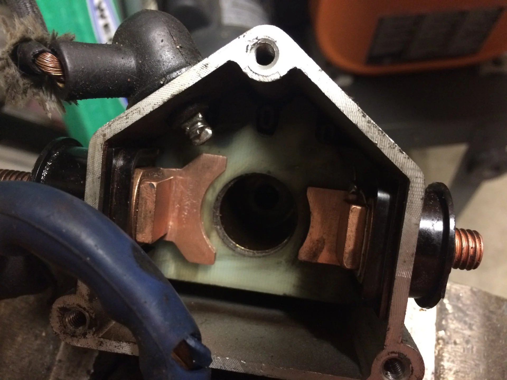

Sounds like the contacts in the starter solenoid are worn and need to be cleaned and the solenoid plunger greased.
Here are some photos of an HDJ81 starter I did a number of years ago; yours should be pretty much the same inside.
Thanks appreciate it, that was my next course of action. When I was researching it, seemed like something other than the starter solenoid due to other posts and symptoms. But I will try that out.
