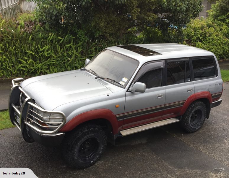

Anyone knows where can I get bull bar as shown in image below?
I've only seen them here on 80 series Landcruisers imported used from Japan. I'd guess Toyota made them but maybe there's a Japanese 4wd accessory manufacturer that made them. Check your nearest 4x4 dismantlers, you may may find something similar that can be modified to fit.
Cheers
Clint
These are damage multipliers. You may want something a little more stout or a push bar style that work damage more of your truck than it should.
Brush guards are Damage Multipliers
Amen to that. It's hard to make out how they are attached on the 70 in the above pic but if it's anything like the mount on the 80 in my pic they are worse than useless. A friend of mine with an 80 series that had something similar to these bars actually made a new steel bumper, then chopped the upper section out of the old bar & welded that on top which worked quite well, kept the nice matching lines of the bars around the lights but massively stronger as it was mounted straight out from the chassis.
Cheers
Clint
Thanks guys! I'm looking at something that looks good aesthically only. Not really for bashing.
But will keep in mind that brush guard is a no no. And arb bumpers are better.
Photos really explains everything on reliability for those mounted on bumpers.
