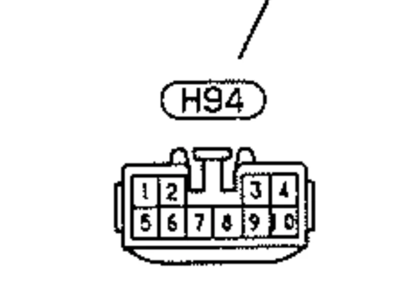

I found what I think is the wire to pin #8 to the Diff Lock (4WD) ECU and cut it.
I earthed (grounded) the end of the wire going TO the 4WD ECU and tested. The Diff Lock would engage in all modes. 4WD High, 2WD (High) and 4WD Low (as original), Great, I thought, job done! BUT....
The Diff Lock would not disengage until I re-connected both ends of the wire.
Upon re-reading the information above I saw that the end of the wire still attached to the plug should be grounded (not the other end?). I tried this, but the Diff Lock wouldn't engage in any mode including the original 4WD Low.
This is a pic of the wire I cut and earthed:
All I can think at this stage is the wire I've cut is not the 4WD Wire. The Wiring information I've been able to find are for other 70 series models and other Prados. The KZJ78 was only sold in Japan so I presume the manuals will be rare and in Japanese.
If anyone can throw any ideas on where I've gone wrong, I'd be most grateful.
