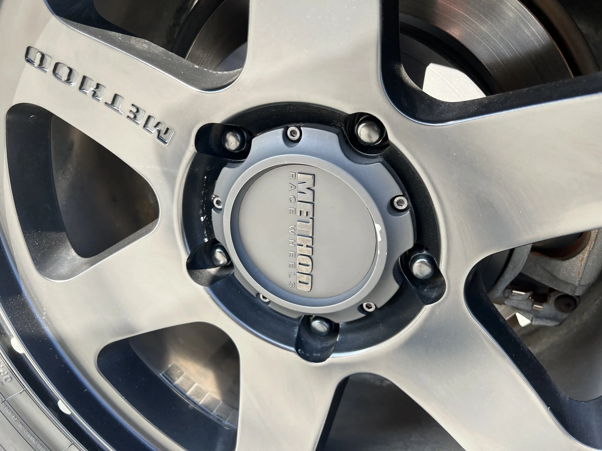

You will clear the KDSS / sway bar but will be rubbing plastic as you rotate the steering wheel.
If you don't want to rub/touch the plastic fender liner you will need an offset between 50-60mm. 35mm offset wheels are the challenge as the wheel is about 1" further out from the hub then the OEM Wheel. This leads to the tire coming into contact with either the mud flap at the rear of the wheel well or the plastic at the front of the wheel wheel when making tight turns (such as a u-turn). I wouldn't be surprised if the stock size 285/60r18 rubbed with the 35mm offset.

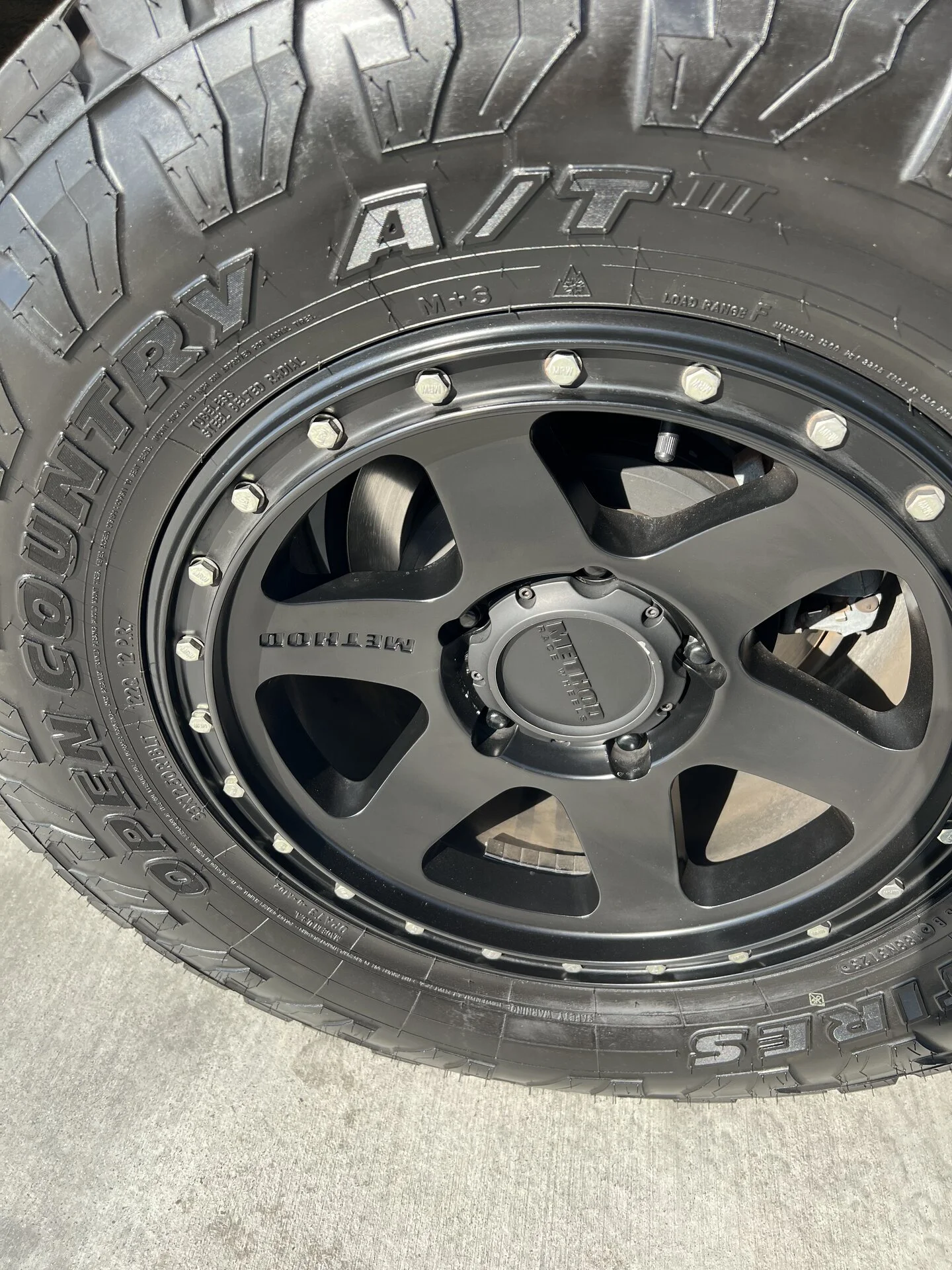

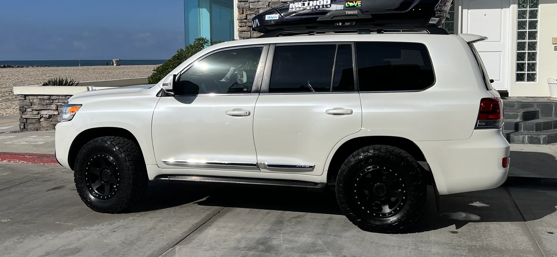

s***! :-) This has been a nightmare! This is what I want to do. Pls see pics. Thank you.
So, in other words, leave it alone? Save my money? I wonder how the guy in the pics did it? Thx. Jeff
Get to it lol

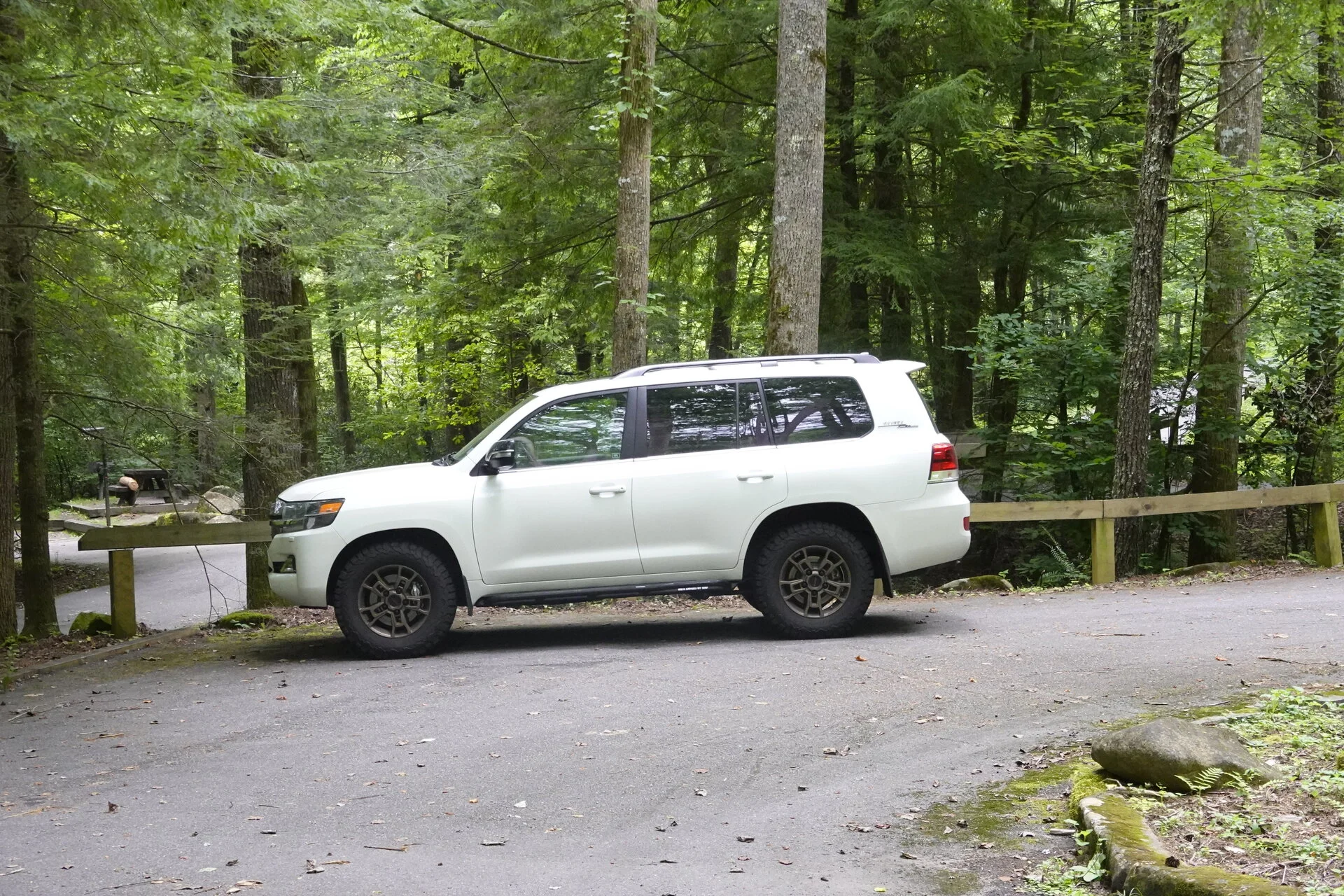

I have no rubbing with this tire size. It is close at full right lock and backing up but it does clear. Stock suspension and Heritage rims.

Yes, mine is a Heritage edition. I did have some minor rubbing at right full lock backing up at first, but I found that the plastic wheel well trim was loose. I forgot to tighten it back up after installing the Slee skids. I pushed it forward away from the tire as far as it would go and tightened the screws and problem solved. After that, I have about 3/8th inch clearance. I have had it off road and still no rubbing at full stuff. With the rain the Mojave received over the past year, many of the roads are in really bad shape, I need all the ground clearance I can get, thus the larger tire. I still need about another two inches. Some places I used to go are now impassible. The road is just gone. Of course, the BLM is happy. Less for them to do.
Horse Cove Campground, outside of Robbinsville, NC. I used to camp there back in the '60s with my family. It was one of the nicest campgrounds I have ever stayed at. The campground is now in shambles, no water, no maintenance, trees down, Santeetlah Creek is clogged with logs, Many of the camp sites are uninhabitable and others blocked with downed trees. It was so depressing, I didn't even stay.
I don't have any close-ups of the tire clearance. Sorry.

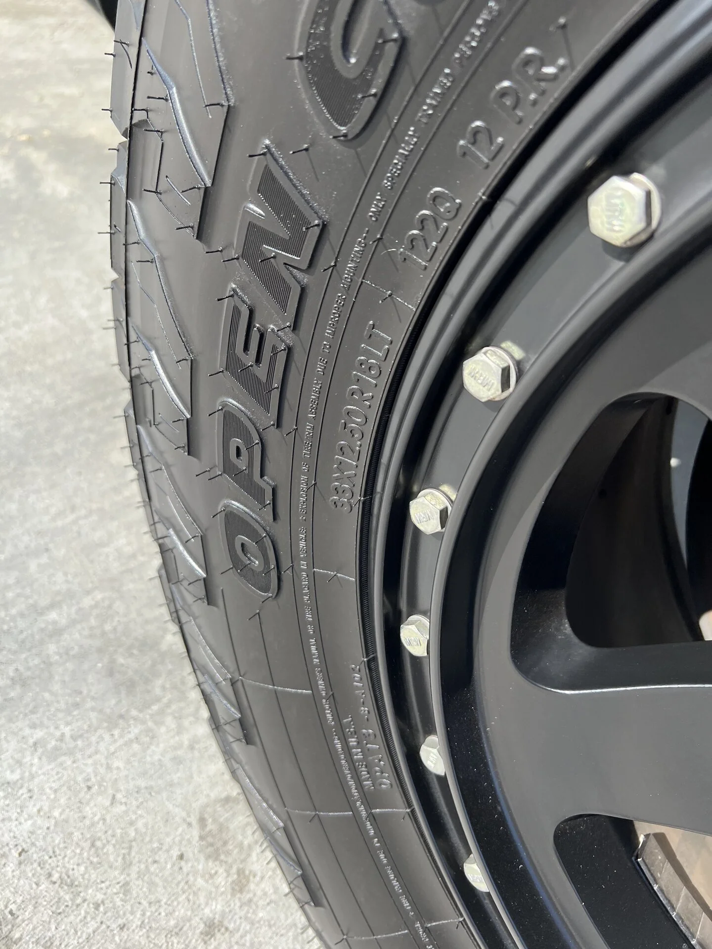

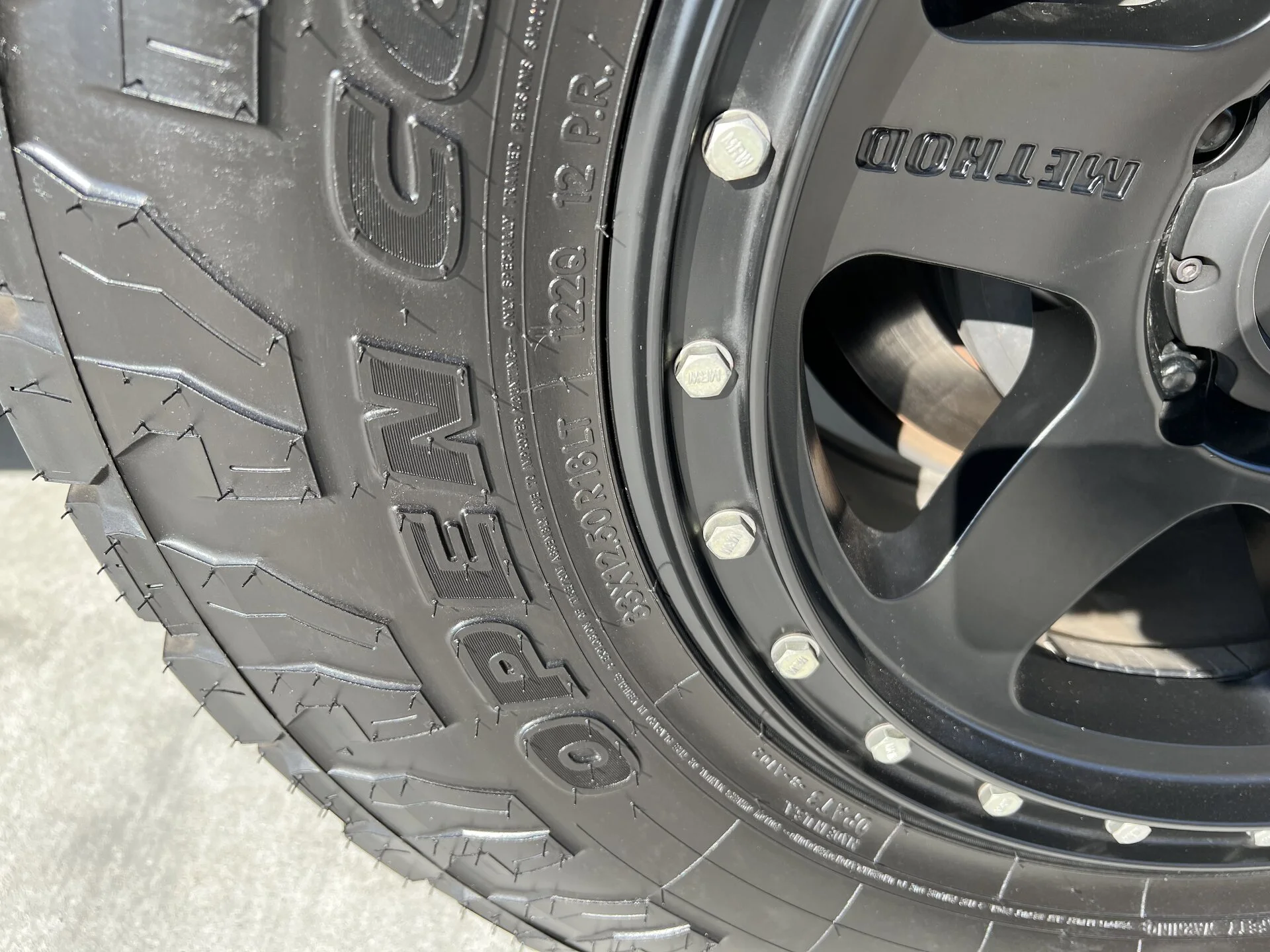

Good lookin ride! Tire size again please. Sorry. KO2’s right? Thx. Jeff
