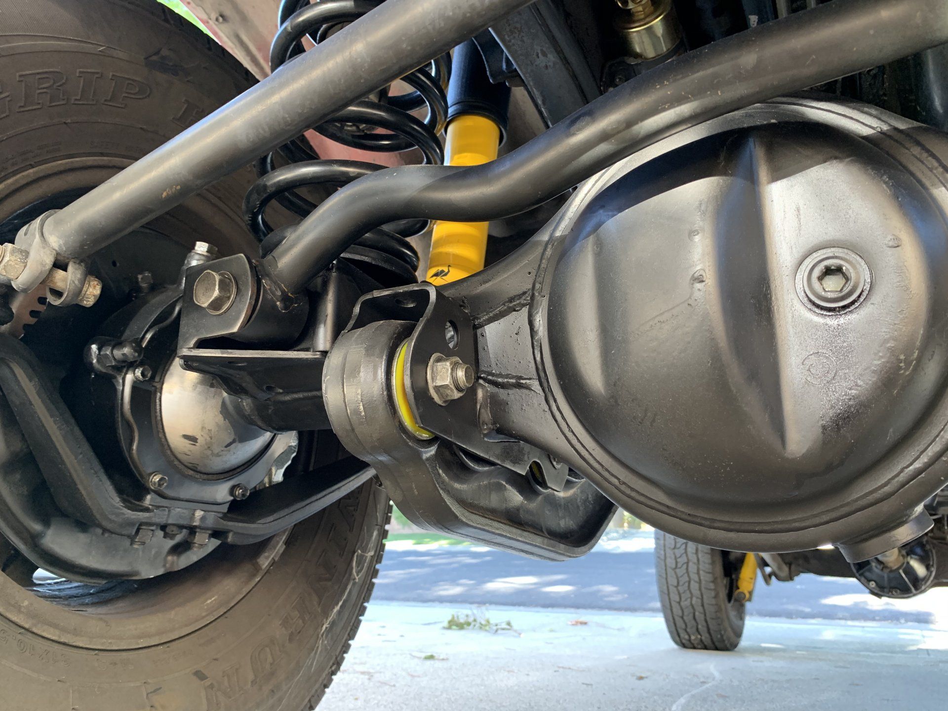

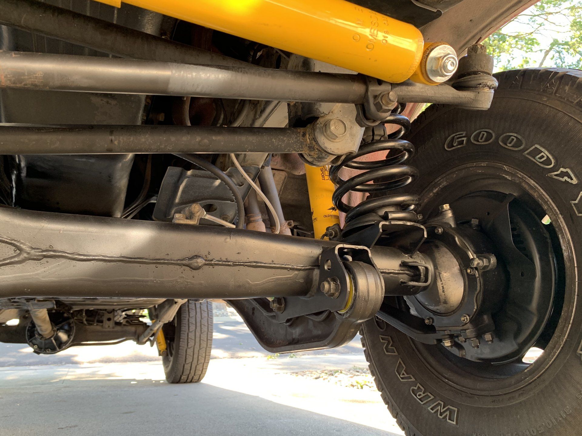

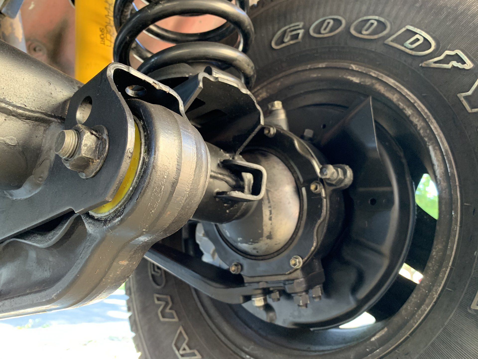

UPDATE: since I was gonna regear and install lockers at some point, I went ahead and took care of it now. 4.88 regear, ARB front and rear lockers, knuckle rebuild, brakes/rotors, extended brake lines, and new front pinion seal.

Damn I’m extremely jealous of your undercarriage, that is CLEAN!! Those are caster correcting bushings, correct? Keep an eye on them since word on the street is that they’ll break down considerably faster than standard rubber bushings.
Thanks, yeah, it cleaned up pretty good. I’ll keep an eye on the caster bushings
