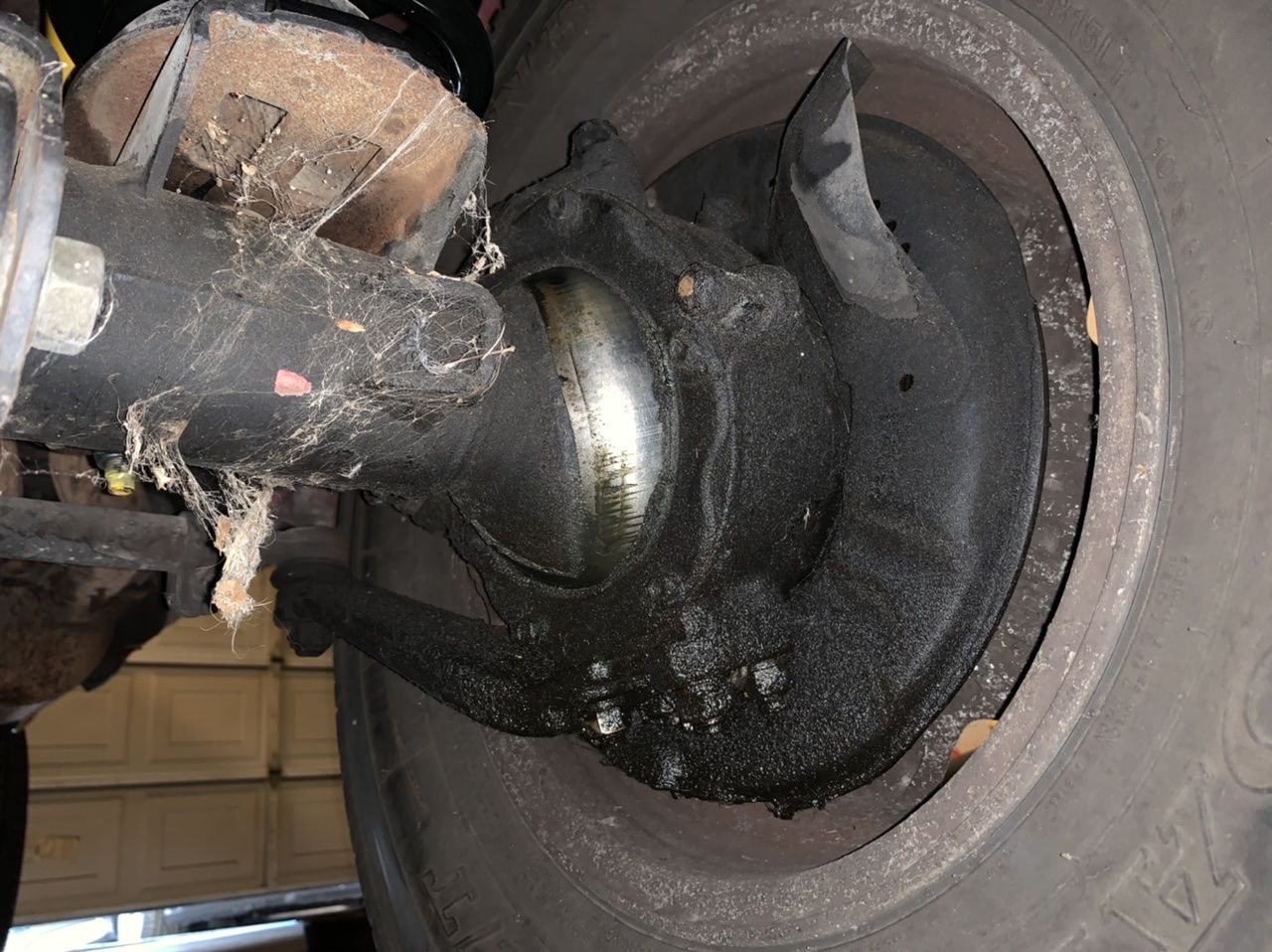

Going through baseline projects on my 92 LC. I noticed a layer of grease around the birfs/knuckles. Would appreciate hearing from those who’ve had this issue. Are the wipers or inner seal shot? Should the knuckles be rebuilt?
Pretty messy. If you don't know the history, put it all right to the best of your ability.
Here, the mess is mostly on the lower half of everything. This could be a sign that it's flung most of the grease out already and has been running low. Best to pull the square-headed plug that gives you a peek in and see what the lube level looks like. It might be scary low.
looks like you’re probably due for a front axle rebuild...inner axle seals are most likely letting diff oil pass to the knuckle which mixes with the grease in the knuckle and creates “birf soup”. You’ll want to make sure your knuckles have sufficient amount of grease in them and plan on a rebuild in the future. Check the FAQ for front axle rebuild.

It’s very low. Will fill up tomorrow for the time being.
Sounds like the way to go. Will fill up tomorrow. Not sure what the front diff looks like. Fill plug is seized, so will work on getting it out to see what oil looks like in there.
You want to fill the trunnion box (what the square head plug taps into) with the appropriate moly fortified grease. It will keep leaking out until ithe axle is rebuilt with new parts. It's probably birf soup in there, what's left of it anyway, but you need to keep it topped up until it gets fixed. Most likely, the failiure of the inner axle seal allows the moly to contaminate the lube in the pumpkin and axle. Best to use some cheap lube and run it a little then change it, in order to get most of the moly from inside where it contaminates things and may cause issues with premature wear in some bearings.
That stuck plug can be a PITA. If not too chewed up already try to tighten it a little, as that can help break them lose. Also, if you can keep an impact socket on the plug, use it to bang away on the plug. Juicing it with PBBlaster may help, too. You need to get in there, as you'll likely find the diff low on gear lube due tio its mixing with things out toward the hubs.
The spider webs make me think it’s been sitting unused for awhile. If that’s the case, the moly fortified grease can separate a little and that’s what is probably leaking past the felt wiper seals. Waking the beast from sleep mode is an exciting experience and there will be gremlins in need of addressing. Me, I would fill the birf 3/4 full and monitor the leak as I addressed other symptoms of coming out of hybernation.
I used the valvoline moly grease during my rebuild but I found that O’Reillys had their own brand so I picked up some of that stuff as back up or for future top ups. Not that the stuff is expensive but I’m sure it’s a few bucks cheaper. Good call on it sitting for a while, first thing I noticed was those webs!
