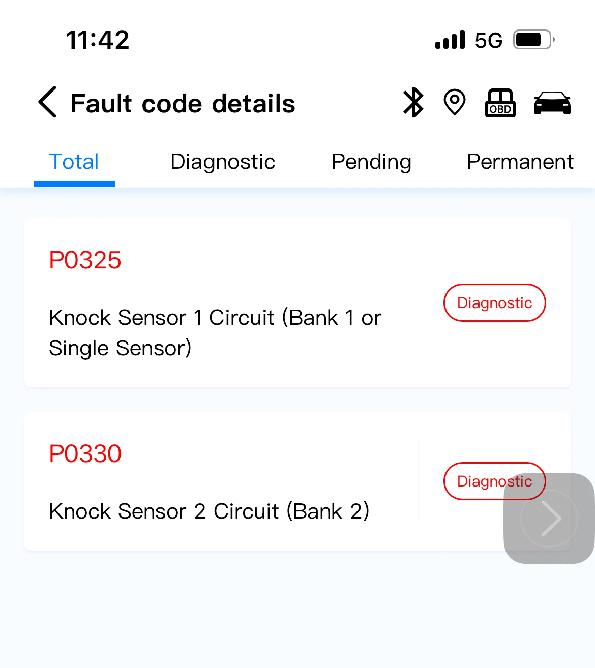

i replaced the knock sensors recently with two new ones I got from Amazon. https://www.amazon.com/gp/product/B08GYQJX3R/ref=ppx_yo_dt_b_search_asin_title?ie=UTF8&psc=1
The price difference between OEM and these is enormous but i am afraid so is perhaps the performance of them. With New Sensors and New Connectors, the error code wont go away. Cant tell from the code if it is the circuit or the knock sensors that are bad. Any ideas who do i fix this? New OEM Sensors are $150 each which i will buy if i have to but wanted to check if anyone else has used any aftermarket knock sensors that still work and were not very expensive. Do i need to look at something else?

Yes. Check engine light keeps on
