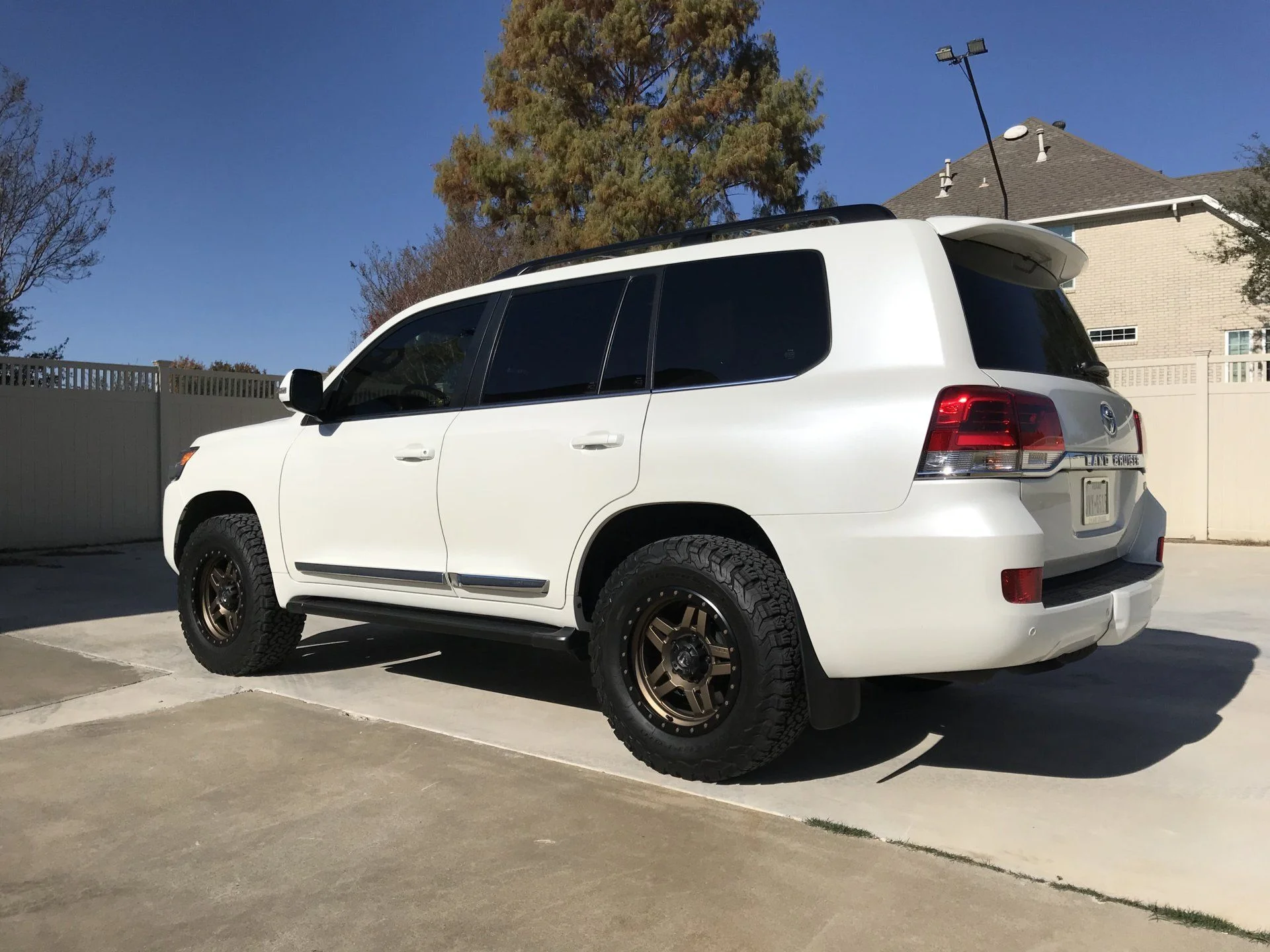

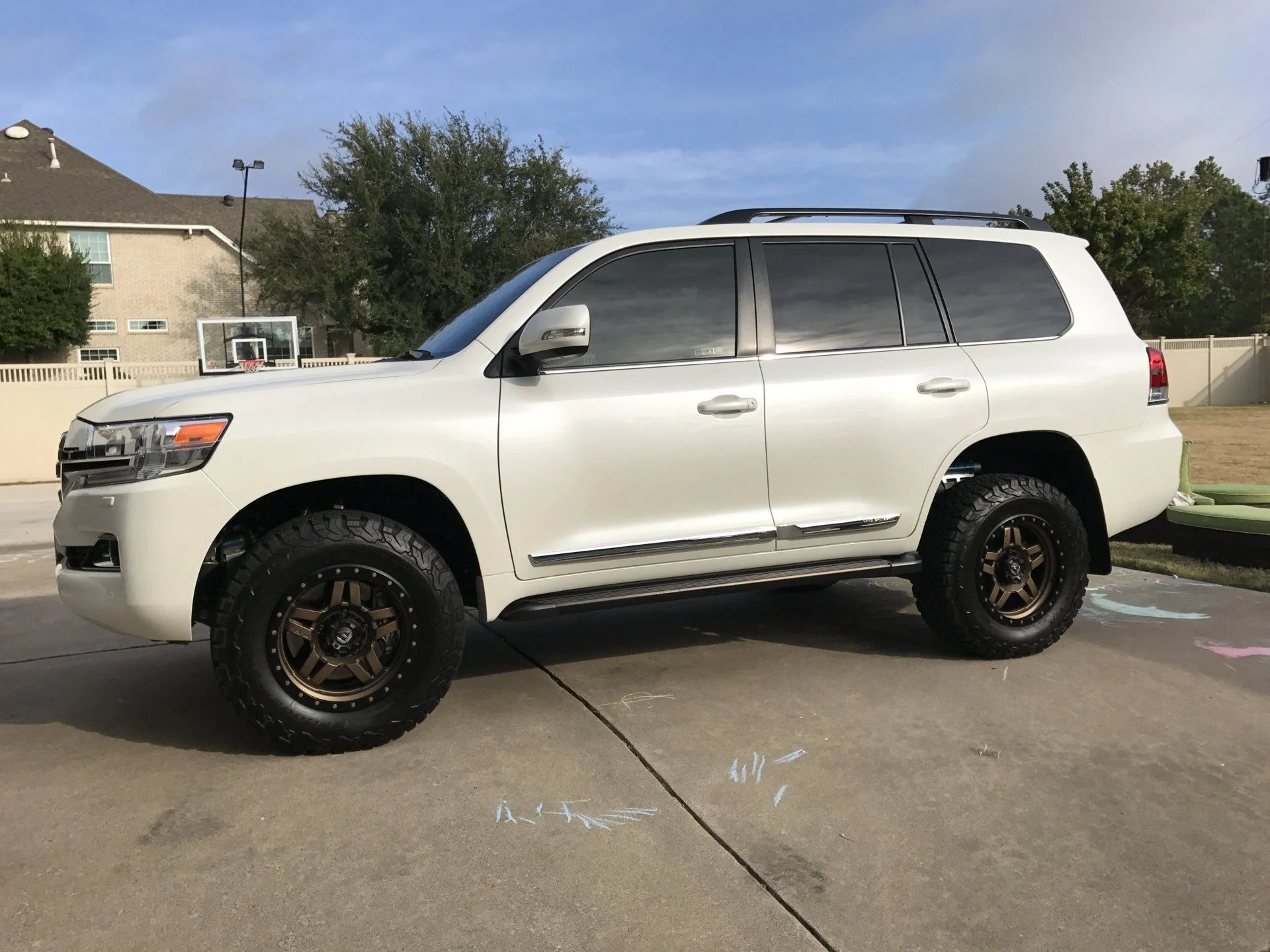

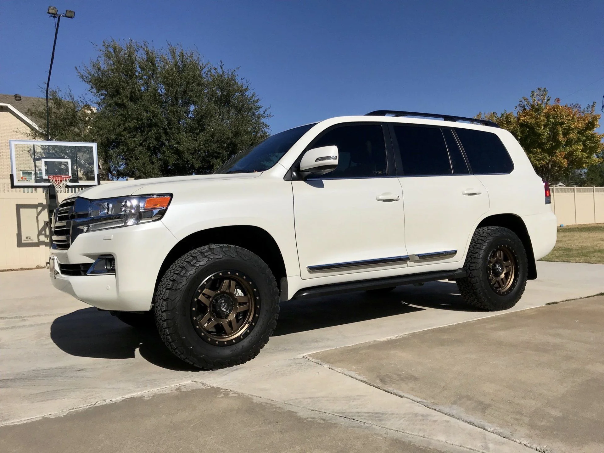

With rear OME springs and spacer.
With factory springs and spacer. Sure I may miss seeing the remote reservoir in the rear but this looks more balanced no? Before it looked like it was on stilts from the rear!

I think it looks the best with factory springs and spacer. But how does it drive? that is the more important question. I personally went with kings front and rear with stock springs (no spacer). Although I left my front coilovers at 1.5 inch lift. My cruiser is about .5 inch taller in the rear. looks and performs great. one day I have a custom spring made that is slightly stiffer but doesn't lift the rear any taller.
I think I am in agreement. Hopefully it doesn’t settle any more. Otherwise the mid ground is to put OME springs back on without spacers.
It will settle with use. If you want to speed the settling process then evenly place a couple hundred pounds in the rear and DD it for a while or just be patient. Nice looking truck!
I actually DON'T want it to settle more as it is almost too low in rear now. Will prob put OME rear springs back without the spacer. I knew this could be trial and error to find the right height.
