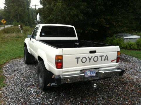

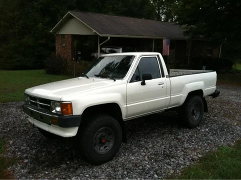

Picked it up yesterday evening, real pleased with it. It's been raining here since I picked it up so I haven't even had a chance to clean all the dust out of all the crooks and crannies yet. Next on the list is to take the bed liner out and have it rhino lined.
Have the rims been painted or powder coated or is it just the lighting in the photo?
I painted them my self with VHT wheel paint, graphite grey.
Looks nice!
