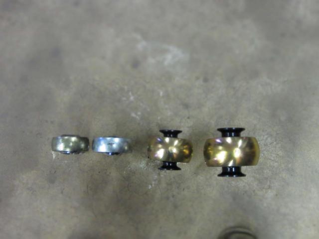

A comparison of some heims joints
Aurora, Trail Gear, EMF large (what I am using) and EMF small Frank (holy s*** these are huge)
