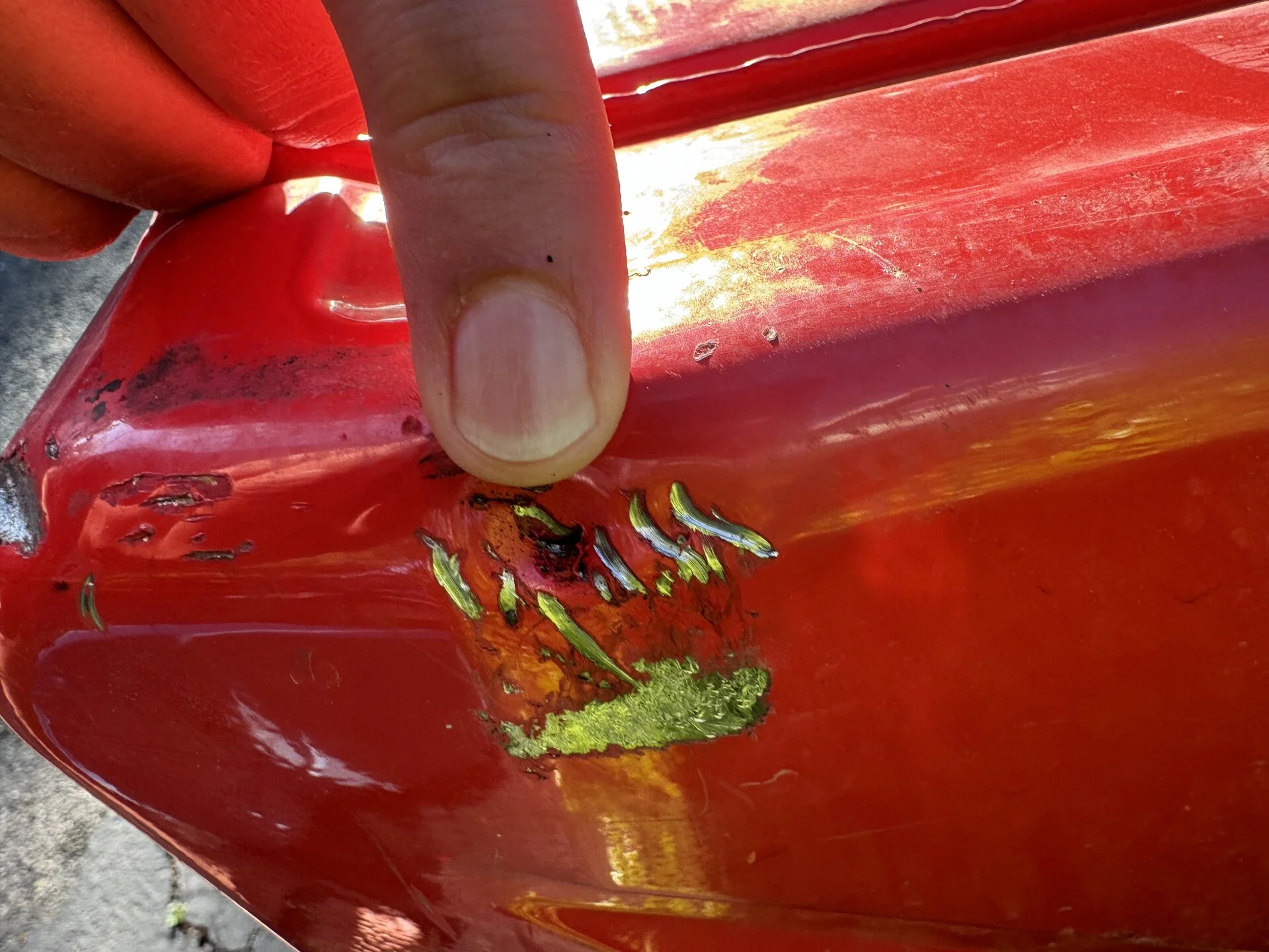

On my most recent the jerry can got a bit “displaced” in the trailer and hit some bolts. I got a small hole, some prominent scratch marks.
It’s a Wavian, so ~100$.
Have someone weld it or throw it away?

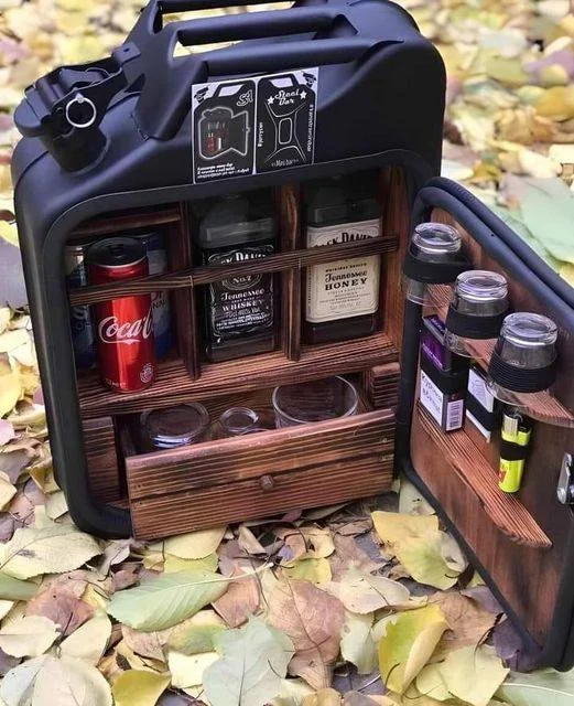

definitely not throw away IMO! If you don't want to fix it (I would), you could turn it into something neat like a hidden toolbox for your truck, or storage of some sort (I store chains in old leaky plastic gas cans).
As to fixing it, it would be easy for a pro, I imagine. Metal looks good. Might be cheap or not depending on where you are, though. Probably not cheap in the Bay area. Don't know what they would charge there. But $30-50 in most "normal" places maybe (wild guess)? Would take all of 5 minutes with a TIG I assume, if you strip it beforehand. But you could also have some fun if you have access to a welder. Or you could maybe even braze it easily enough with a torch. Just aerate well before, obviously.

Oh man! Seen so often and didn't think about it! Yeah, tool box or similar would be a good idea!

I will try to find a local welder, perhaps a neighbor is welding or so...

welding generally would be the choice, if priced reasonably.

Most steel fuel cans (Wavian included) have a “lining” inside to prevent corrosion.
The lining on yours is certainly disrupted now. You don’t want bits of it, nor the corrosion that will be forming soon, to enter your fuel system.
Just my thoughts…
^ It is certainly true that there may be loose bits of lining or rust in cans. Seen plenty. And that would also be exacerbated with welding or brazing. However, not a significant problem really if you use a filter funnel (I always do). A can can also be relined easily enough too.

All of the fuel cans like that which I own are lined with somethingand are not bare steel inside. So after welding I suspect that you're going to have loosened lining in the heated area. I'd look into one of the fuel tank lining products. Caswell's in particular comes highly recommend by one guy that I know and another uses U. S. Standard exclusively (POR-15 product - I don't think it's a Moisture Curing Polyurethane like their other coatings).
