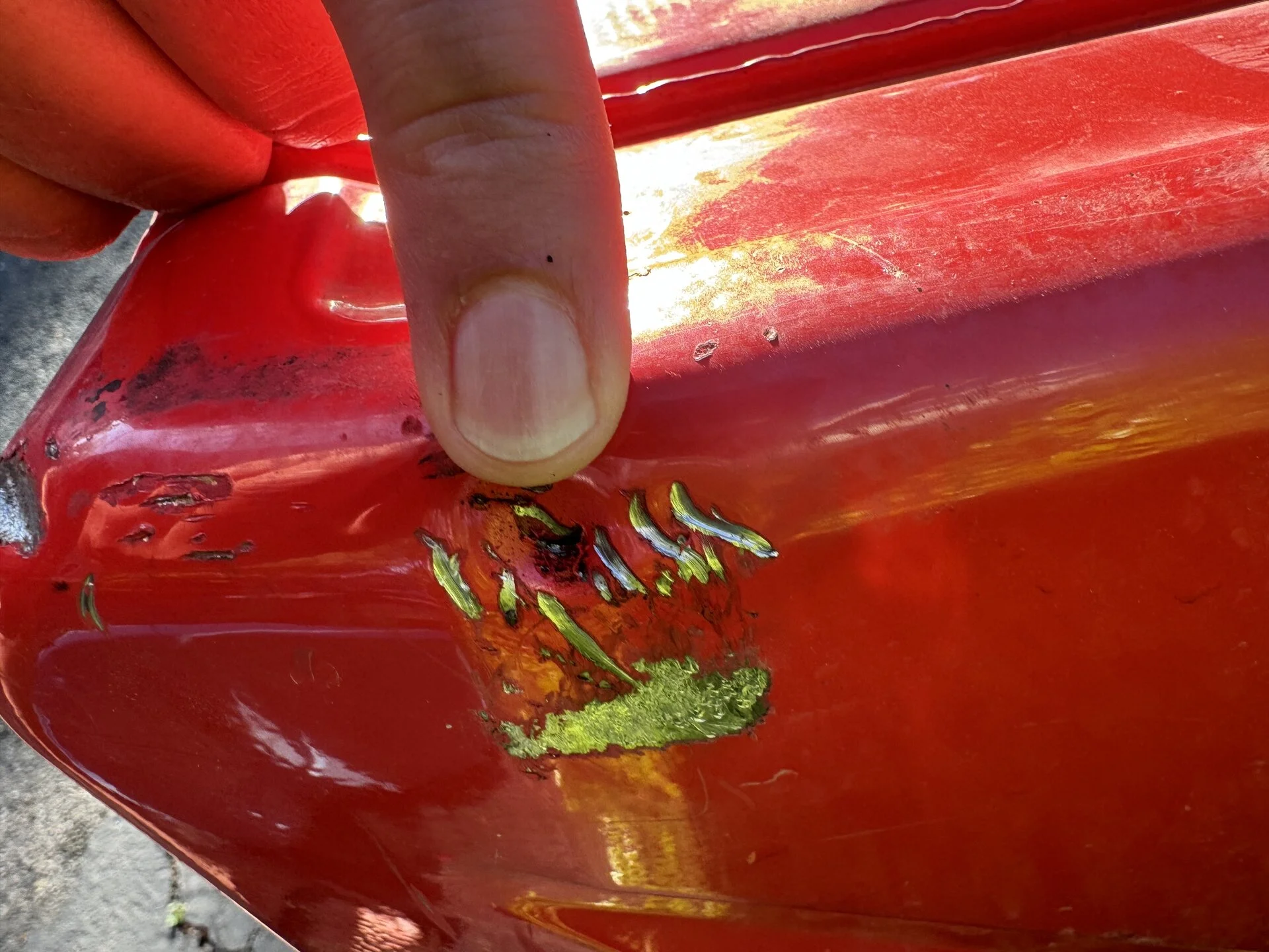

On my most recent the jerry can got a bit “displaced” in the trailer and hit some bolts. I got a small hole, some prominent scratch marks.
It’s a Wavian, so ~100$.
Have someone weld it or throw it away?
Weld Tack from Outside (make sure no Vapors or Puge with Carbon Dioxide) then POR-15 Tank Seal from Inside ($15 ebay)
