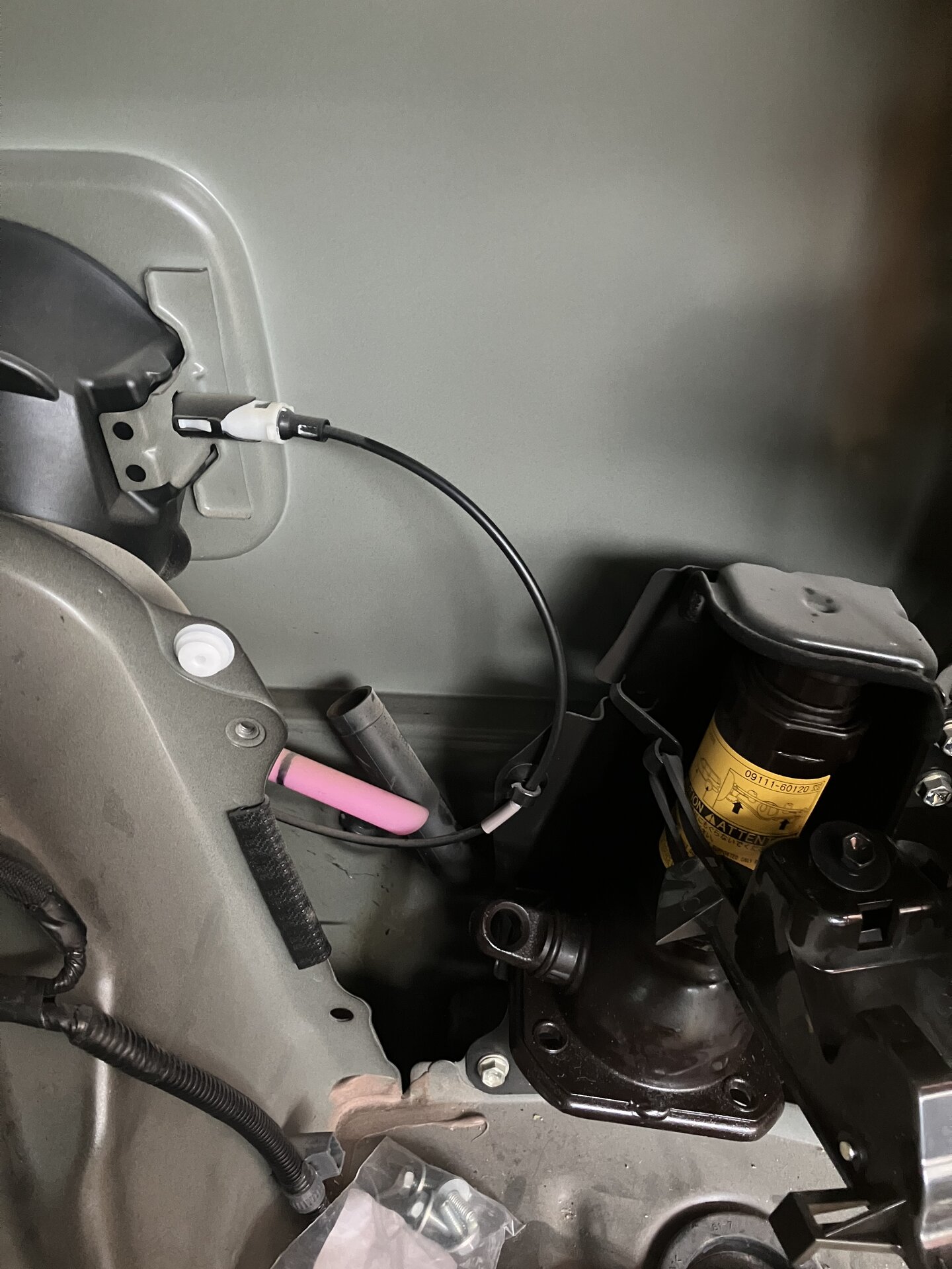

The only pic I have is inconclusive on the pipe. I don't see it though.

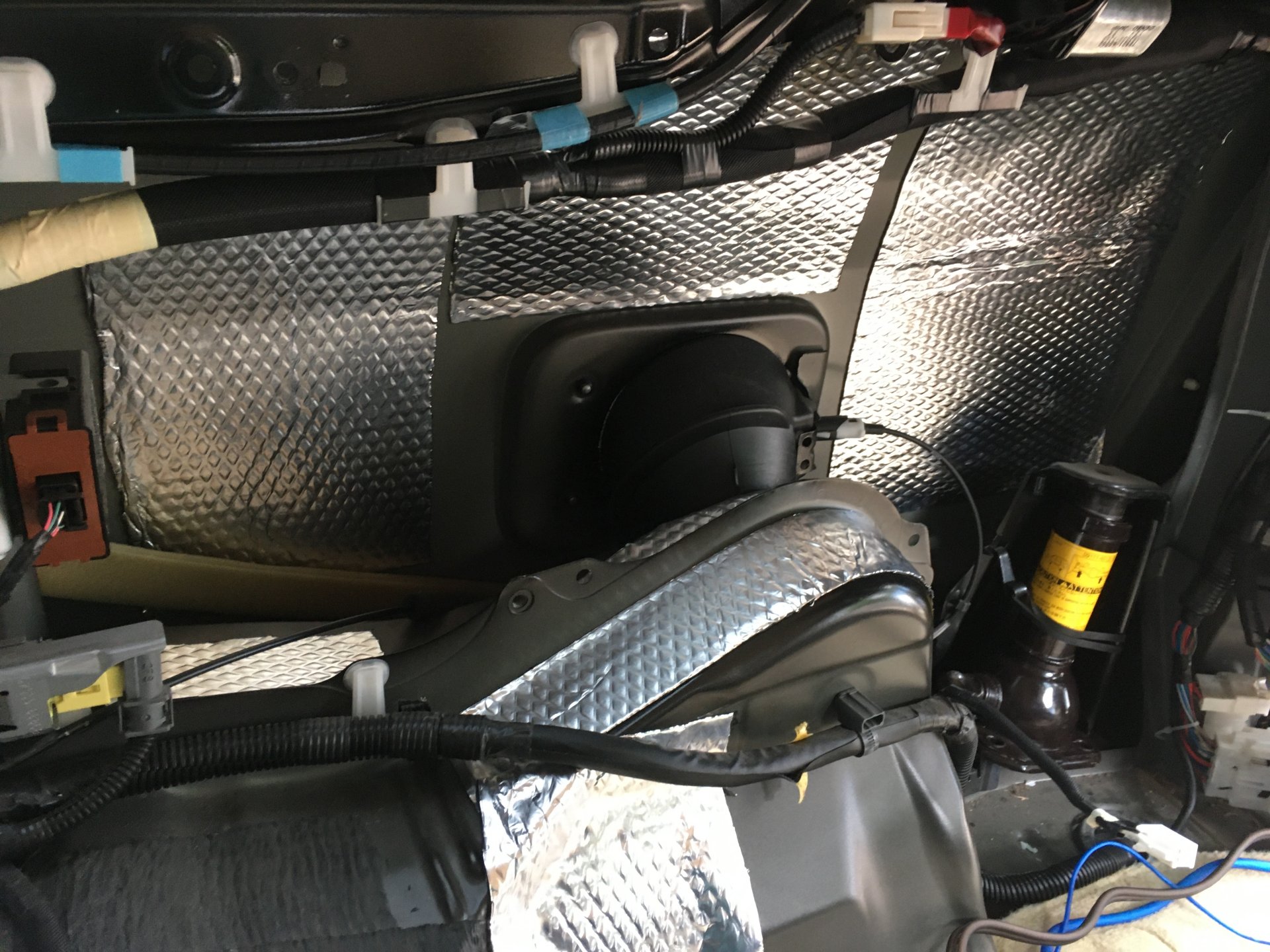

Awesome thanks, I found mine disconnected and Ive had the car for 10+ years and this is the only time i removed the rear side panel to reach the sub
Maybe it seperated while you were taking it apart. I would suspect you'd have quite a bit of water in the rear cabin if it was dislodged, unless you never drive/park in rain.

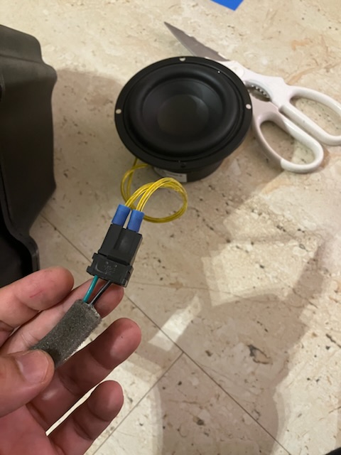

Ok thanks for letting me know, it seems you are experienced in audio. If you were to wire a new "smaller" sub to your LC system, would you reverse the terminals? I just did another test and the OEM sub flexes "inwards" when i send 12v to the positive terminal and outwards to the negative. It just feels wrong and I am unable to distinguish if music sounds better with them reversed or not

If you can’t tell the difference, then it doesn’t matter. Music signal is not a DC current so the battery test doesn’t mean much. The speaker plays just as loud whichever way you wired it, just 180 degrees out of phase. If you wanted to get crazy with it, you’d need a microphone and audio analyzer software and figure out which wiring made for the best signal response. but it goes back to, if you can’t hear a difference, then there isn’t a difference. Honestly, the front woofers probably dominate the bass response now that you have shrunk the woofer so much.

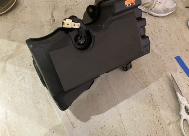

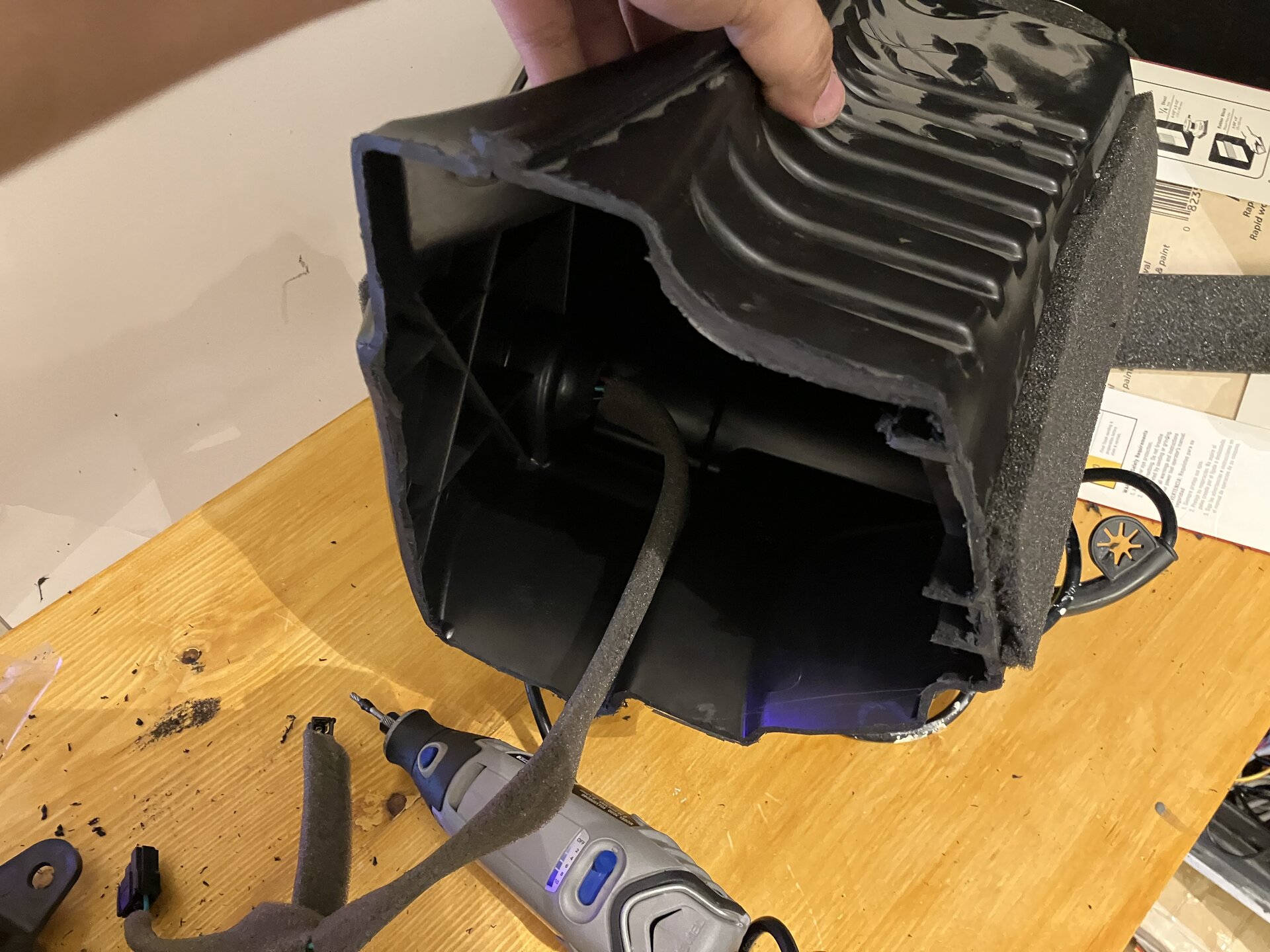

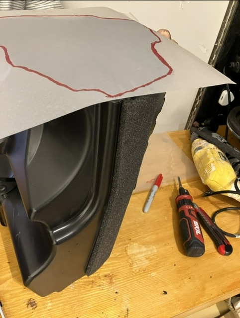

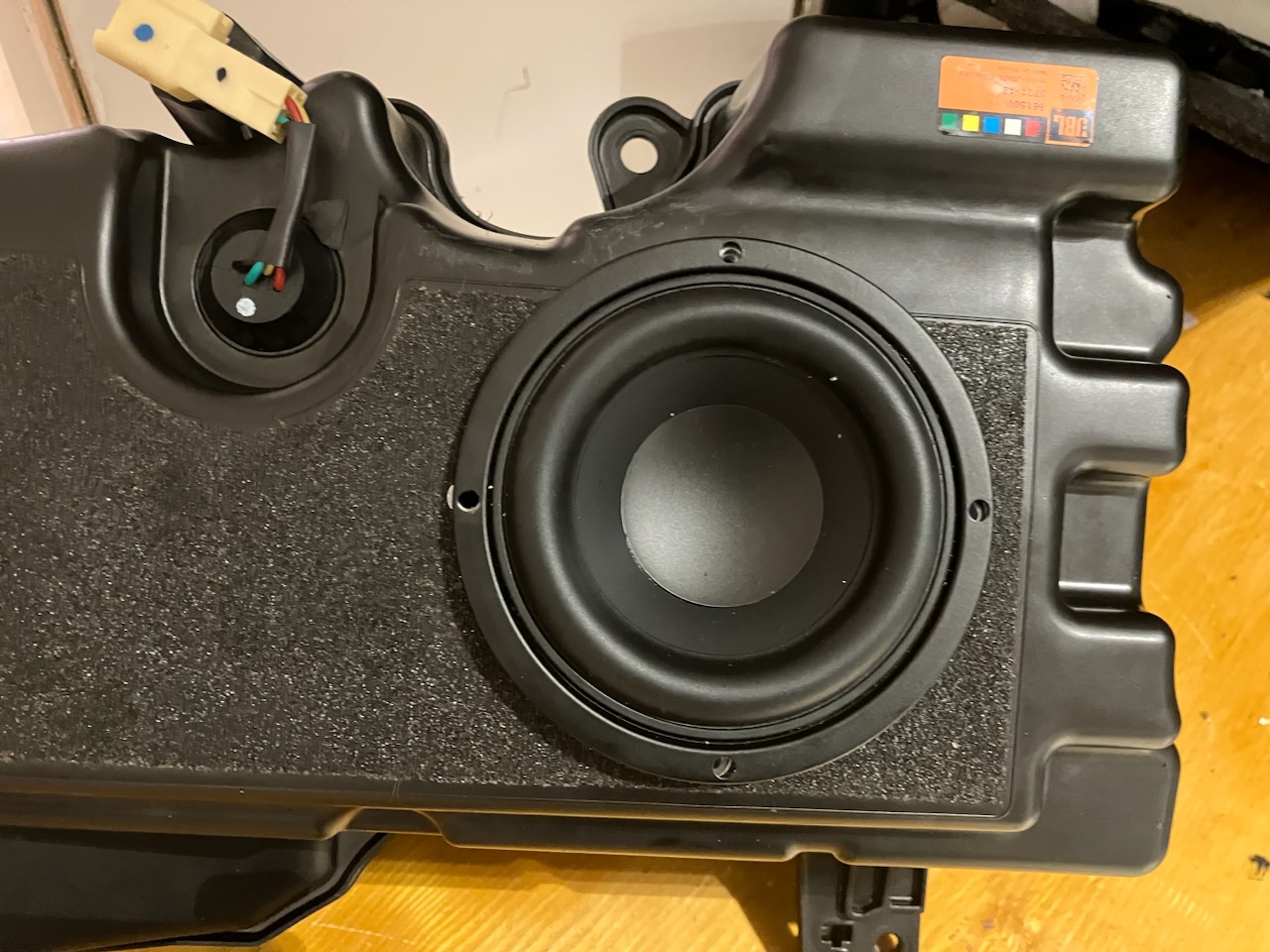

Here are some photos, i managed to close the opening and it went better than expected
Nice work. I don't think i saw what model subwoofer you bought. But now that you have 2 that might give you some flexibility in the way you wire them so that you get a better impedance match with what the OEM sub was.

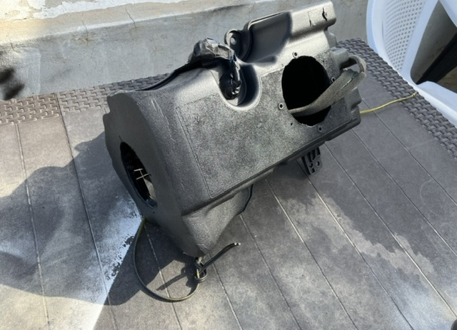

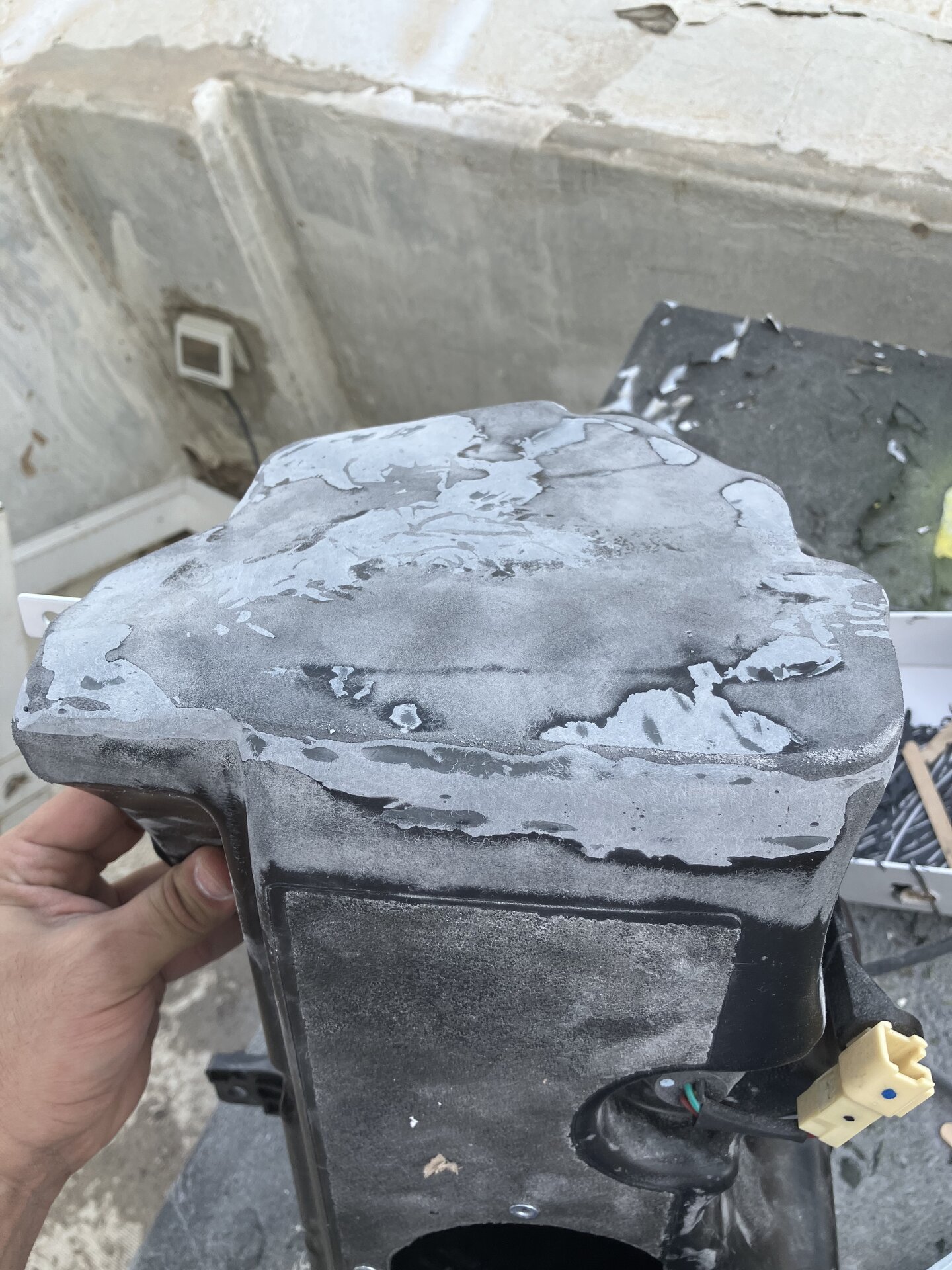

More updates...painted, second sub hole, added an extra mounting tab, wiring + some padding

I suggest mounting the two separate woofers in phase with each other (so they are on the same downstroke/upstroke together). For the phase with the rest of the system, try both ways and see which is better.
Do you suggest I have one reversed and the other following the standard? Or it’s best to have both connected the same way whether inverted or not?
Like @grinchy says, definitely in phase with each other.,. and like he said, wouldn’t be a bad idea retest which phase as a unit sounds better since you probably increased the overall volume.
Are you wiring the speakers in series or parallel? If you could get to a 2ohm load that would probably be ideal. If your speakers are 4ohm you will want to wire them in parallel and that will give you 2ohm.
