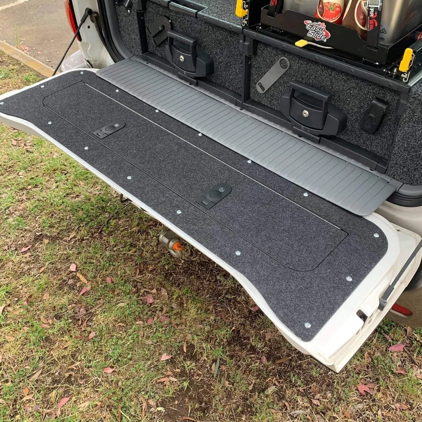

So my tailgate/lower hatch is stuck closed & won't release on the left hand side. Right side is fine. I can hear a click on the left, but it gives no play at all. Similar click on the right, but I can get about an inch of movement. I have tried the 80 series trick of moving lever forward, and that didn't work.
I have both Kiss drawers and a HFab tailgate storage making access to the cables almost impossible. The stock photo shows an open tailgate, but should help the imagination envision why I have access issues with one that is closed. Looking for any hints before I need to disassemble my very full drawers from above...

It is this (thanks borescope). Now I need to fashion a tool to get in there and hold the cable housing collar through a very tight opening.
