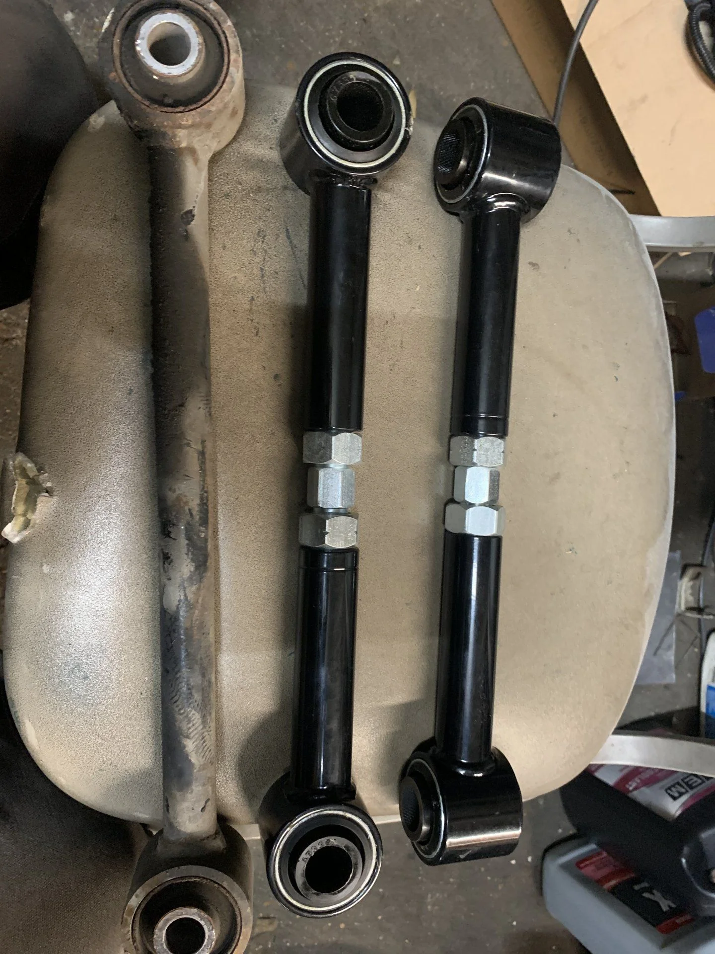

Slee upper control arms shipping today.

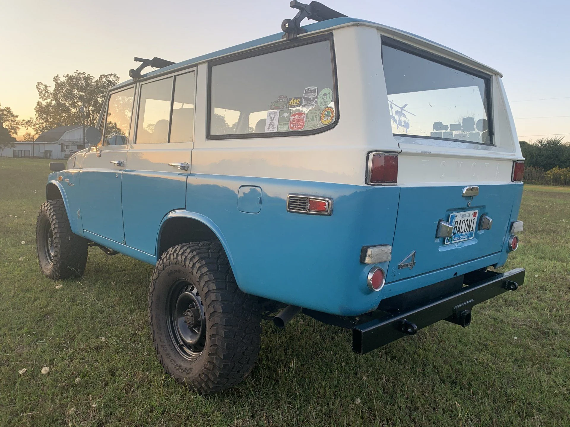

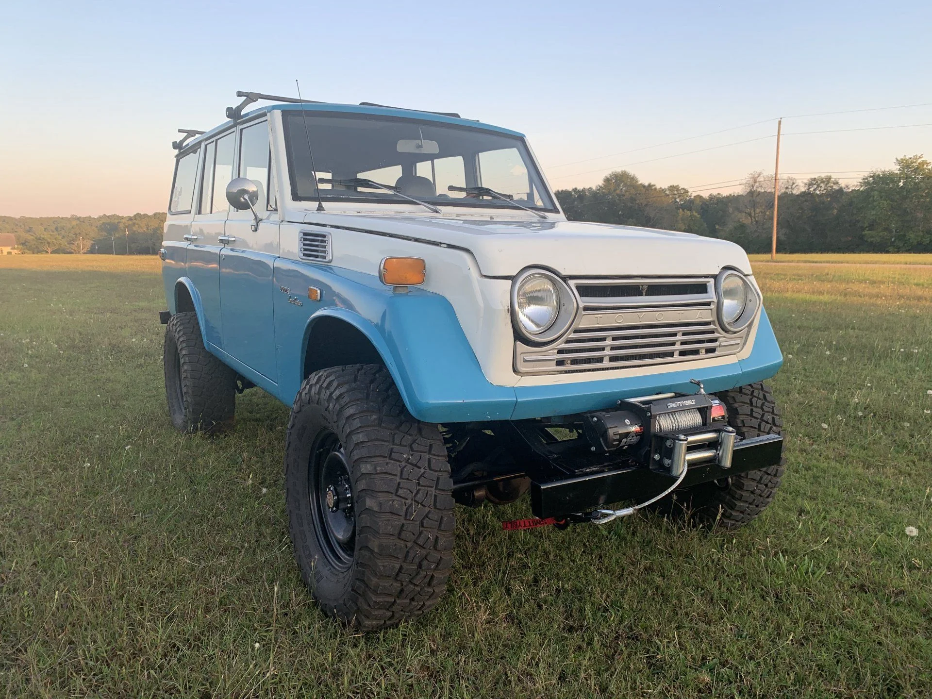

Photo shoot for insurance company.
You should send them one of your super flexy drainage ditch photos to show them how hardcore you are!
Insurance companies are just like chicks they really dig the super hardcore overland guys.
Grundy wanted pics to get the agreed upon value. Dick.
....the guy on the phone did sound cute....

-is it worth getting adjustable rear upper control arms to play with pinion angle? $$

Adjustable rear uppers rotated the pinion down and she’s good to go! Whoo hoooo!

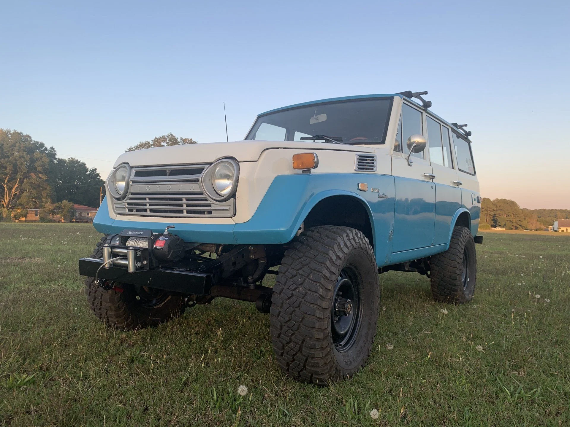

The FJ55 will always rule over new Jeeps in coolness and exotic factor, but the 4 door JK’s are a pretty sweet platform with a huge aftermarket, making them a pretty decent choice for a newer wheeler.
Part of the inspiration for the build I’m doing, besides all the great builds on this forum, is to make something that stands out from that JK crowd, on a vintage platform that was built rather than bought.
