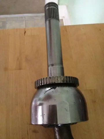

Not much got accomplished today. Got the ABS tone ring off of the old birf and tore down the hub and pulled the new axle. Nearly got the tone ring onto the new birf but just don't have the material here to make it happen. Gonna run it over to Fleet Pride in the morning and have them press it on real quick for me. This is turning into a bit of a marathon, but I don't mind. Really don't have much else going on anyhow. The idea is to get the passenger side all out back together, for good this time, and disassemble to driver side and start cleaning parts. Hoping to have everything back together by Saturday. Also, my DS's should be ready to pick up tomorrow.
Got some things done this morning. Found out that one of my DS's was out of phase pretty badly. It'll need to be cut and rewelded in order to get it re-phased and balanced properly. The good news is that they over quoted me originally on the price. So it'll all even out now with the extra welding that they need to do. Also took my Longfield in and had them press the ABS tone ring on for me. Only took them about 30 seconds and didn't charge me a dime. Thought that was pretty awesome. Time to get the passenger side buttoned back up, again, and start tear down of driver side. Waiting on the exterminator to show up and take care of these pesky sugar ants first. Then it's off to the garage.
ABS tone ring loose on old birfield.
ABS tone ring.
And on the new Longfield.
BOOM!!! They look brand new. Price was a lot more generous than expected. Highly recommend these guys.
