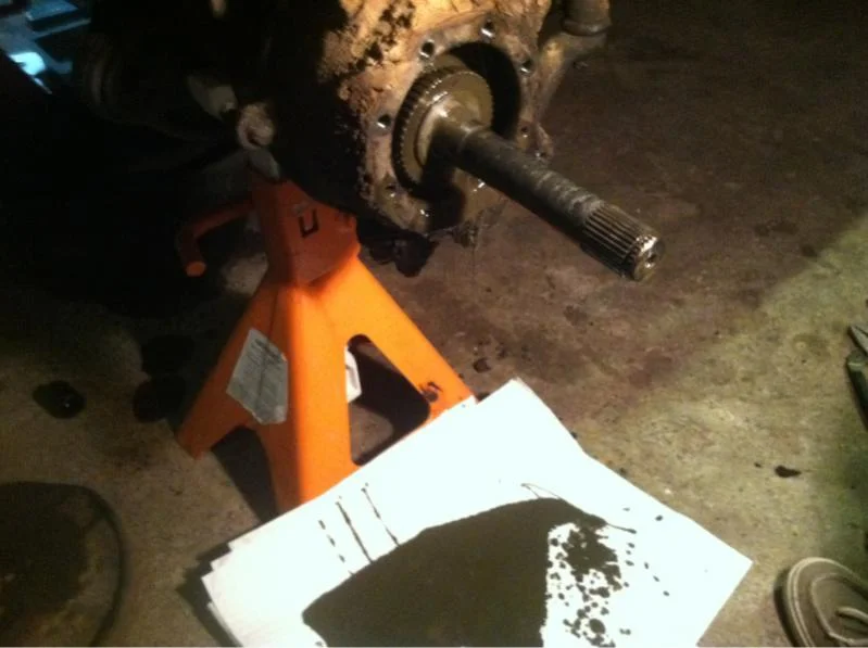

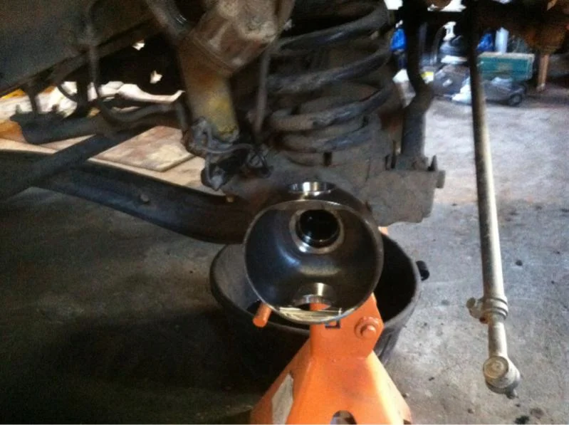

Round two is complete... William and I knocked out both sides of mine in an evening. We started around 5, stopped for dinner and his birthday cake, then worked until almost 1. We ran into a few hiccups and I'll definitely need new birfields here eventually, but overall it went pretty well.
It feels great knowing its done!

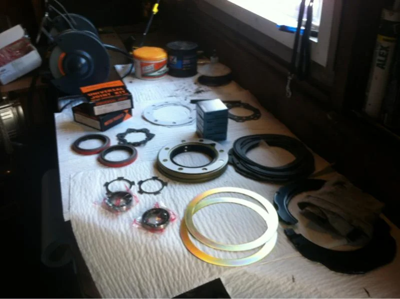

My neglected knuckles and such:

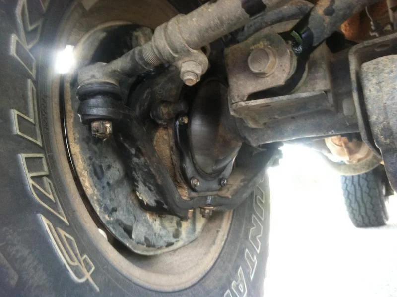

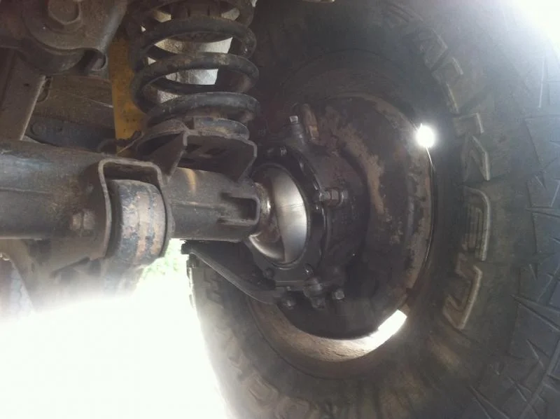

Morning after pics... my first time seeing the job in the daylight.
Obviously we didn't get super zealous with the cleaning of outside bits, but the before/after is amazing.

Did you and William pull apart the birfs and repack/inspect them? What was the evidence that gave the thought for replacing them (did I miss them in the pics)? I know my wheel bearings are due for grease, got the wobble/vibration happening.
For my birfs, they came packed from Longfields so didn't have to do much there. Mike plans on replacing his axles here pretty soon so we gave them a quick once over. Had to repack the long side because it was full of gear oil. The main objective on Mike's was to replace the oil seal that was leaking. I think this summer when he has more time, he plans on getting back in there and doing an axle replacement.
Ah, forgot that you replaced the birfs with Longs. (I remember reading it now).
I was curious to Mikes as to what lead to the thought/decision to revisit and replace. Scoring, worn out races, just because.... if there were pictures for reference. I don't know what to expect when I tackle mine, the front and rear.

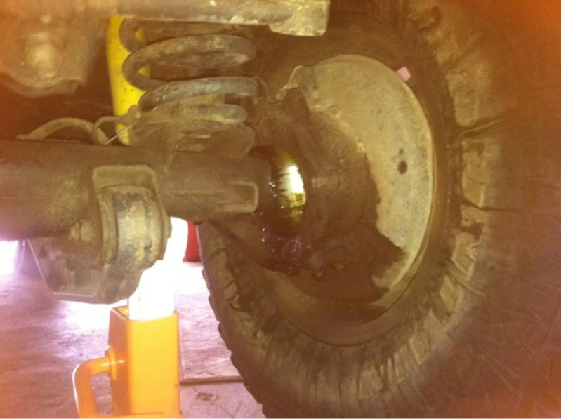

His driver side oil seal was bad. Knuckle was full of 90W. It was leaking everywhere. Figured while we were in there might as well rebuild it.

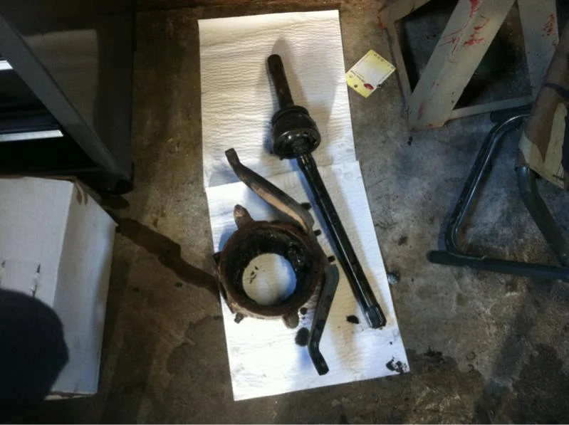

No worries. He does plan on replacing his axles. His vehicle has nearly 300K on it and it looked as though the service we did to the axles was the first since leaving the factory. The outer grooves on his PS axle where the drive flange goes, were rusted and pitted pretty badly. Both Birfs were were worn and pretty loose.

Interestingly enough, my passenger side oil seal was in good shape and as such the knuckle itself was free from 90W intrusion. Instead, it was obvious that it had been run without enough grease and/or with some water ingress. The result was a lot of corrosion on the outer axle shaft (as William mentioned) and on various surfaces in the steering knuckle and on the spindle.
My drivers side, where the axle seal failed, was full of nasty "birf soup" but all of the components were in great shape with minimal corrosion.
My inner shafts were in great shape. We didn't break the birfs apart, which was an easy decision based on the corrosion on the outer splines of the outer shafts. I didn't have anything else to replace them with and it needed to go back together, so I shoved new moly in the birf after spraying it out with brake cleaner and hitting it with the air nozzle.
