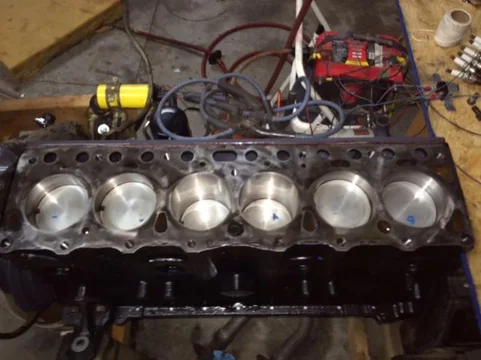

After over 9 months of meticulously building this motor, Ramon had his first start and break-in last night!!! Had a hiccup at first where the dizzy was a tooth off when we thought it was right, but Ramon figured it out :D

Now, it's off w/ the 2F head, on w/ the 3FE head and MegaSquirt bits. This is where it gets fun :D

Congrats guys!! It is always a great feeling when you bring a rebuild to life. I did the same 1 tooth off thing when I did thee front end of the 22RE IN MY 4RNR. It started but was sad. Same as you, I figured it out while playing with the timing and once moved it ran great.

3fE head going on tomorrow, assuming head gasket comes in.

LOTS of tuning to do. Trying first to figure out how the motor gets enough air thorough only the IAC valve with the throttle plate completely closed at idle. I have to leave the brake booster port open to get enough air in to keep it running.
I'll say this though, this is getting fun. Figuring out the signaling of the dizzy and how the ECU controls timing and fuel. It's pretty dope.
