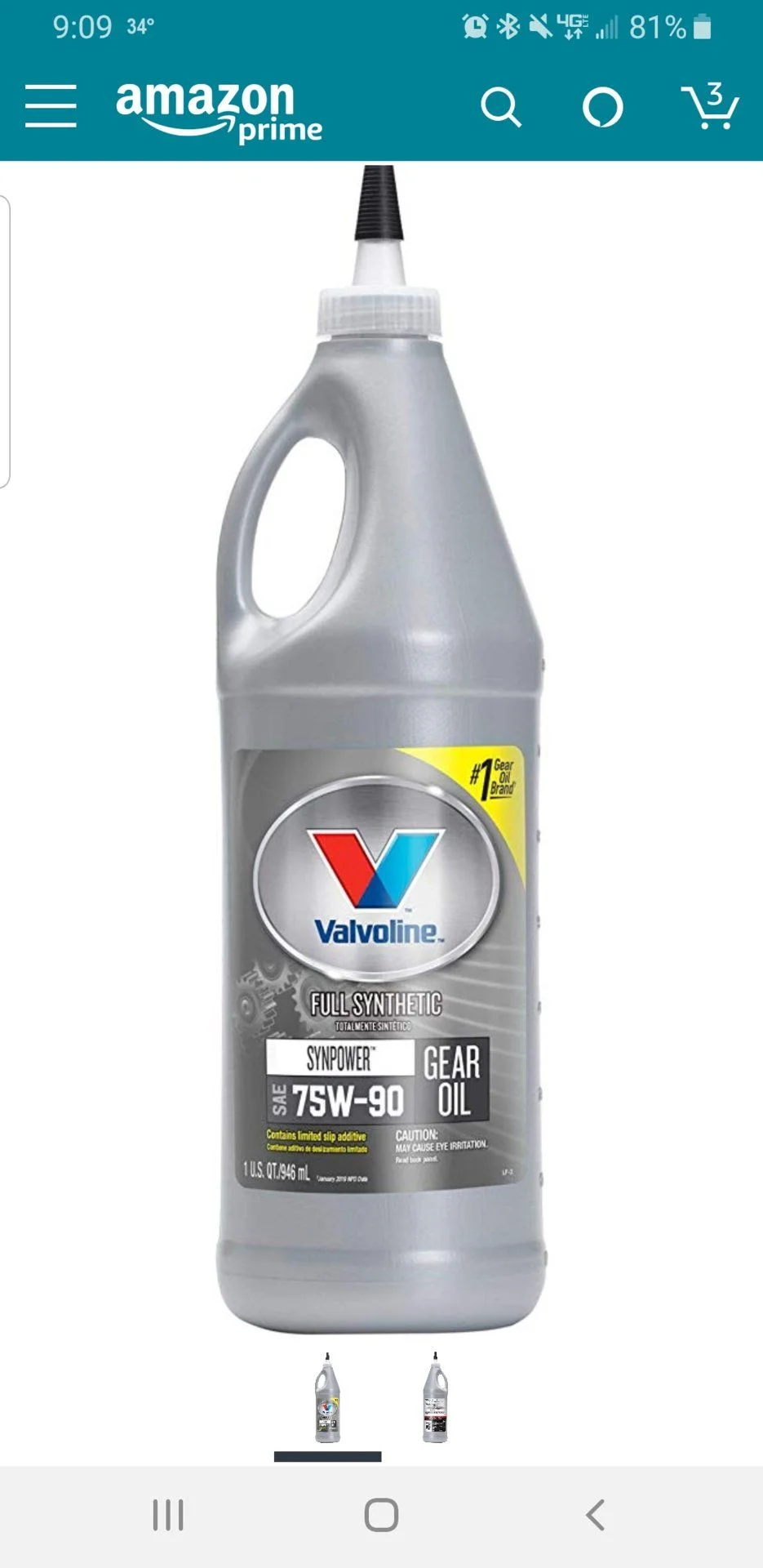

Is this gear oil ok for my gx470?
Dec 17, 2019
13
53
Kentucky
I have a box of this gear oil but unsure from my search if I'm ok to use it in front, rear and center diffs since it has LSD additive. Thoughts?
The Mobil1, that many of us are using, is rated for use in limited slip applications. Although it does not say it contains limited slip friction modifier.
100% fine...good in LS applications if you have one...does not mean it's incompatible if you don't.
