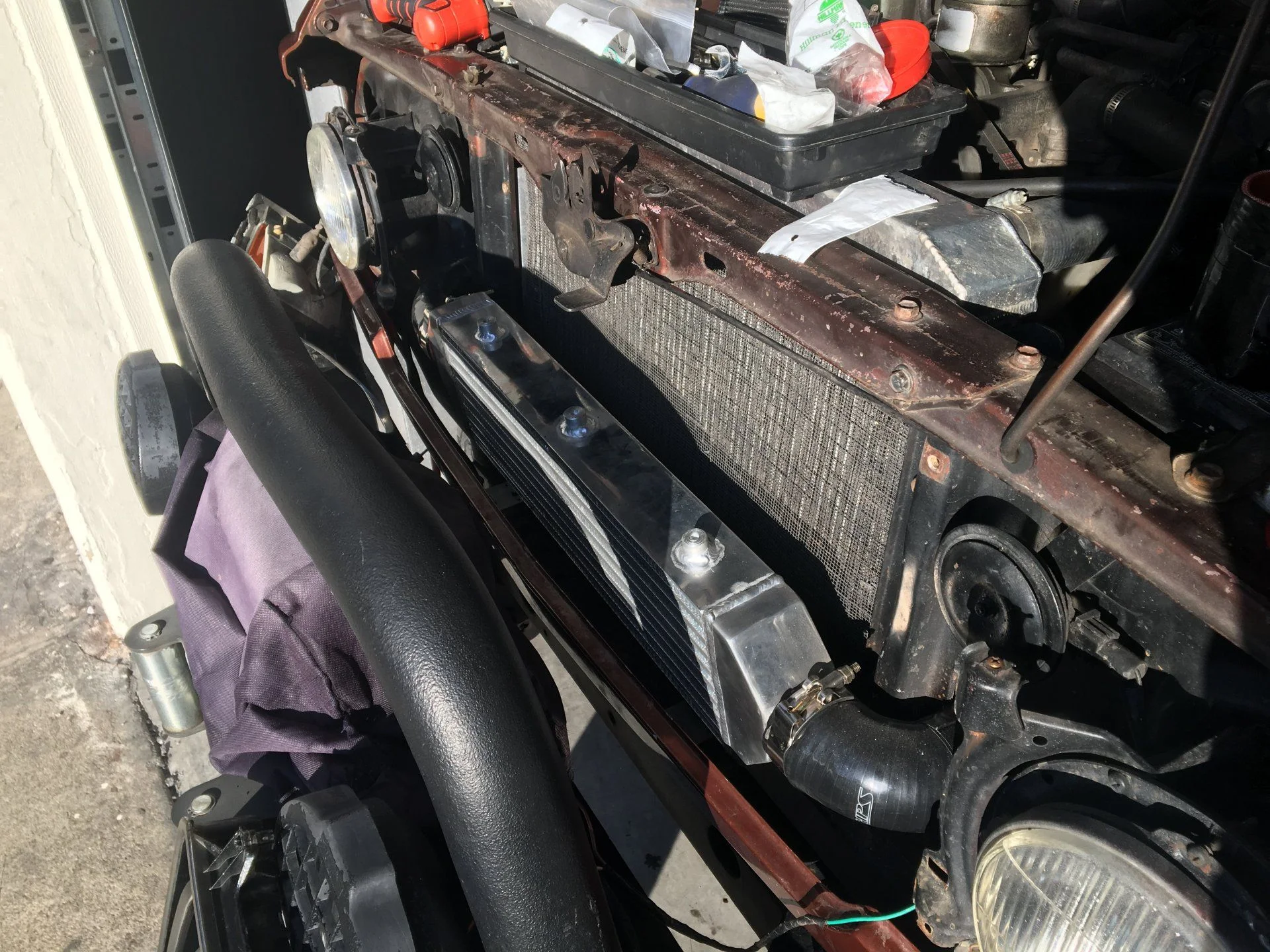

Is my 3B intercooler project a failure?
Everything just fits so far.....
I have a cast aluminum elbow for intake manifold. ..

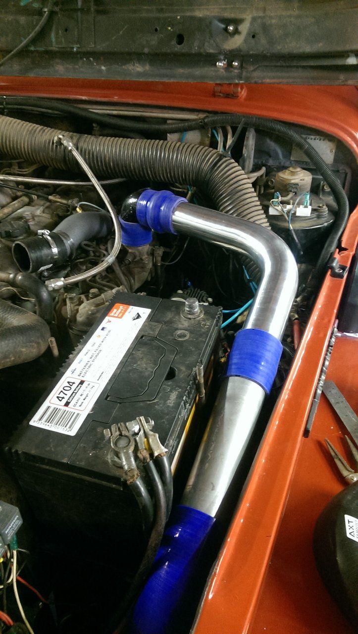

Finished today....
Looks like i get about 1psi drop across intercooler which is much better than before....
For anyone interested i used a 75degree bend out of intercooler cold side. I found this the besg way to navigate around headlight. I used another 75degree to bend past battery and on to cast aluminum elbow.
both bends on hot side are 90degree. Pipe clears shock tower by 5mm...

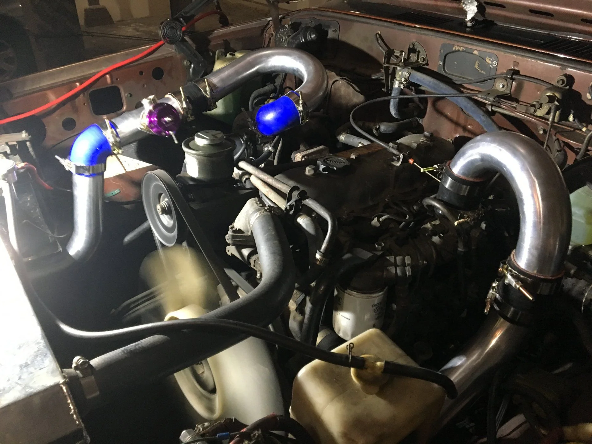

I would try to lose that j bend coming right out of the turbo
It looks like you could rotate the blue coupler 90 deg
Towards front of truck and come almost straight into it from your blow off valve
You could also clock the compressor housing
So it points down or to the side if you need to clear ps pump
Every turn cost you flow and pressure
Yeah, good point but I get really close to power steering pump reservoir and I thought I needed to intall the BOV that came in the kit (which I found out by reading in the forum that most people don't think so). So, I'll eventually remove the BOV and the T-coupler that comes with it and run the pipe straight forward.

Thanks, Tin basher. I appreciate the advice. While we're at it: can you tell me where to run the vacuum line too? Also, do I need to screw something onto the big outlet (it has a thread on it which made me wonder). Thanks a bunch!
The big threaded port I'm assuming
Is the dump you could freed it back into your air filter to silence it or not worry about it
The vacuums line should go to a fitting on the engine side of the throttle plate
