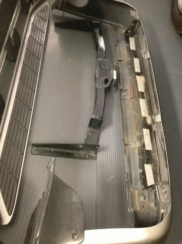

Removing bumper (cover) is easy.....15 to 30 minute job. Couple screws behind rear wheels/mud flap area and some bolts underneath at the rear. Just crawl under and look. For me, it was obvious what needed to be unscrewed/unbolted to remove the bumper (cover).
As for hammering out dents......no idea. Refer to pic below to see what you'll be contending with once removed (light metal supports and bracing).
