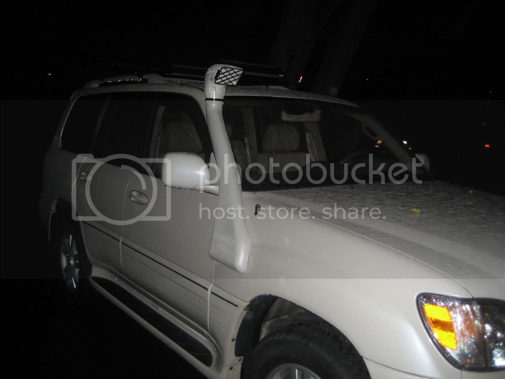

Despite what you've read, this snorkel can be installed while having a functional power antenna by making minor modifications. I highly recommend cutting the largest hole (the oval) in the fender first. By doing this, it gives allows you more margin for error that you won't have if you drill any of the other holes first.

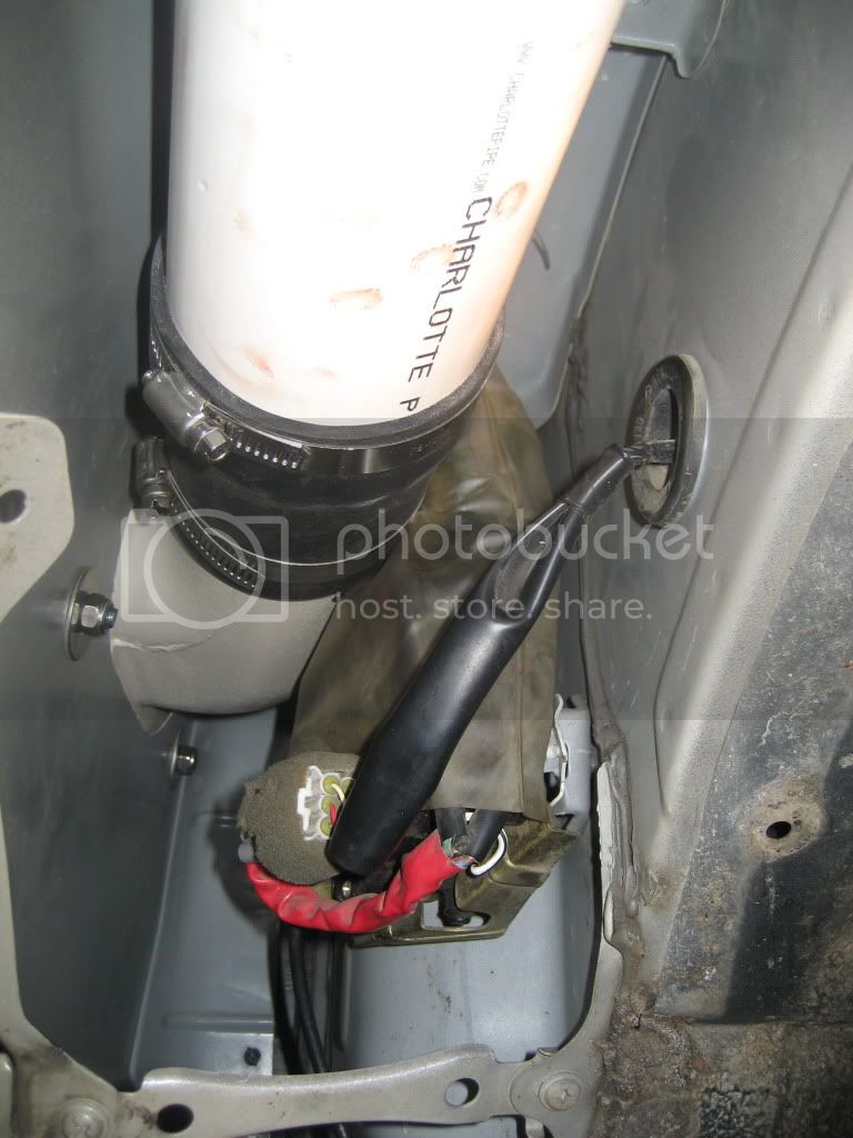

The power antenna bracket here
needs to be unscrewed, then cut/bent. Unfortunately i don't have a picture of what this looks like before i put the snorkel on the fender. You'll have to get the idea from a picture below. Now it is free enough to be moved around enough to be able to get the snorkel fitted to the fender. Without doing this, the snorkel will not even fit into the oval hole that you cut into the fender.
The template that came with the snorkel isn't great. I found that the big hole was the most accurate. With that said, take the template, cut out the oval in the template, and lay it on the backside of the snorkel. You'll find that the three holes (representing where the snorkel is mounted to the fender) do not line up. WTH!!! I found myself going back and forth between laying the template on the snorkel and on the fender just to make sure i knew where/how the alignment of the snorkel and the A-pillar would be. (If you don't drill the mounting holes properly, you may wind up enlarging them to get them to align with the snorkel or worse yet, to get the snorkel to lie properly with the a-pillar) Once you get it right, cut the proper placement of the mounting holes in the template, and then transfer it to your fender.
Now you have the snorkel on the fender, you placed the screws in, drilled the a-pillar, painted/deburred the holes you've made. You need to connect the snorkel.

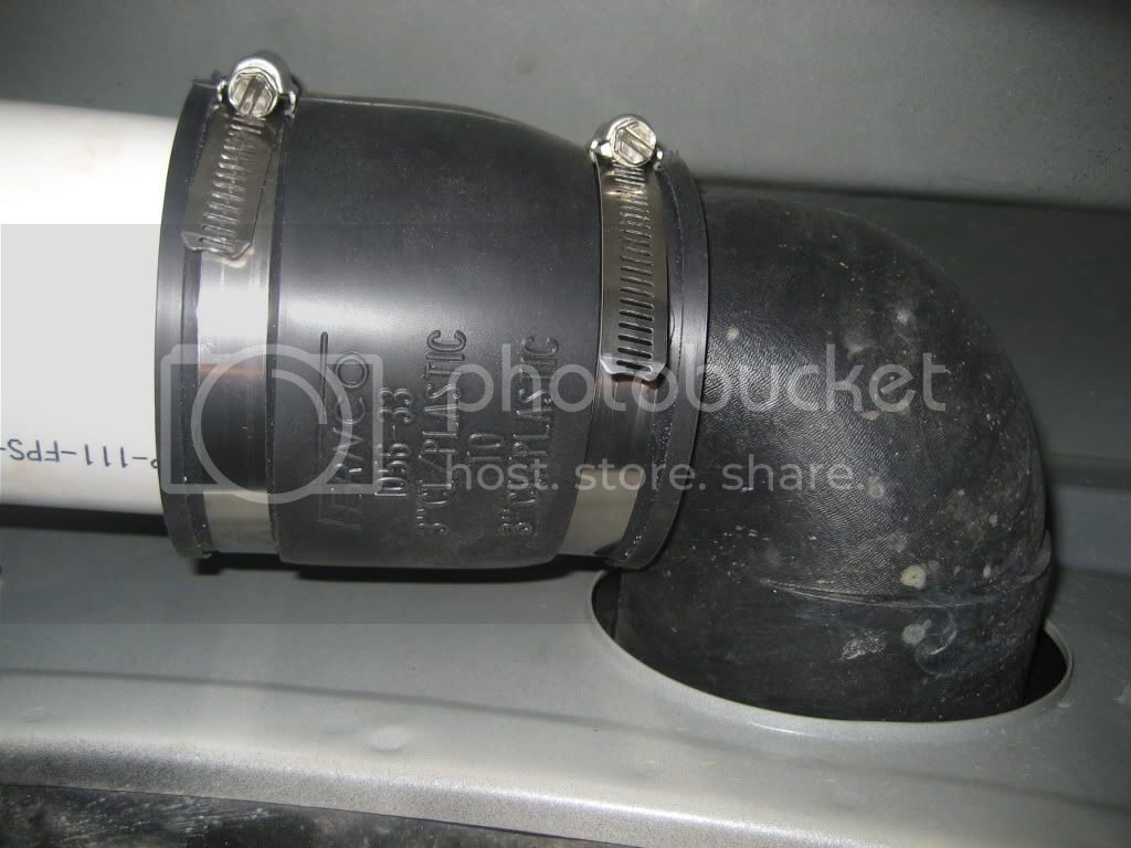

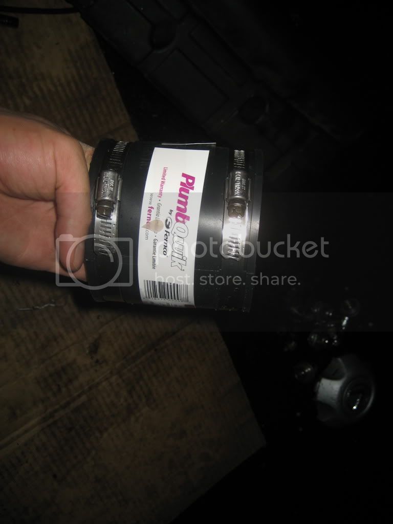

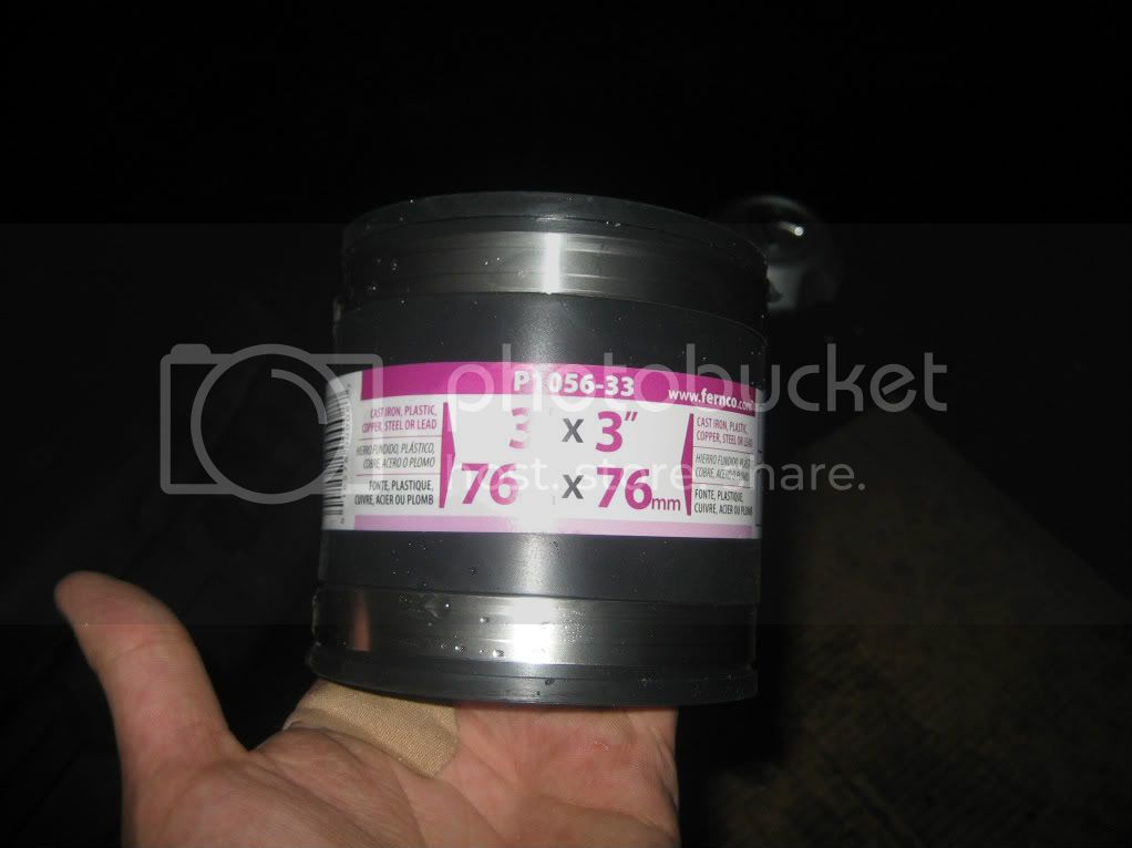

I went to homedepot and purchased a 3" diameter pvc pipe, (length of the stock under fender intake tube), one hose clamp, and one rubber pipe coupler. Here are the pics:
The only reason i used a pvc pipe was because i did not feel comfortable with the connection of the stock under fender intake tube to the bend that goes to the airbox. I think the rest of the pics speak for themselves.
With the way the antenna is positioned between snorkel and the inner fender, I did not feel it was necessary to fasten it to anything. It's snug and not going anywhere.

FYI. I tried this mod. My antenna drive created too much interference. I had tO remove mounting brackets from antenna drive and inner fender well. The antenna is now functioning, but I would not recommend this to others. On the positive side, Iwas able tom retain the factory airtube.
