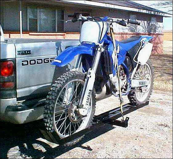

Am I completely stupid to put a motorcycle carrier on it like the one depicted below then load up a CRF450X onto it? I feel stupid doing it, just wondering what the general consensus is. Maybe others have done it and its fine...
Please advise.

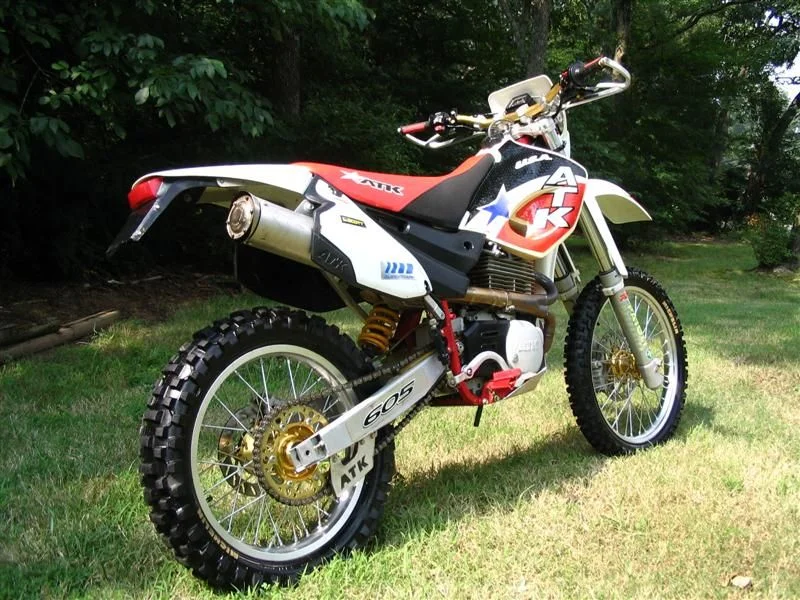

I had one that i used to carry my ATK 605 on. My bike weighed about 280lbs.

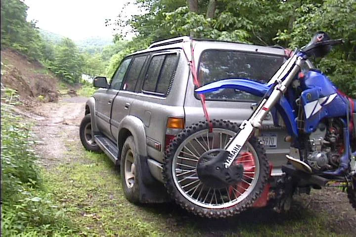

Here's mine. Stock springs and garbage PO tires on it - it squatted and felt awful. I was going to get rear airbags but then I stumbled upon the Bridgestone Revos and the difference was night and day.
