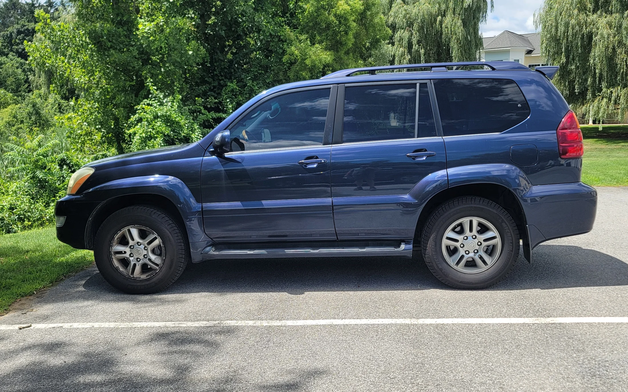

Anyways, here she is on the day I picked it up:

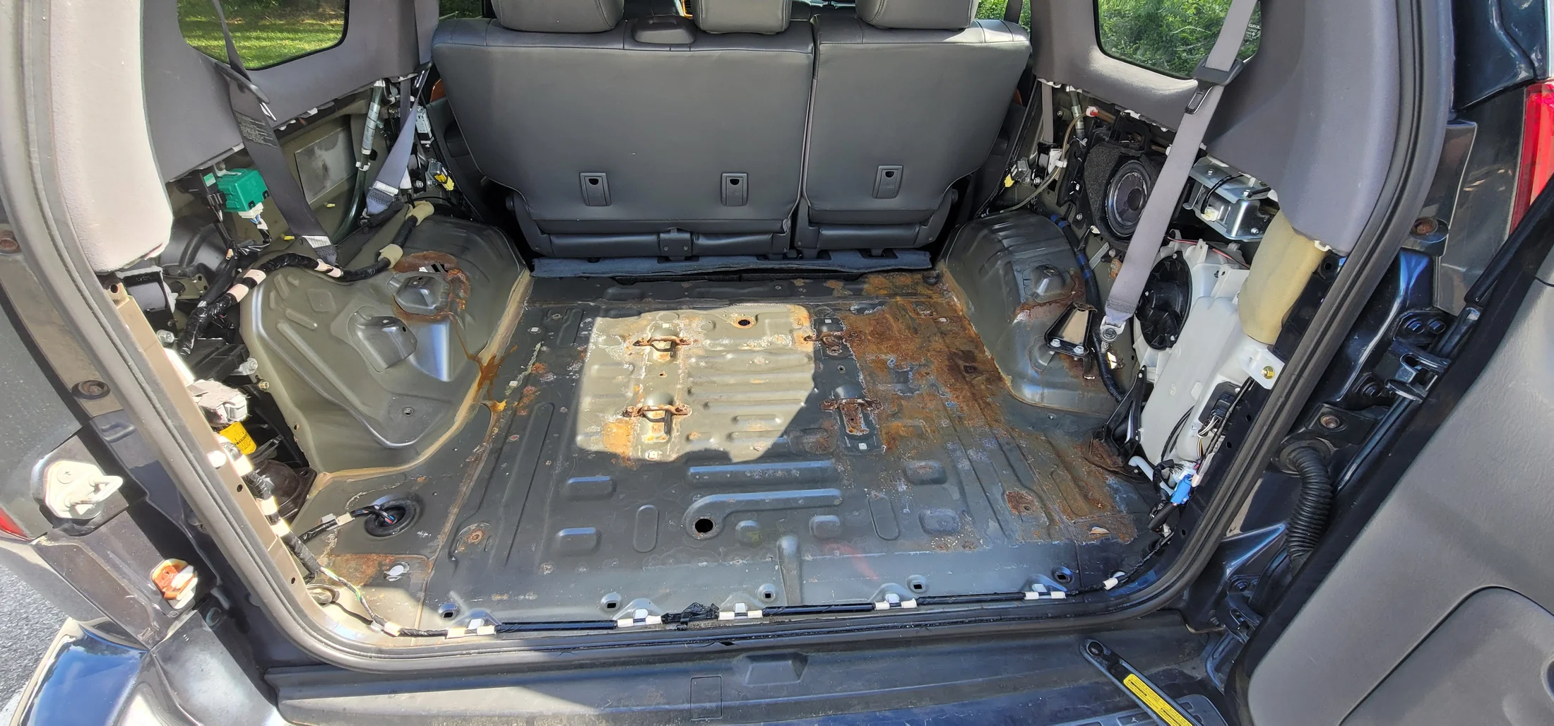

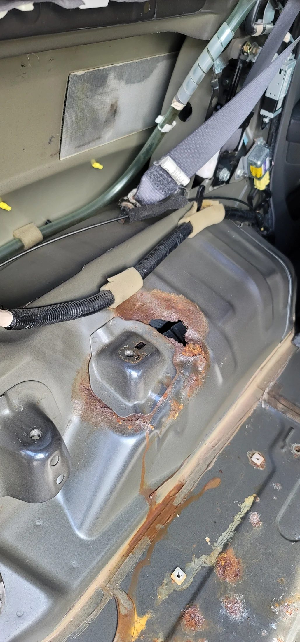

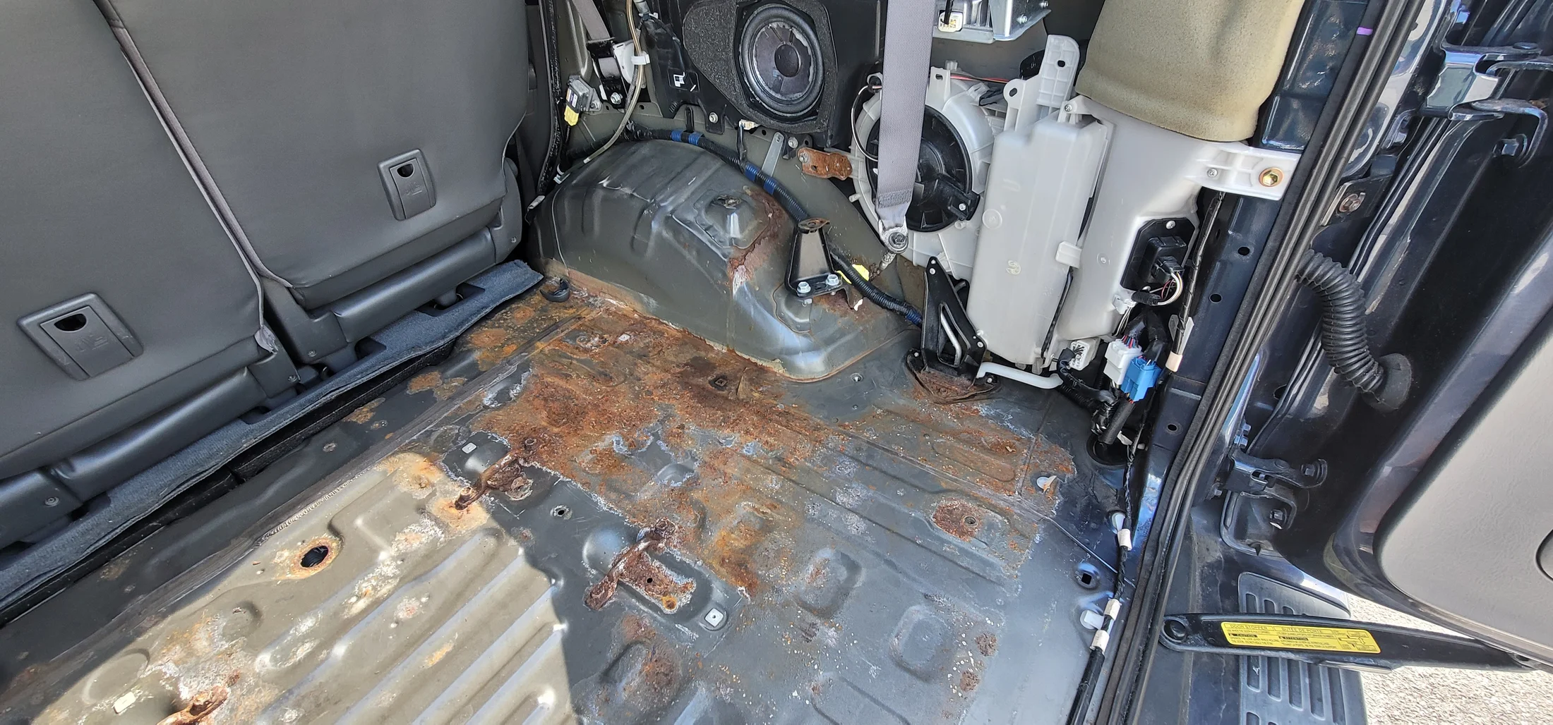

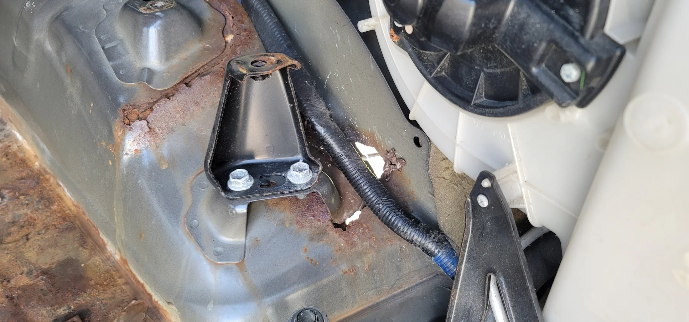

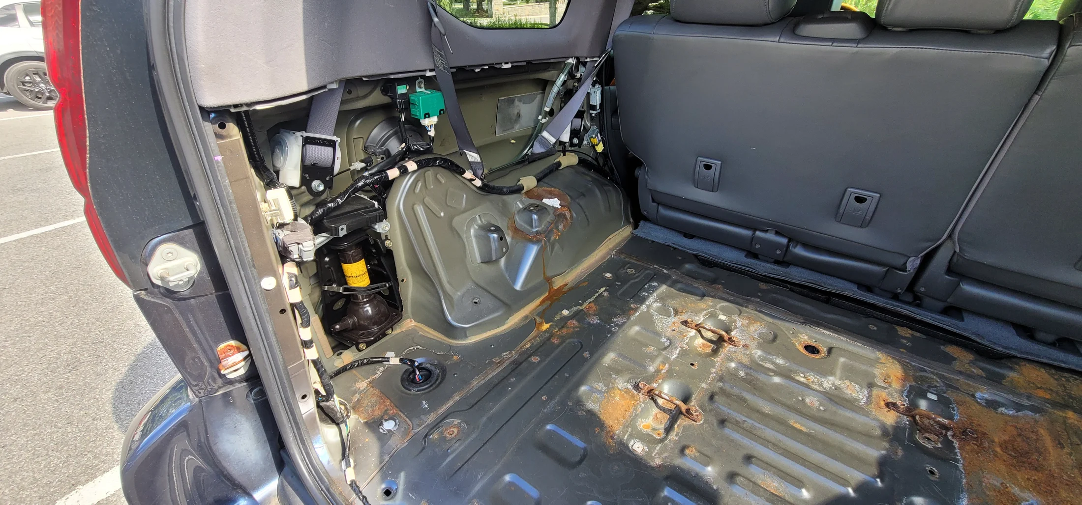

The day I arrived home with the vehicle, I started a more thorough investigation with the rusted areas and here is what I found:

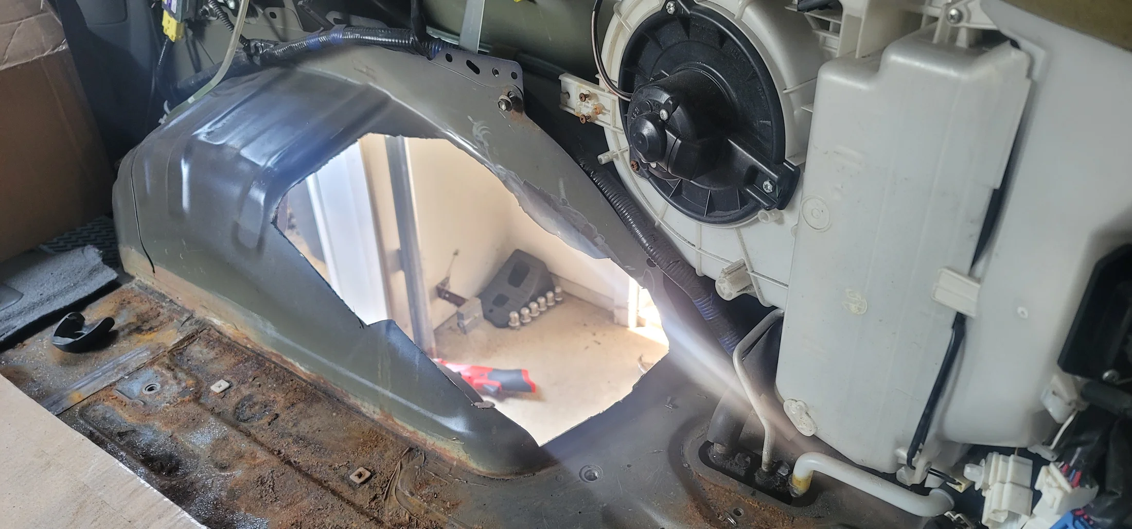

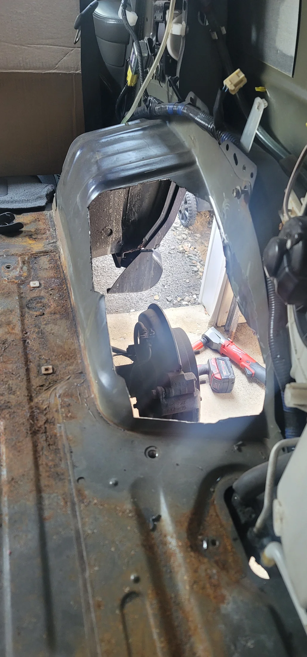

Pretty surprising to say the least, but I knew this was a potential problem before I purchased it. Needless to say I had my work cut out for me. I started the process of grinding out all the rusted areas to clean metal in preparation for new metal to be welded in and some new epoxy primer to seal it all up. You always need to cut away way more metal than you think for a patch repair, and this was no exception.
Guess I didn't take any pics of the driver's side but it was almost as bad as the p/s. I'm amazed at how the frame is in great shape compared to these rear wheel well spots. I'm guessing the PO never addressed or noticed that the rear side trim moldings were leaking water. I will be taking care of that next.

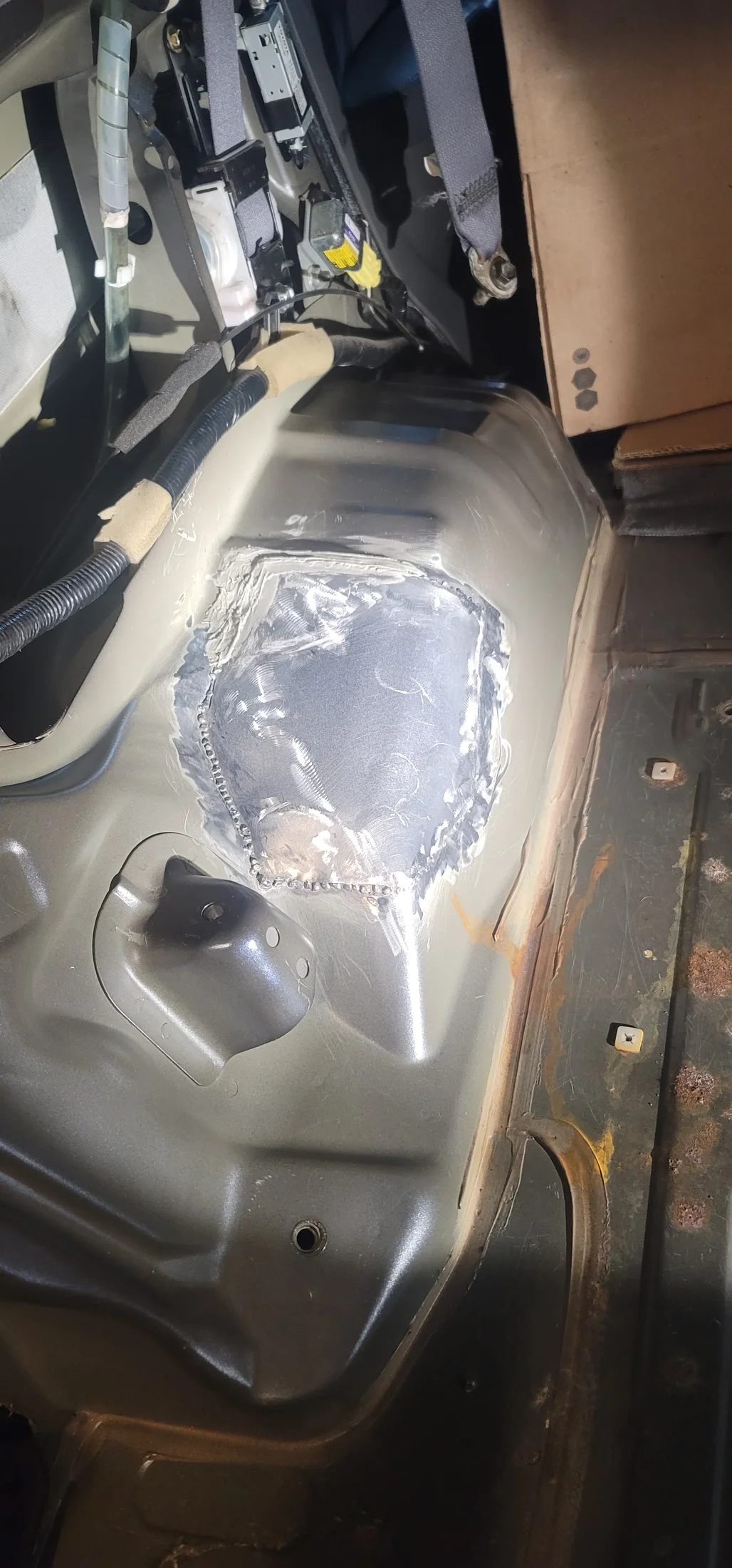

Here's after patching up the driver's side. Not the best job, as the metal is extremely thin back there, but after some seam sealer and paint it'll be good for many years to come.

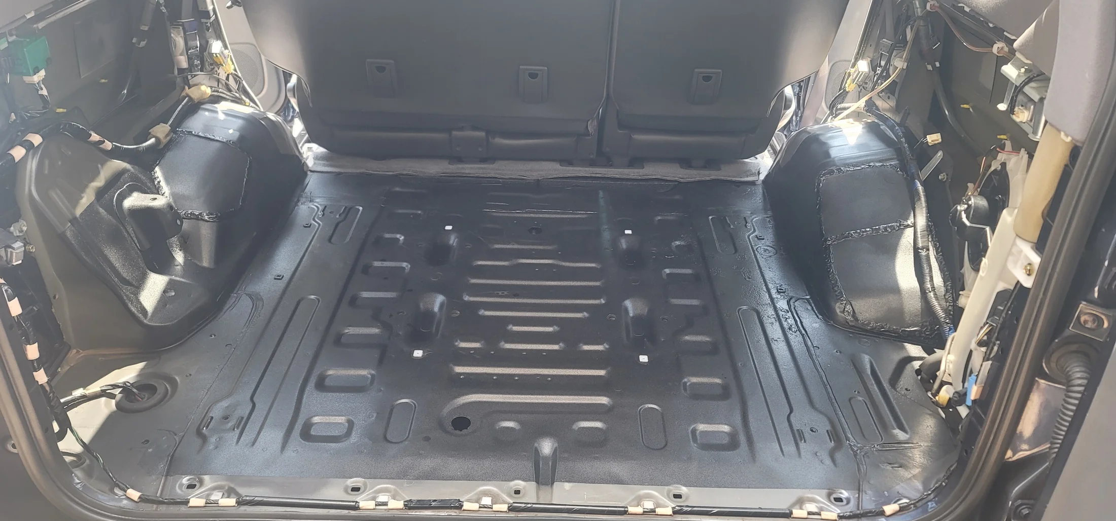

After I welded up both side patches, I put 3 nice thick coats of epoxy primer. I sealed up the butt welds with some automotive seam sealer and finished everything inside off with 2 coats of truck bed liner. I chose truck bed liner for no other reason than I like to look, and I find it to be a very durable, long lasting product. The underside got the same treatment except finished in 3M rubberized coating to match the surrounding material. I hate rubberized coating, and may address this in the future, but for now it'll do.
And here is the finished product:
I'm happy with the results so far and the interior is all back together. I will be addressing the soggy rear carpet soon, as it was covered in a combination of rain water and rust. I plan to cut it all out and replace it with some carpet insulation with a heavy grade spray adhesive.
