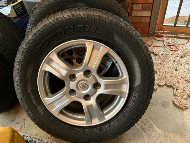

Well.... did a little FB Marketplace searching and found some 2007 Tundra 18" wheels. Came with well worn, but still usable for 5-10k miles, Geolander 275/65/r18 A/T tires. $300 for all four and look pretty clean and straight! Figured at that price, it's definitely worth a go!
Think these might be the same that I saw @LCHardriver_02 is running and curious about how they will fit up. Plan on rattle can graphite color with a little gloss and then to Discount Tire for mounting and TPMS switch on Saturday. At the same time, will probably level by doing the sensor lift up front.
BTW, if DT says the tires are no good, I will probably go up a size and pull the trigger on new ones. But if I can get a little use out of these for now, that would be sweet.

Nice find. These weigh less than 30 lbs i believe. So definitely a good option. I rattle canned my rock warriors and it has held up for the past 18months fine. That was the first time i'd done anything like that.
Great tires too
Great tires too
Yeah, run the Geolanders on my Titan XD and have enjoyed their versatility.
