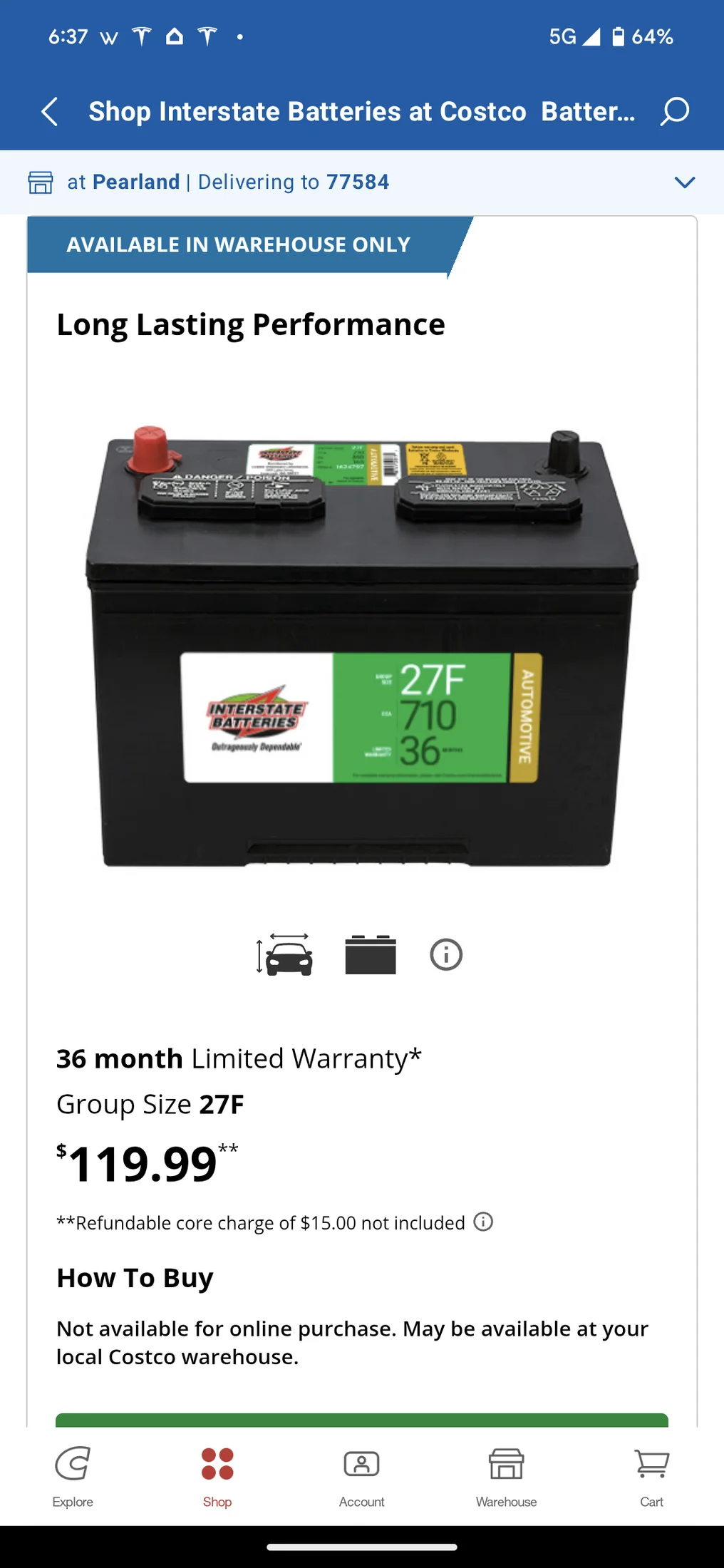

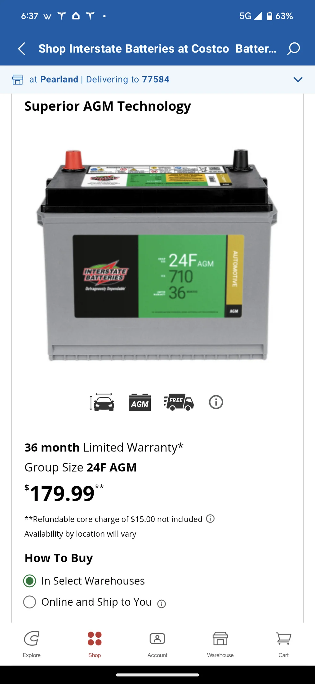

My LC stepping out of the garage one or twice a week except a few long distance travel per year. Currently have a 27 interstate but that looses capacity due to draining down on straight 3-4 weeks sitting.
Planning to get a battery maintainer, recommendations welcome!
Trying to decide AGM or normal for the next battery, any thoughts?? Costco has these options.

From the two options that you listed, you have a 24F AGM, and a 27F SLA, with roughly comparable specs. The additional size, in the SLA, seems to compensate for the difference in architecture of the smaller AGM. The AGM might be more forgiving to complete discharge, but your alternator will never fully charge the AGM, without something like the HKB voltage booster.
